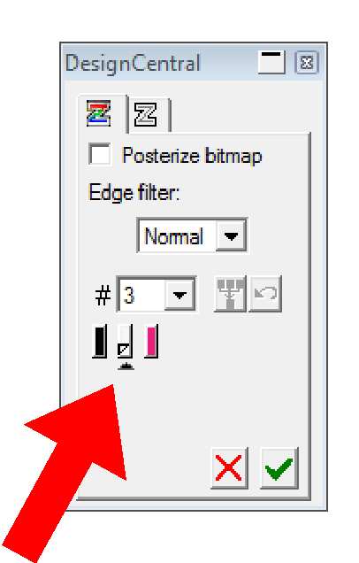

I am using Flexi 10, for the first time ever (been using Gerber Omega since '99). Here is the problem I am running into. When I import a colored .JPG image, then select raster to vector, then select color trace, then I proceed to select the number of colors, etc. Then when I hit the green check to proceed with vectorization, all of my white disappears. Why?!! This is driving me nuts. Then I can not get it back. I don't know why it does this; I want the white to display on the screen. Please help! Thank you :)
Pat Whatley
When you drag your box around the object you're wanting to color trace, BEFORE you hit the green check, look at the little boxes that show what colors it's going to trace. The white color box probably has a little corner folded over which turns it off. Double click on it and it will look solid like the other color boxes.
Then hit the check mark.
