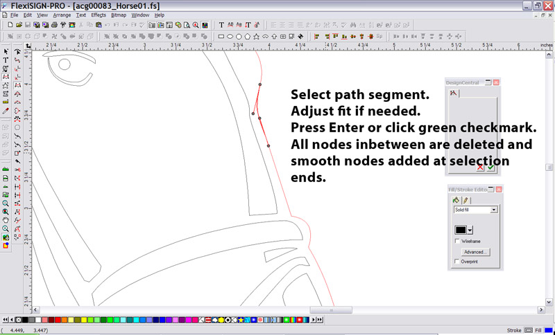

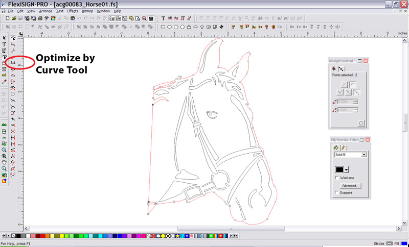

Flexi's path and node editing is a combination of some really nice features and an infuriating lack of utility. It lacks the ability to apply a change, other than delete, to a selected group of nodes. Most annoying is the inability to marquee select a group of nodes on a selected object without also selecting nodes on other currently unselected objects that unfortunately also fall within the marquee.
Disagree with you one this one. The Optimize by Curve tool allows for superb path cleanup in very little time. It alone, without consideration for the rest of the node editing tools, places Flexi at the top of the heap in path editing.
I agree that the Optimize by Curve tool is a gem. So are some of the others. Unfortunately, for the reasons I previously mentioned and a number of others, Flexi's path manipulation tools basically suck when taken as an entire package and compared to other packages. Even the
Optimize by Curve tool drops the ball when trying to simplify compound curves requiring multiple invocations of the tool. . It's extremely difficult to end up without double nodes at the beginning and end of each compound segment.
The problem with Flexi's node editing capabilities is that they provide some dynamite special purpose tools but totally drop the ball trying to tie it up into a coherent usable package. All in all, I'll opt for Corel for general path creation and manipulation. Only if I have a specific need for one of Flexi's unique tools will I use Flexi for diddling paths. Which isn't often.
