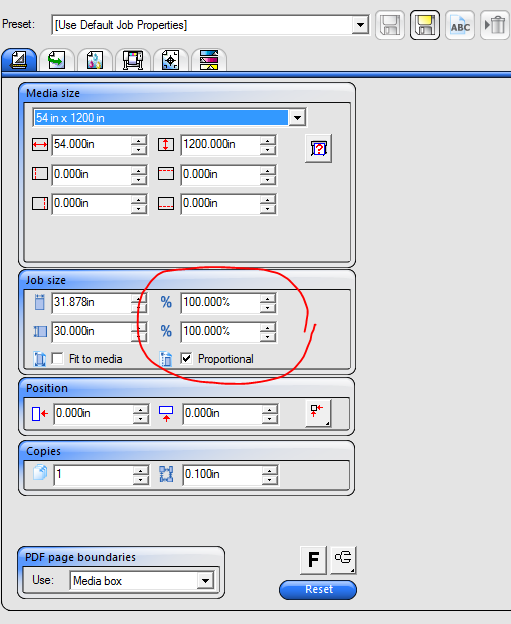

once you add a job, and double click on job to set up profile,
on the main page, there is scaling. do you have "proportional" checked?

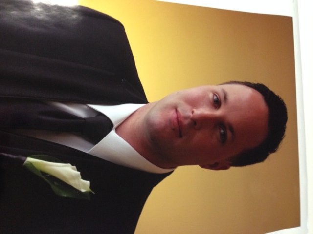

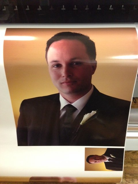

Pic's showing problem
I still can't figure it out.
The large pic is the correct size of 24" x 36" You can see the difference between the both. His head from left side of face to the right edge of ear should be 13½ inches wide. Yet after printing, those dimensions are 9½, but it retained the correct perimeters. The small version was done by enlarging the width and reducing the height, perimeters were effected though. 24" w x 28 h. Anyone have a clue?
