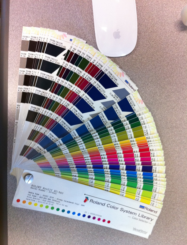

use your printer and make a swatch book. Its compact, easy to carry around, and useful to match customer requests.
ucmj22
ill have to give you the walk through when I get back to the shop. it wasnt too hard. the print file is already built in to versaworks. the most time consuming part was trimming it.
ucmj22
In versaworks go to Media>Color selector>OK
it will then add the required file to your queue
select the file and put the settings to your most common
and load your most common media (quality settings will be locked to retain spot colors)
Print the file and spend an hour and a half trimming and punching holes. Then get a tube screw (I used one that was holding together different colors of komatex samples a supplier gave me) you could probably get one at ACE Hardware, and connect the stack!
