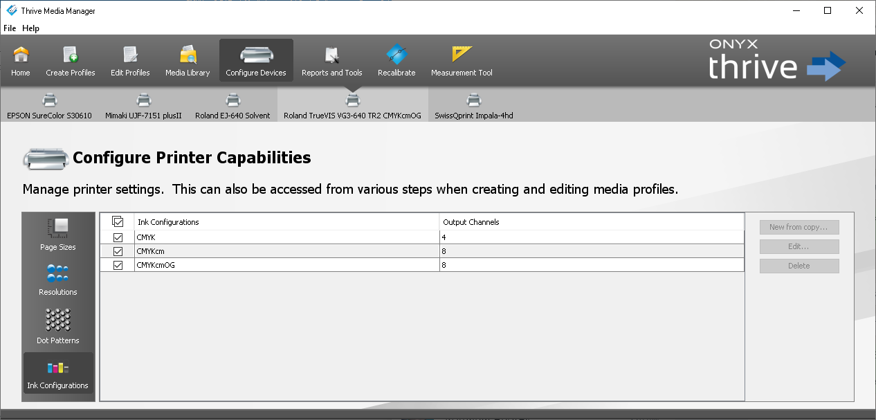

We went from dual CMYK to 8 color with orange and light cyan, I can’t seem to get same color on past print jobs, anyway to have same files print close in color.

in this case TS will have to convert printer back to 4c and then back once again to 8c )))))easy passMuch (or most?) current information for such methods is now behind paywalls and chapters as part of so-called "Learning Platforms." But, alas, maybe study this old post...
https://www.signs101.com/threads/onyx-thrive-and-color-lineraization.120457/post-1208952

True. The link in my earlier post #11 explains how and has been the process for 25 years or more. Wide gamut inkjet printers have simulated smaller gamut printers for a very long time.it should be possible to simulate the setting with a now wider gamut.
