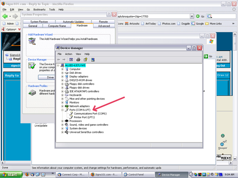

It seems to me that the problem is that you do no have a working hookup between your computer and your plotter. Flexi should work for you as a bridge program to open files you create in Corel and output them to the plotter.
Most plotters connect through serial ports, not through USB or LPT printer ports. Serial ports (COM ports) come in both 9 pin and 25 pin varieties and are male plugs. LPT ports (printer ports) are 25 pin female plugs. If you don't have these ports on your computer, they can be added for $15 or $20. If you have a 25 pin but need a 9 pin, most computer stores sell adapters to accomplish the switchover for a couple of bucks.
You can easily determine what ports are available through your Control Panel > System > Device Manager as shown in the attached image. If you have a COM port, I'd recommend that you use it for your plotter. If you don't, I'd recommend you buy a COM card and add a COM port to your computer.
