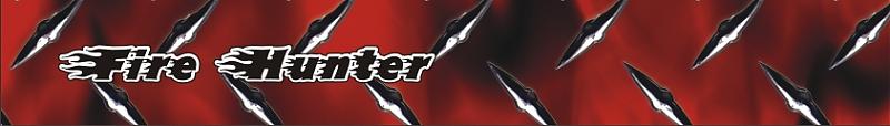

Is there anyone in the Asheville, NC area that I could sit down with and they could help help a newbie out. Or information on a good workflow for print resolution from PS, IL to a versa camm SP300V.
1. making a 1X7" decal what res and setting to use for PS
2. what do you save it out as (eps, tiff, jpeg?)
3. Best way to bring it into IL or Corel to add text
4. what setting to save it as for the SP300 to get a good print from Il and Corel.
Here is what I need to know the steps for to get a high quality print. I am making 1" x 7" decals I am needing to put diamond plate, carbon fiber, or flag fills and others, you get the idea. then add flames to some and text to some and so on. (see atached) then take it from PS to Il (or should I just stay in PS?)
Thanks guys I know this should be cut and dry but my images coming out of PS do not look the best.
Allen

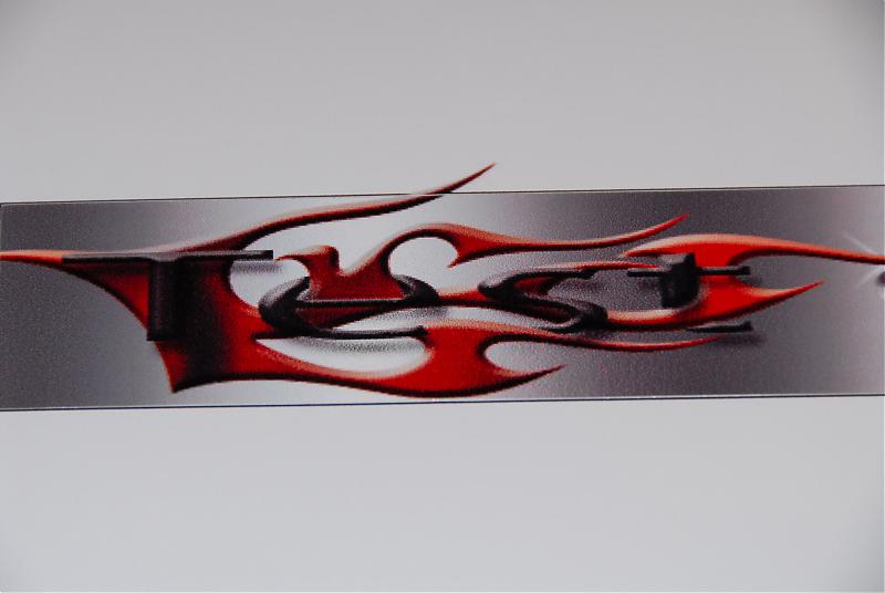

what do the prints look like?
can you post pics?usually for larger prints you can go lower resolution.but for little things like this you should keep the res high so you can see the detail in the graphics.if you're experiencing "dark prints".you probably need some icc profiles,color calibration,etc.its a big learnig curve ahead so buckle down and get ready.as i too am still new to all this and it is definately alot tougher than i anticipated.
