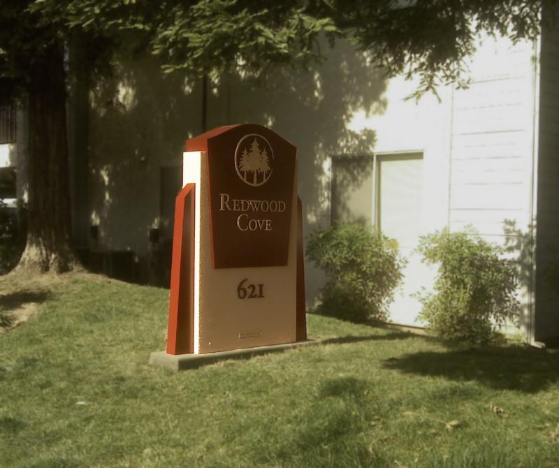

Just finished installing this - all aluminum construction with a combo of stucco and paint finish, with dimensional PVC logo/lettering
Nice job, I like it!
Care to give a little more details of how you built it?
What aluminum, how did you apply the stucco, over what sudstrate, etc?
Do you have a construction drawing?
:thankyou:
J Hill Designs
built the box (beige part) with 1"x1" sq tube and 1/8" sheet alum, built the end wings and top as slide-on pieces out of only 1/8" sheet alum routed and welded.
masked off box where other pieces went and sprayed on Omega acrylic finish (faux stucco) - then using clips slid the pieces on.

6' tall, 5' wide
