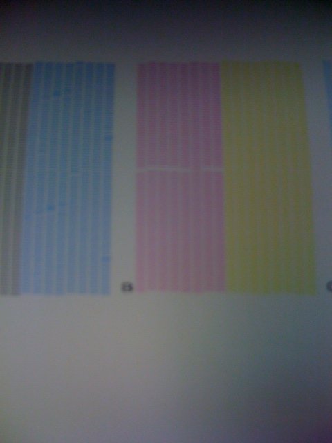

Can find ink in damper, pump and the tube between this parts to printer head?
Ensure these is no air leak in the ink system, and then suck ink from the tube connect head (take the tube out from head).
If the ink can through tube, it will ok.
