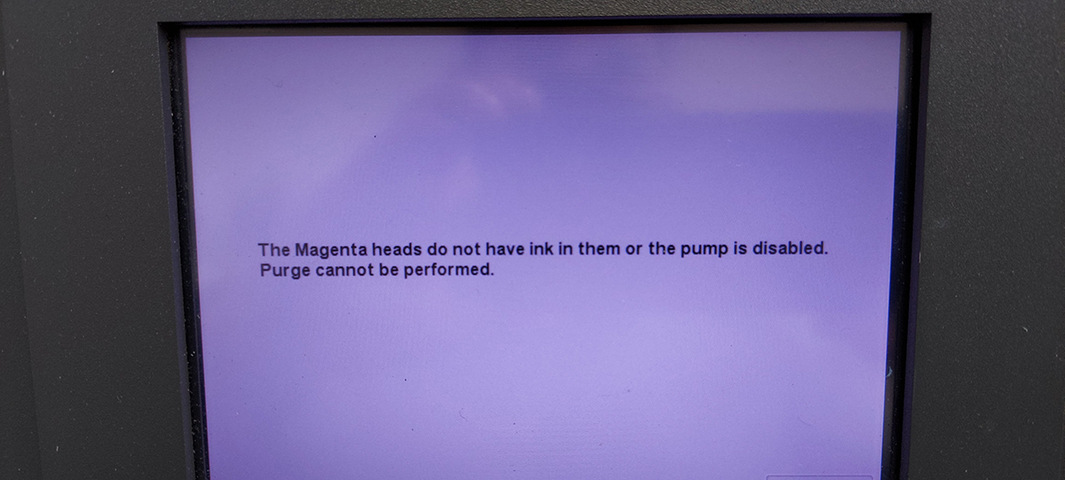

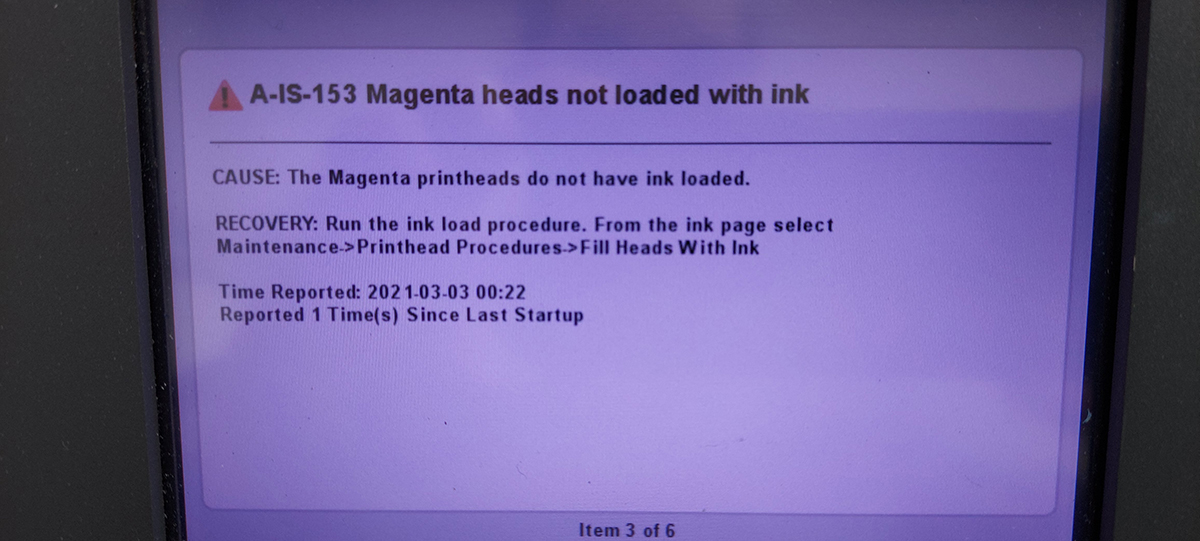

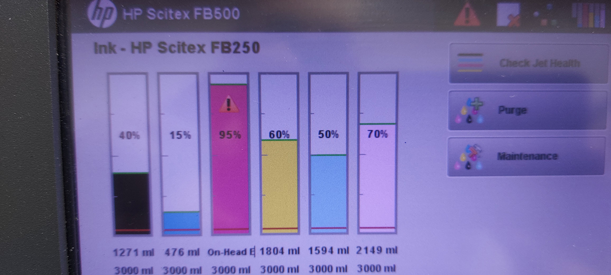

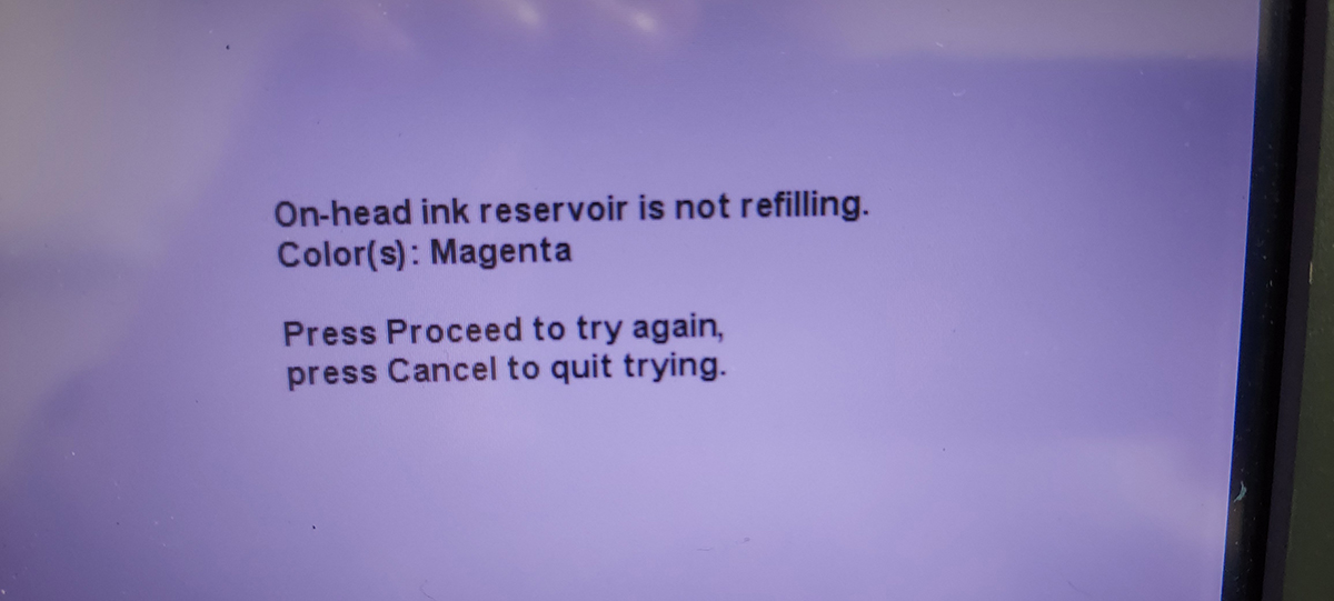

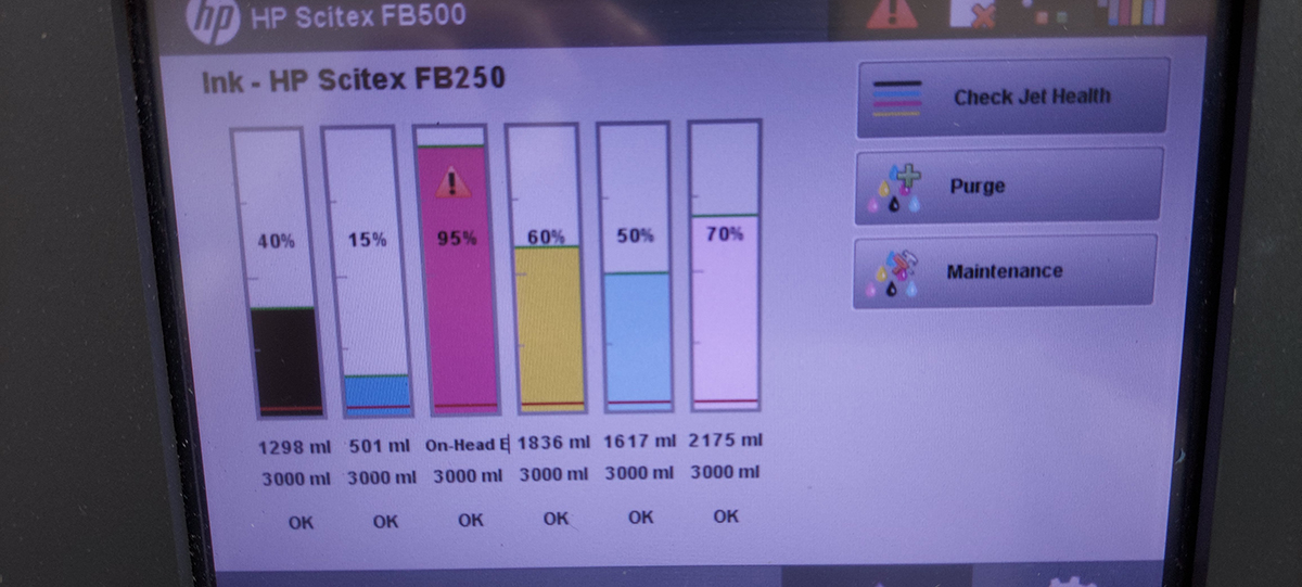

Ok guys just replace the ink on the HP Scitex FB500 but now its giving me error with the new magenta ink.
PMsQXyG
Boudica
might not be hooked up right, or you might have a bad chip?
I just tried to install a new box of magenta, and it had no chip! grrrr.

ok here are the pics

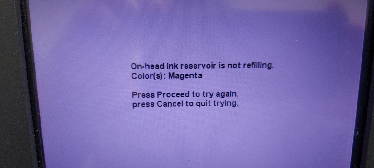

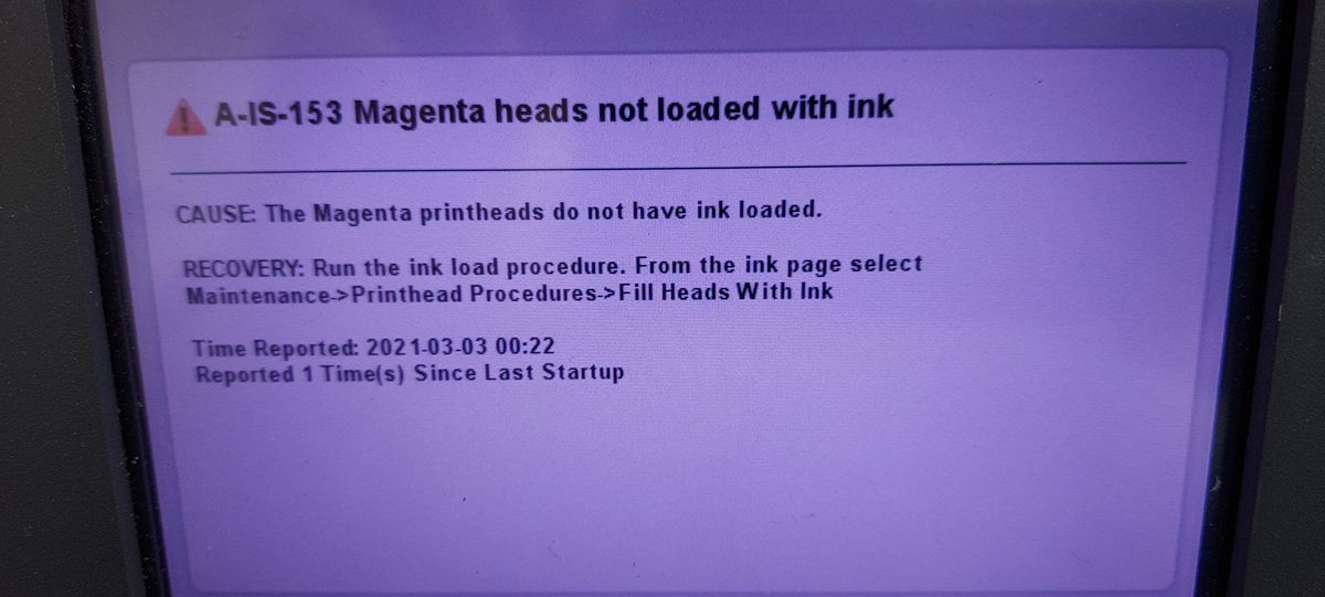

this is another message it gives me when tryin to fill heads with ink
Boudica
uh oh, you might have a clog in the system. sorry, this is out of my realm. Your going to need a tech, unless you can get in there your self.
ikarasu
check the line from your box to your printer and see if theres a kink... We had this happen once when the operator twisted the plastic line and it kinked and caused a vacuum so no ink could be sucked up. We just de-kinked it the best we could and it seemed to fix itself

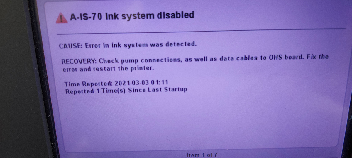

there are no kinks in line, it wont let me do a purge, says pump has been disabled.
Sounds weird but did you a total restart of the machine ? Seperate it from power, wait 10 minutes, reconnect.
Which error number / action do you have ?

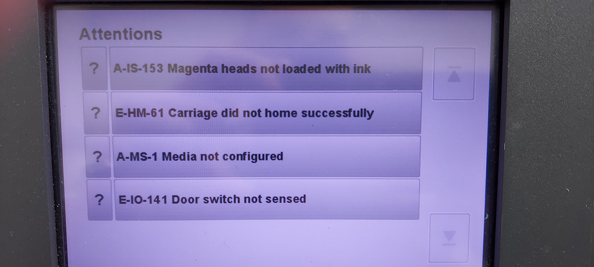

ssfirme

The magenta heads are empty mhh...did you try to:
0) clean the magenta colour chip and check if its damaged
1) clean magenta head with the air purge
2) clean the heads manually with lint free wipes and printhead flush (or IPA)
3) go to the color menu and "empty the magenta head" and after that "fill the magenta head again" (if necessary repeat the process)
4) restart the scitex (you have to unplug the main plug; under the belt )and error should be gone
5) air purge all heads again
6) print a test pattern
The Door switched not connected isn't a problem; if the connector is plugged out you can reset it.
The Error "Carriage did not move home.." is a problem...did you tried to configure your printer ? Maybe you have to calibrate..there are test for this in the service-menu.
Hope i can help!
