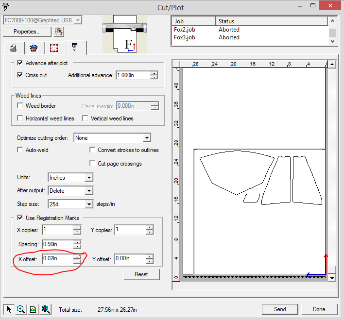

Quick question...our graphtec fc-8000 is cutting a little to the right of exact on contour cuts...which option allows me to move it back to center?
I know its an offset adjustment somewhere.

In your cutting master, on the last tab, there are values for x and y offset.
do a few test prints and test cuts. i had to adjust one of them to 0.02 and it's perfect every time now.
also note,
IF you change the width of the media for other jobs to somthing ssmaller, and next time you're contour cutting, it will tell you "contour cutting is not supported for multi page design."
change the width of the material to what you are using. then cancel out and try again. else, your offset value gets overridden.
