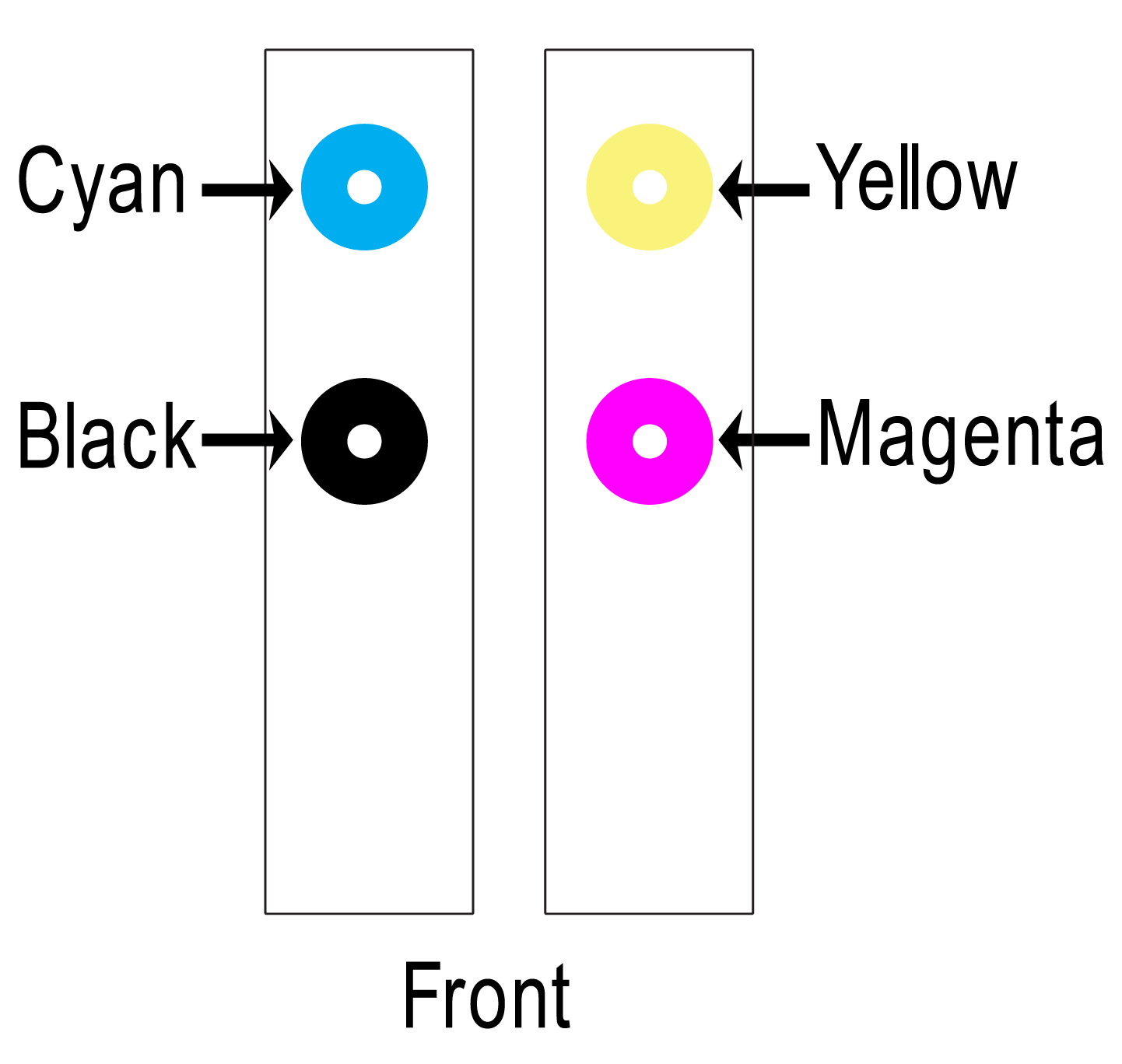

It does print black,cyan,magenta and yellow from left to right. Cyan comes out very light almost invisible. My lines are connected as shown in the sketch. The cap tops are new. I heard about cross contamination somewhere, but on explanation as to what it is and how to solve it. Just the two words only someone mentioned. Thank you for your response.

You could try syringing the black/cyan print head .Just ensure the heads are capped and remove the output tube for the cyan/black cap at the y junction and attach a syringe and gently pull through about 20 mils of ink ,you can watch the ink lines into the dampers to check for bubbles etc and listen carefully to the cap there should be no sucking sound. See how that goes
anwarshah
I did just that also at the damper side on the cyan ink line. There wasn't much ink there until I sucked some. I still had the same problem. After checking the new cyan damper, it looked suspicious and barely had any cyan ink in it, so I replaced it again and sucked the ink line. This time it worked. So bad new damper perhaps? I have a cousin in NZ, nice green land and scenery. Summer is here :), you are waiting for winter :(.
