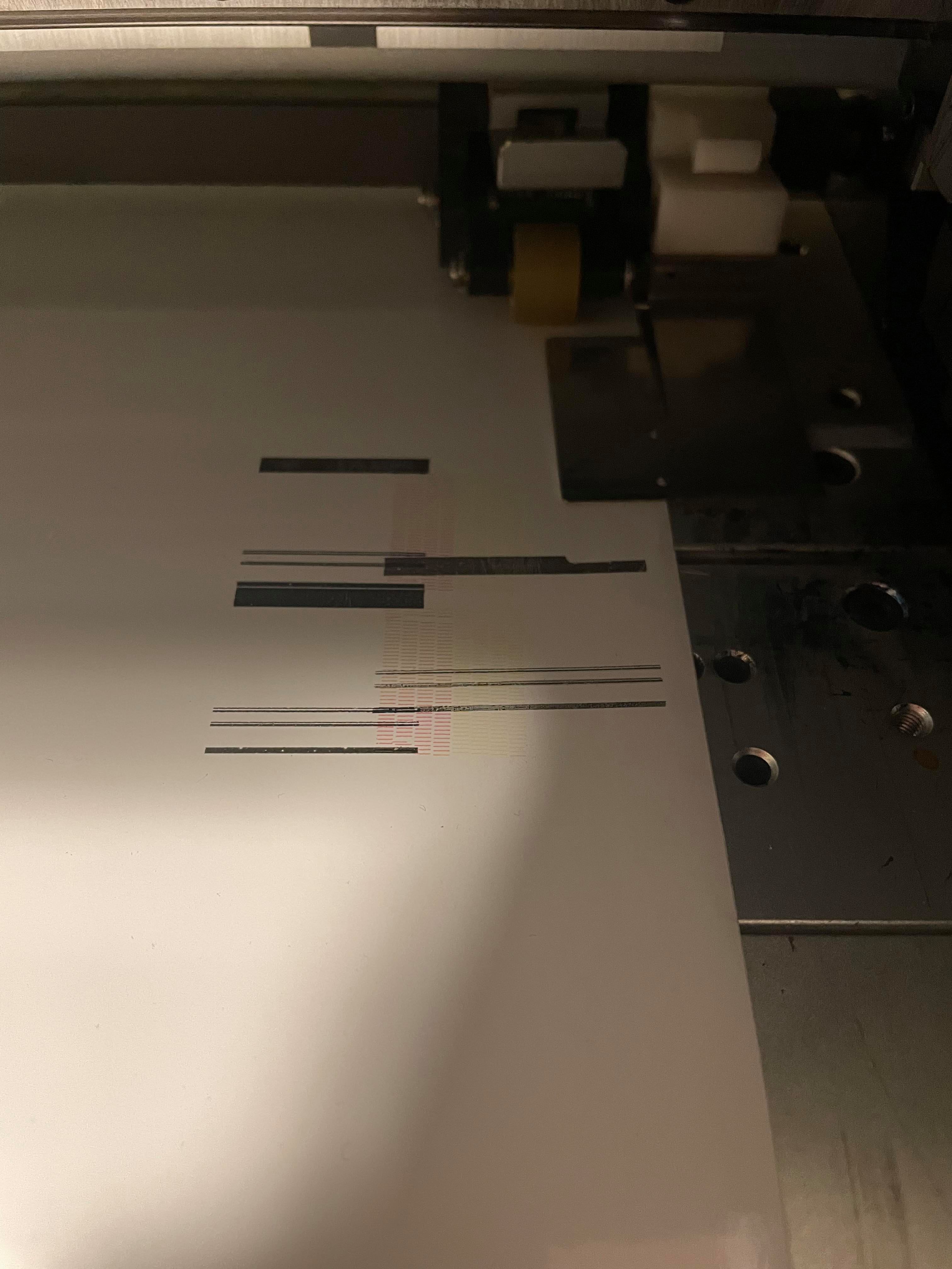

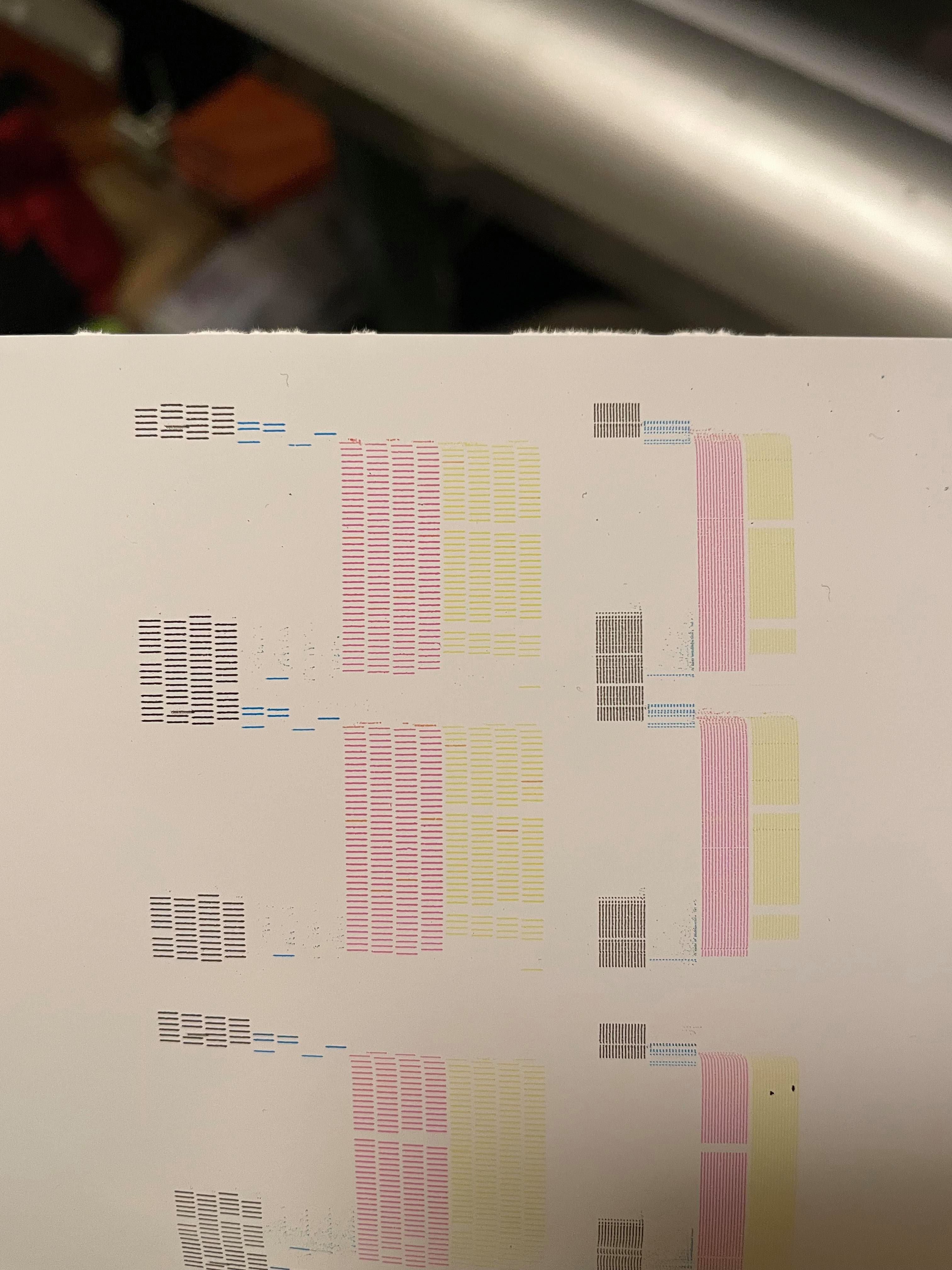

did a test print and got interesting results the blig black bars are happening when i have the dampers swapped, i can see that i need a head clean currently as black isnt fully firing.

The black bars do indicate an electrical issue. Make sure you unplug the machine and let it discharge for about 15 minutes before removing cables etc. Make sure your head cables are plugged in perfectly straight and check for damage/ink splatter on the silver leads. Anything that can create a short you want to clean or replace.
Also, it looks like the cap tops may not be working properly. You've got a lot of cross contamination in the magenta yellow head which usually means the cap top is not draining properly. It could be a clogged waste tube as well. The black bars are probably due to a cable that got knocked loose or maybe some ink splatter. Hopefully the cyan is just not printing because the cap top isn't pulling properly.

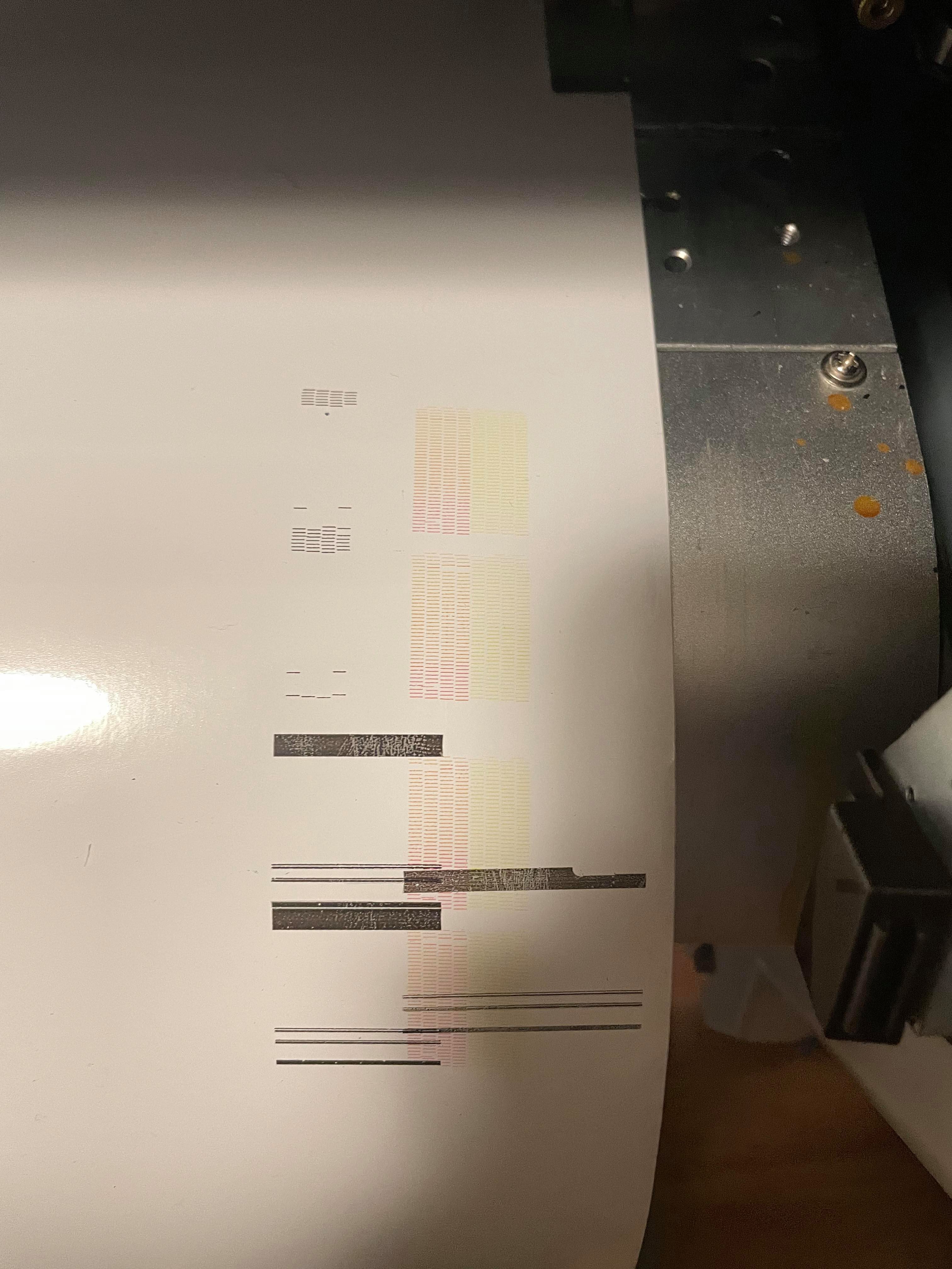

its progress, now that ive confirmed ink flowing i have two options. do a drain and fill, with cleaning solution to further recover the head, or the one im currently doing which is printing a 6" long 28" wide strip of 100% bk and then a 6" x 28" 100%cy block
