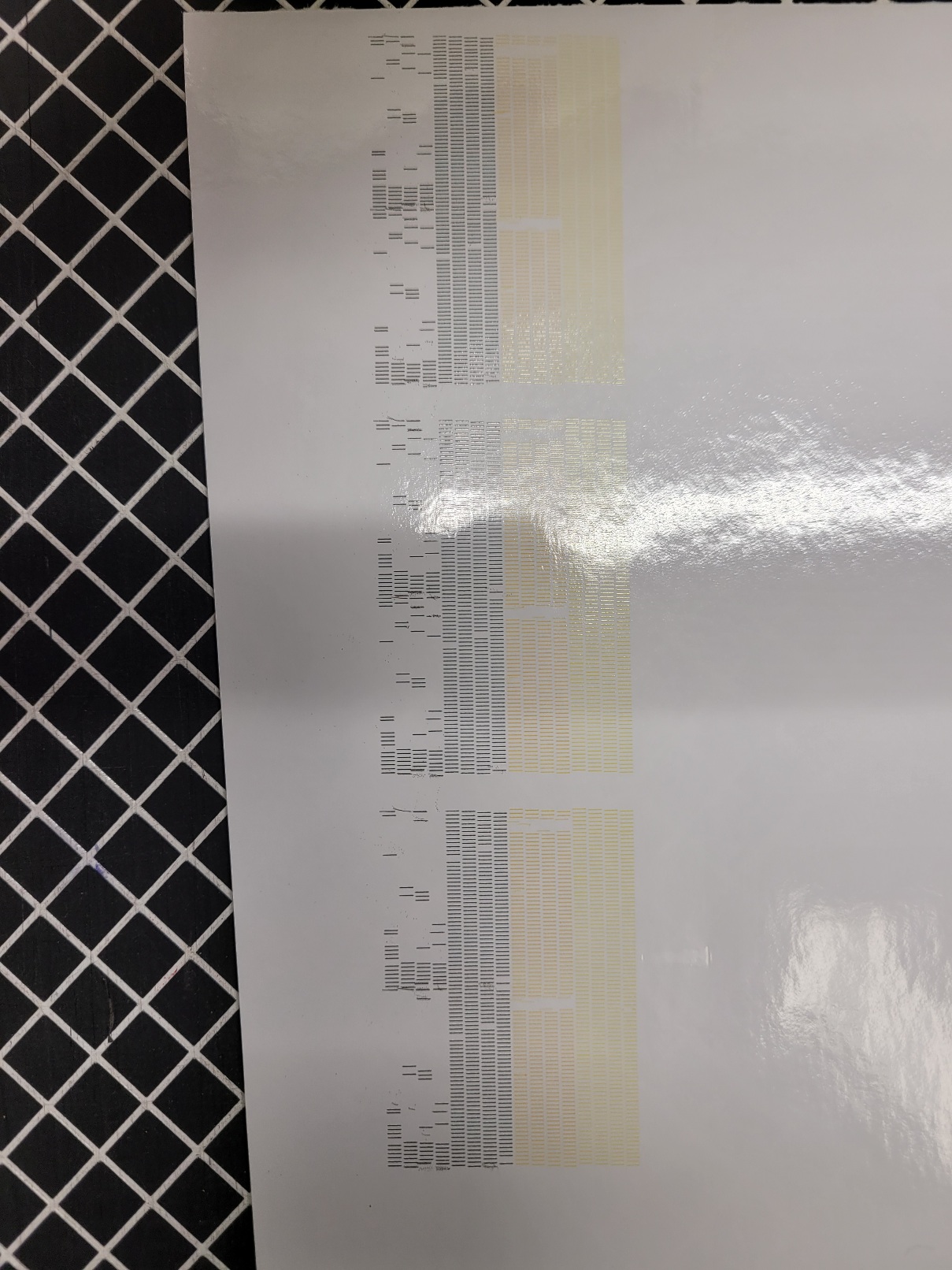

I'm confused by this test print. I lost black ink during a print. Did a head soak now this? What the heck is happening?
I swapped the Y/M with the B/C to see if it was a data issue. Looks like I'm buying a print head....

Could be cross contamination through capping or damaged sealing inside printhead.
Is ink also mixed in dampener?
Check if capping pump is working.

I ordered a new pump, dampeners and cap tops and print head. My thing is why is the magenta orange?
The pump has sounded bad lately. Like after a long day it sounds tired when it runs if that makes sense

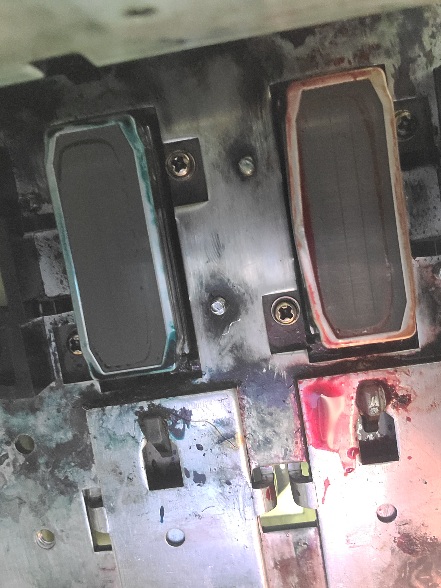

Found a clog at the Y connector and in the drain line. Cleared both. Replaced the B&C dampers. Still having an issue. I noticed my captops are not seating correctly on the heads causing what I am assuming is a leak. I can draw and get good suction out of the cap tops with a syringe. But when it comes to test prints and cleanings I lose all ink in both heads. Only when I prime the heads do I get any ink in a test print at all. How do I adjust the capping station carriage to the right? I also noticed the two white thumb screws on the head carriage were loose.
(the damage to the M/Y head has been there since I bought the machine. I do have a spare head I can use) pulling my hair out at this one. About to toss the machine.
UserTK-421
From the looks of that, you should absolutely perform a Flushing Position Adjustment and get those print heads better aligned with the cap tops, you can see the outlines of where they normally sit and it is indeed off by a fair amount.
Wonderful. I will try that tonight. I hope this thread helps others in the future. So here is a link to a manual I found on the procedure. I just hope it's the same for mine since I have 2 heads and 2 cap tops.
