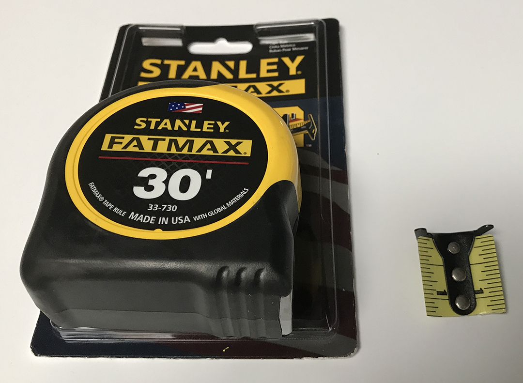

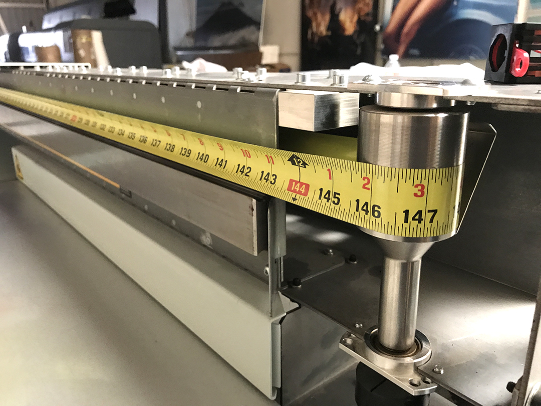

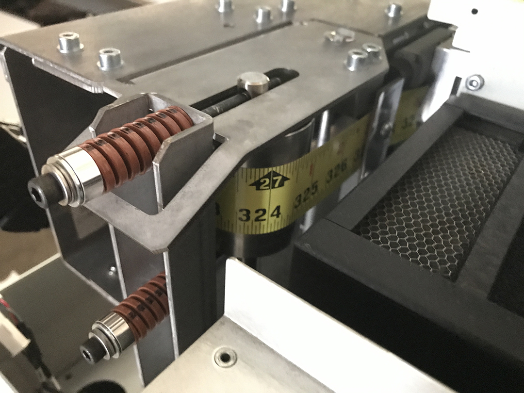

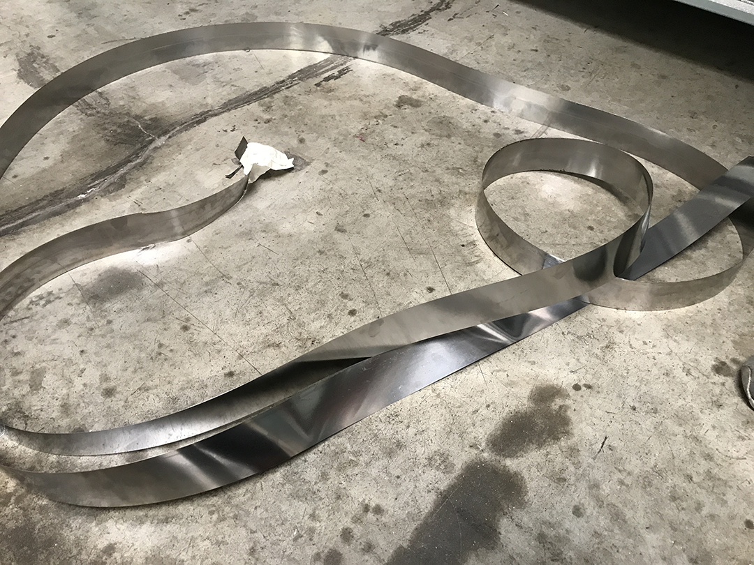

We put too much grease to our printer belt and damage while printing. The parts from DigiPrint ship over one weeks. Our engineering friend - CMYK ENGINEERING - Kirill help us to do this so we print our project.
Part require:
30" steel ruler from Home Depot
CMYK Engineering - Master Tech Kirill

fuck. impressed too. I'm keeping these photos to show the techs. they'll get a good laugh from it.

Why you put a grease on the belt? It won't help, the belt moves on two rolls, which has bearings, so the grease won't do anything.

If you replace the belt with the Stanley tape, it's not needed, you just connect both ends of the tape to the carriage (there are screws there).
