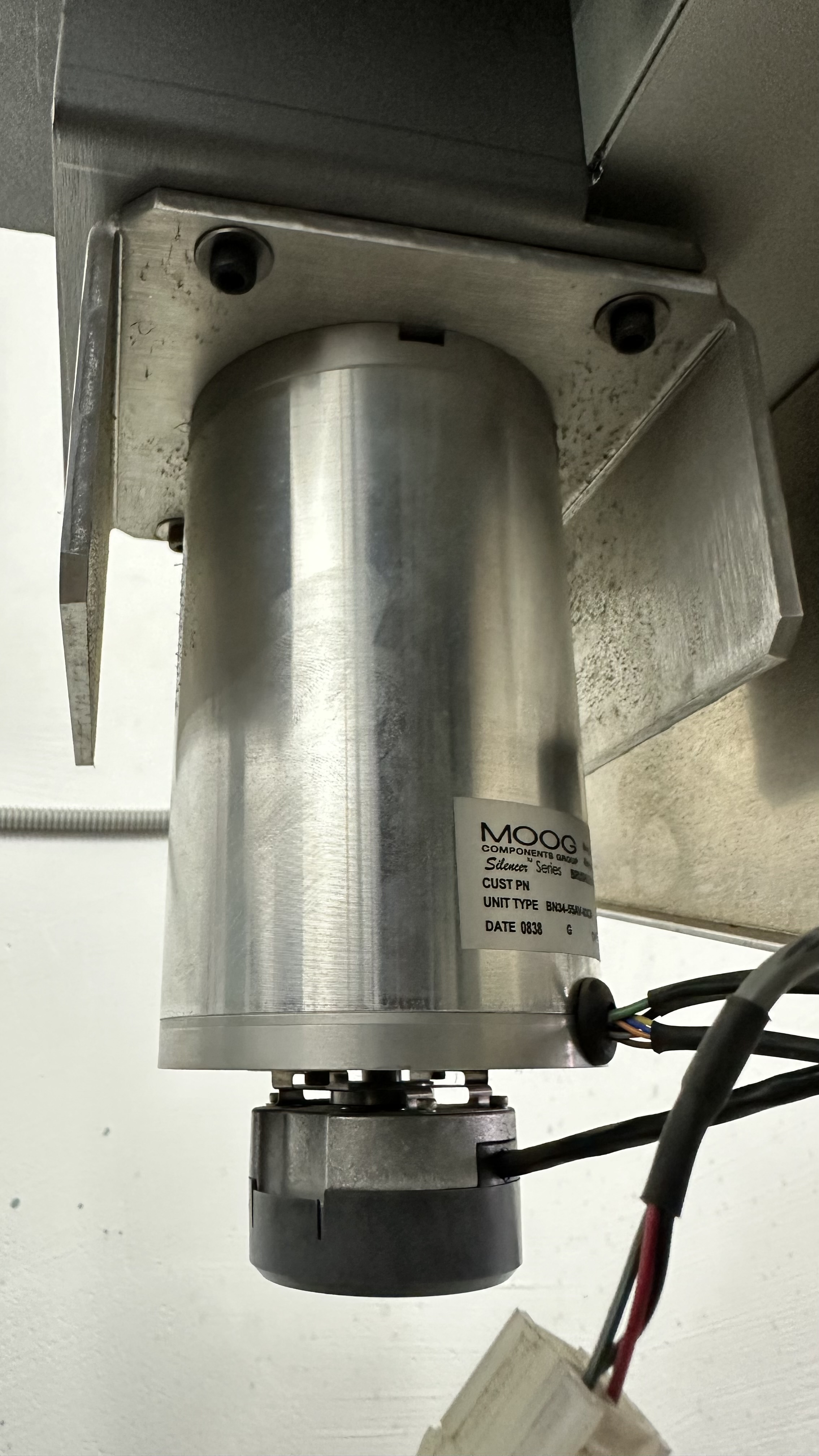

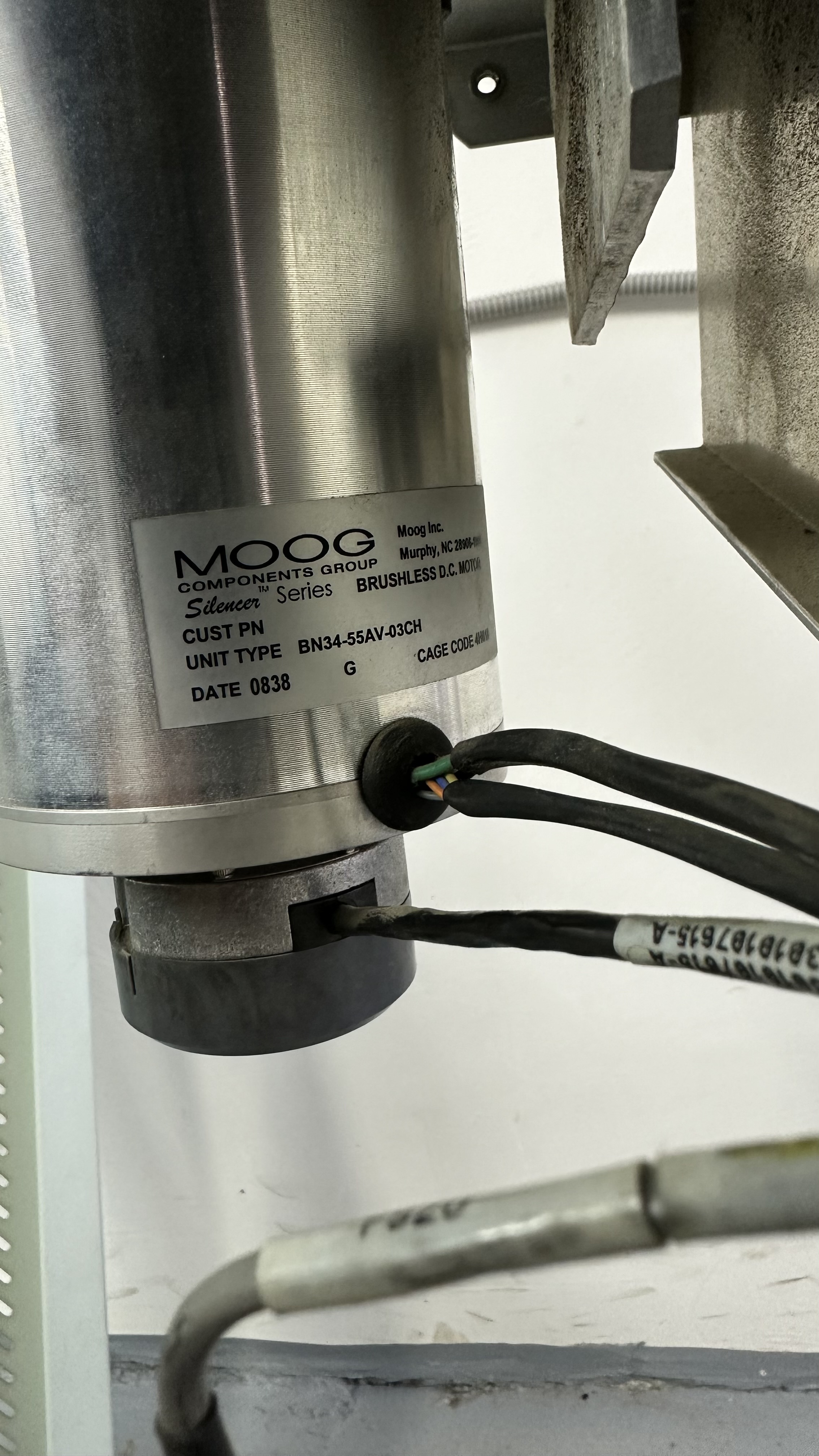

I have an old HDD with a known working OS. I plugged it in and the problem still persists.
There is a very unusual fact...
It turns out that the printer can work on a roll !
But when returning to the parking lot it also hits the limiter ....
I observe that the speeds and accelerations of the carriage acceleration/deceleration when working on flatbet and when working on roll are different!
The printer is always slower and smoother on the roll. It's always been that way.
But the acceleration and speed of the carriage leaving after finishing printing on roll is as sharp as on flatbet!
Hence, I have the impression that the problem is overcurrent overload when the carriage brakes.
I want to note that I have a version of the printer with a brushless carriage motor!
It turns out that there are versions of the printer with brushes.

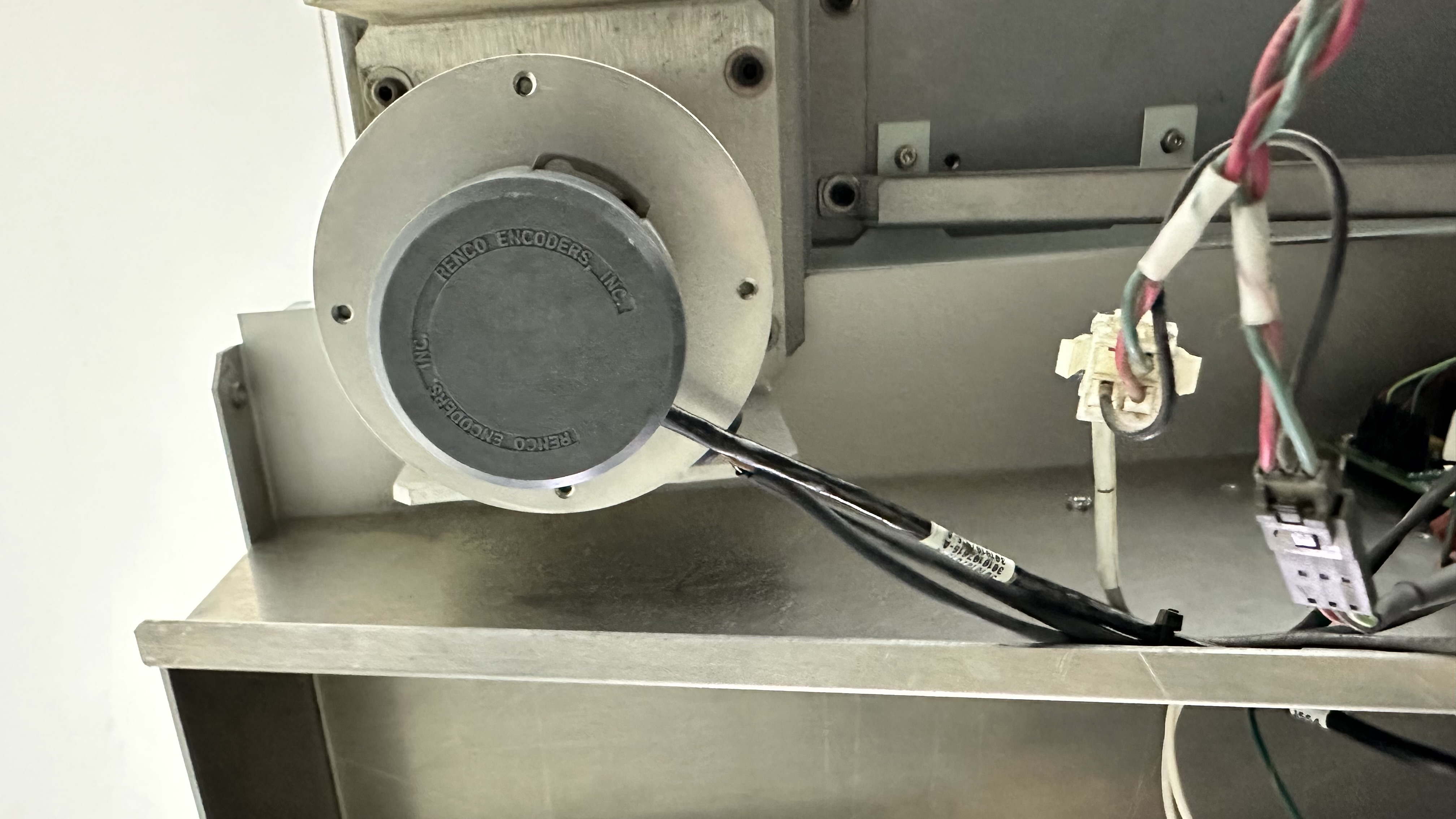

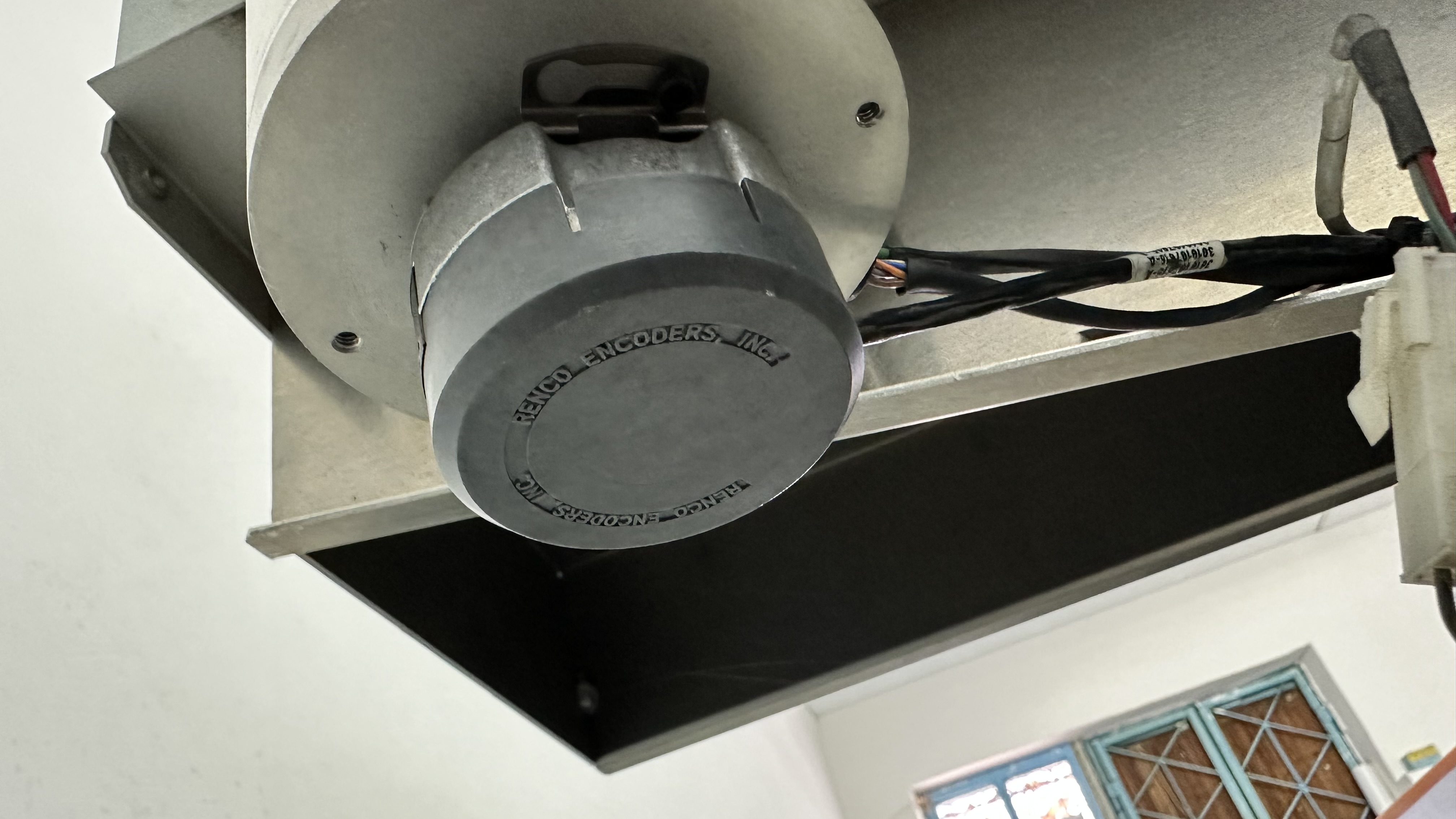

Can you check something? In the end of the encoder strip you must have small magnet with size like dark gray matchstick.
This magnet must work with Hall sensor in encoder reader like end stop switch. Check please! Do you have it?
Try to find how to check this stop switch from SDS/Carriage. I think that there is test.
Next step is to change the encoder reader from Gantry with encoder reader from Carriage.
Try to find what is the color of this encoder reader. Must be green in all path of the carriage.
There is an option that the reader work like reader but the Hall sensor in it doesn't work correctly.
Do you have encoder on motor? Like in 660. Take picture please. I can check and take photos in Tuesday. This is first working day here.
I've seen this error once, but it was logged before the problem was even discovered. All the time since then, error 9 has been recorded.
