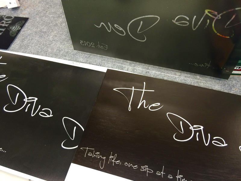

When we we're still talking about replacement of the flatbed with Roland they sent us a sample of one of our files which used Roland color BK-21A which is just K. I printed the exact same thing on ours with the same settings. In the attached picture, the left and top are theirs and the right is mine. Ignoring the horrendous defects in my print, it's pretty clear theirs are green and mine is brown. The difference is much worse in person.
I'll admit that I've always considered the Roland colors that come with Versaworks to be such a cheesy, terrible workaround that I've never advised a client to use them and have never worked with them myself at all. In fact several years ago I wrote a Pantone C Versaworks spot color library that I'd install for clients just so they didn't have to use the Roland colors.
And now, of course, in fairness to Roland and to their credit, they finally ponied up and paid the licensing for the actual full Pantone Library.
So I did have to go look to see, and sure enough, their colors are described as CMYK values and not as L*a*b*.
I guess given the nature of how that library was supposed to work, that would be okay, in that every color was supposed to be unique to its printed condition. But as anything trying to be in any way consistent, that would be a disaster.
However, as far as your samples go, I can assure you that the file you sent to Oce did not get printed as black only. From the looks of it, I'd say the one you printed didn't either, but from the way those colors are defined, I can't 100% be sure without seeing it in person.
(I am kind of curious though. If you want to send it to me, I'll let you know for sure. On the house.)
I've also not worked with nearly as many Roland flatbeds as solvents, so I can't speak as confidently about the consistency of their black ink; still I'd be willing to be that the issue you've got there is a profile issue, and not an ink issue.
Brian27
Those samples were actually printed by Roland. Sorry for the confusion. In December we were working with Roland to replace our Flatbed because it is a disaster of epic proportions. They were all set to send a replacement for the entire thing but then decided that my problems weren't just isolated to my printer and they duplicated those problems on theirs. So, they sent me those samples to essentially prove how crappy their demo prints as well. I just posted those to show how two machines printing the same file with the same settings and the same ink produced different hues of black...for whatever reason.
The Roland spot BK21-A is set to 0,0,0,100 in Versaworks so if it's not printing full K then I don't know how you ever could.
Okay, gotcha.
A couple things I can say though:
I really am curious about those prints from Roland, and just how Versaworks handles those Roland Spot colors. If they truly are just passed through Versa to the printer as raw CMYK values, then they're even lamer than I ever thought. But if it is the case that that's what they do, then that ink shift you showed is an amazing lack of quality control on the part of whoever makes their ink. Far worse than anything I have ever seen.
And since it's a pretty good bet that their ink is made by someone else and not them, I'd find that almost too much to believe. So my hunch would be that something else is going on.
I can say though that I've profiled many, many Oces over the years, and never seen any ink quality control issues with them. And they've got a good, deep black.
Note though that even then "black" is not a constant. "Black" will vary with resolution, and with media type. Typically the glossier the media, the better the black point, but even on the same machine, from media to media, no primary values are absolutes.
However, I just cannot over-emphasize that in printing greys, relying on black is a work-around for bad profiles, and creates its own problems. If you want to print good greys, you need excellent profiles. Profiles made in your environment on your machine. Everything else you see or read or hear is just a work-around for substandard profiles.
