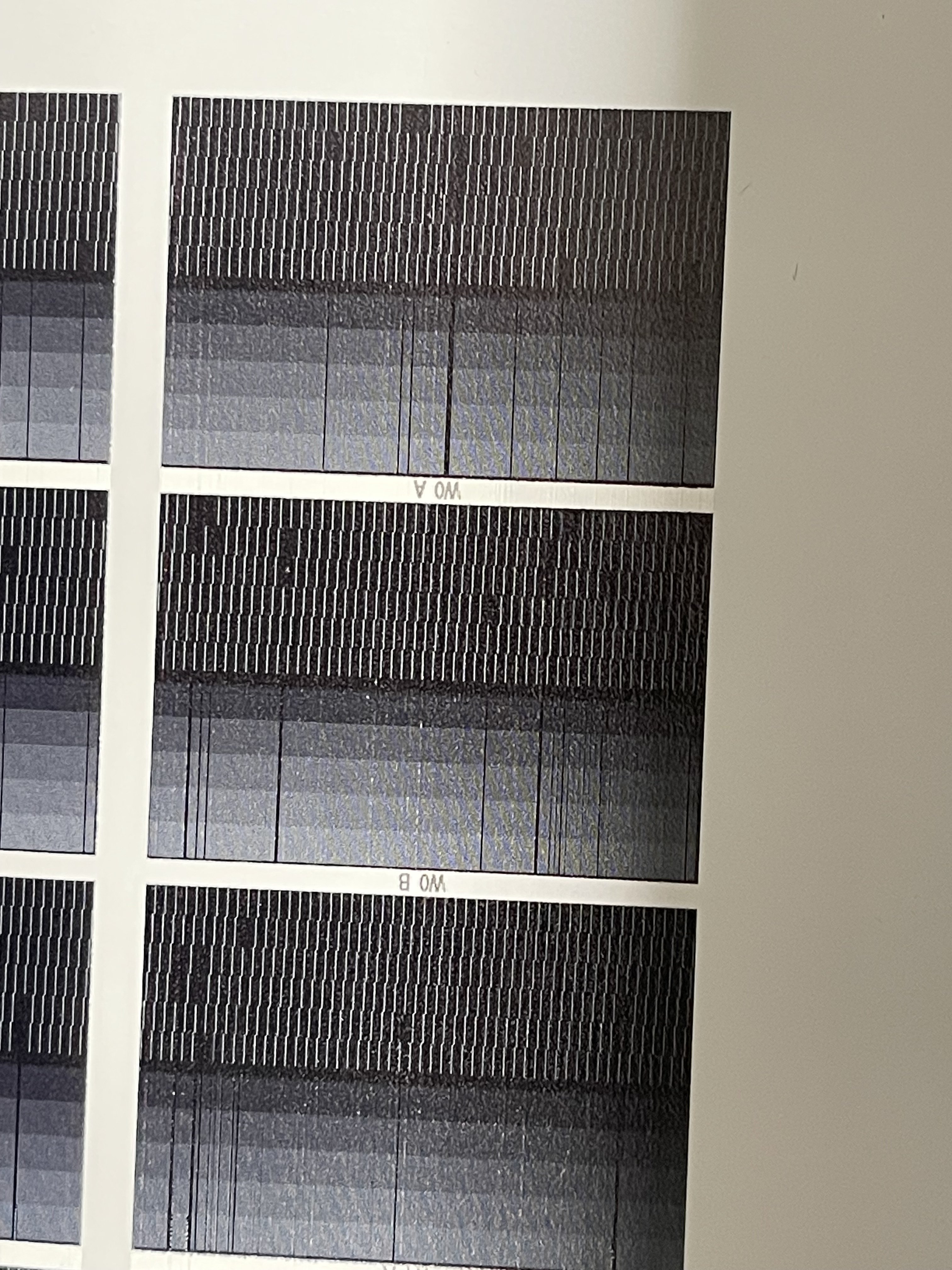

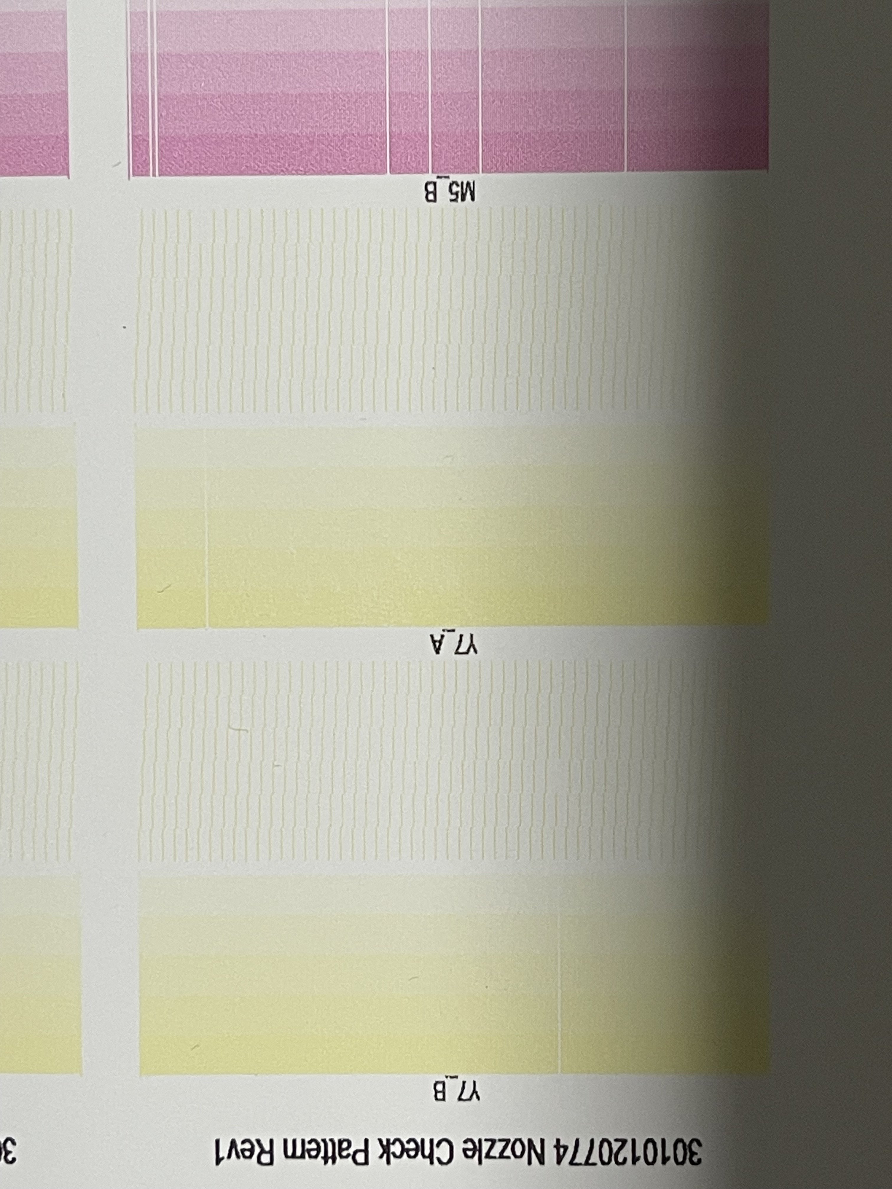

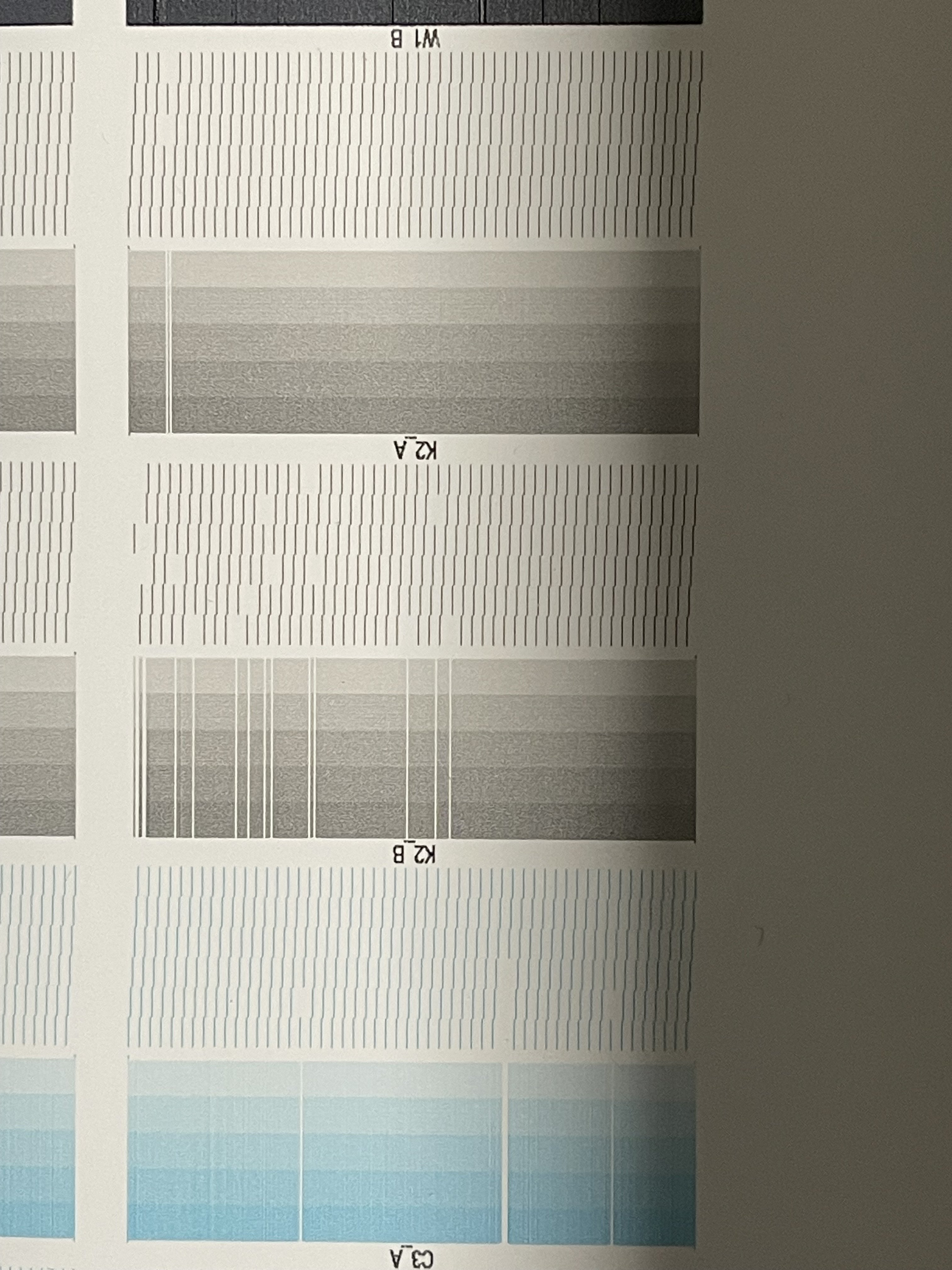

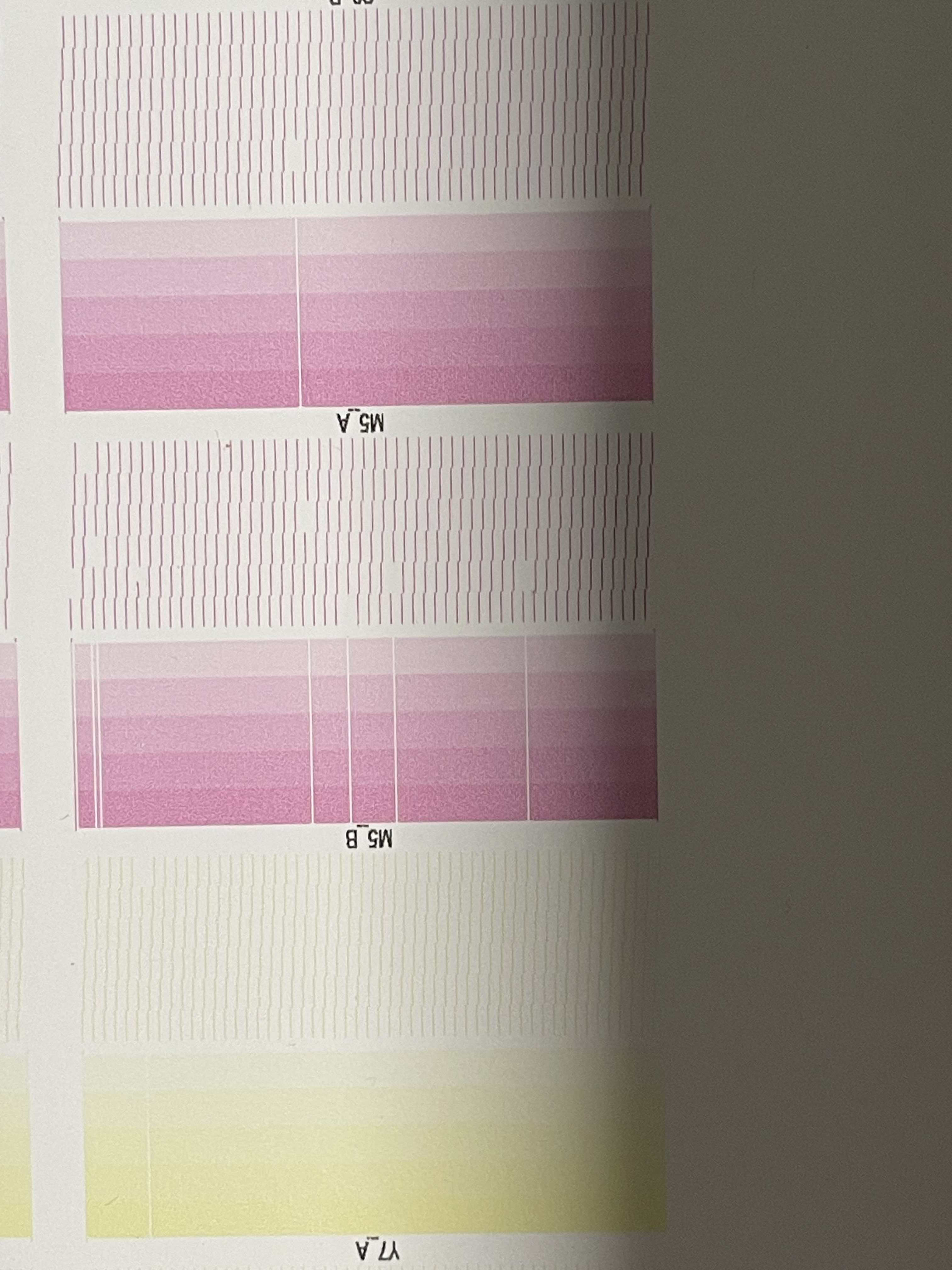

Hello members, just picked up this new to us oce 1260GT the nozzle test is attached what do you guys think? Change them all? any other way I can improve on this?
Cheers

Wouldn't all new printheads cost more than the machine itself? These printheads are soo expensive that I'd be trying everything possible to recover nozzles before replacing printheads! You're going to need to buy consumable parts at some point anyway, so why not replace your pumps and filters now, especially if you don't know the maintenance details of the machine? Worst case, nothing improves but at least you have spare parts so nothing is lost.
chinaski
Did you see a nozzle status photo or see it in person before you purchased it? If the missing nozzles change, that is a good sign they are recoverable.
