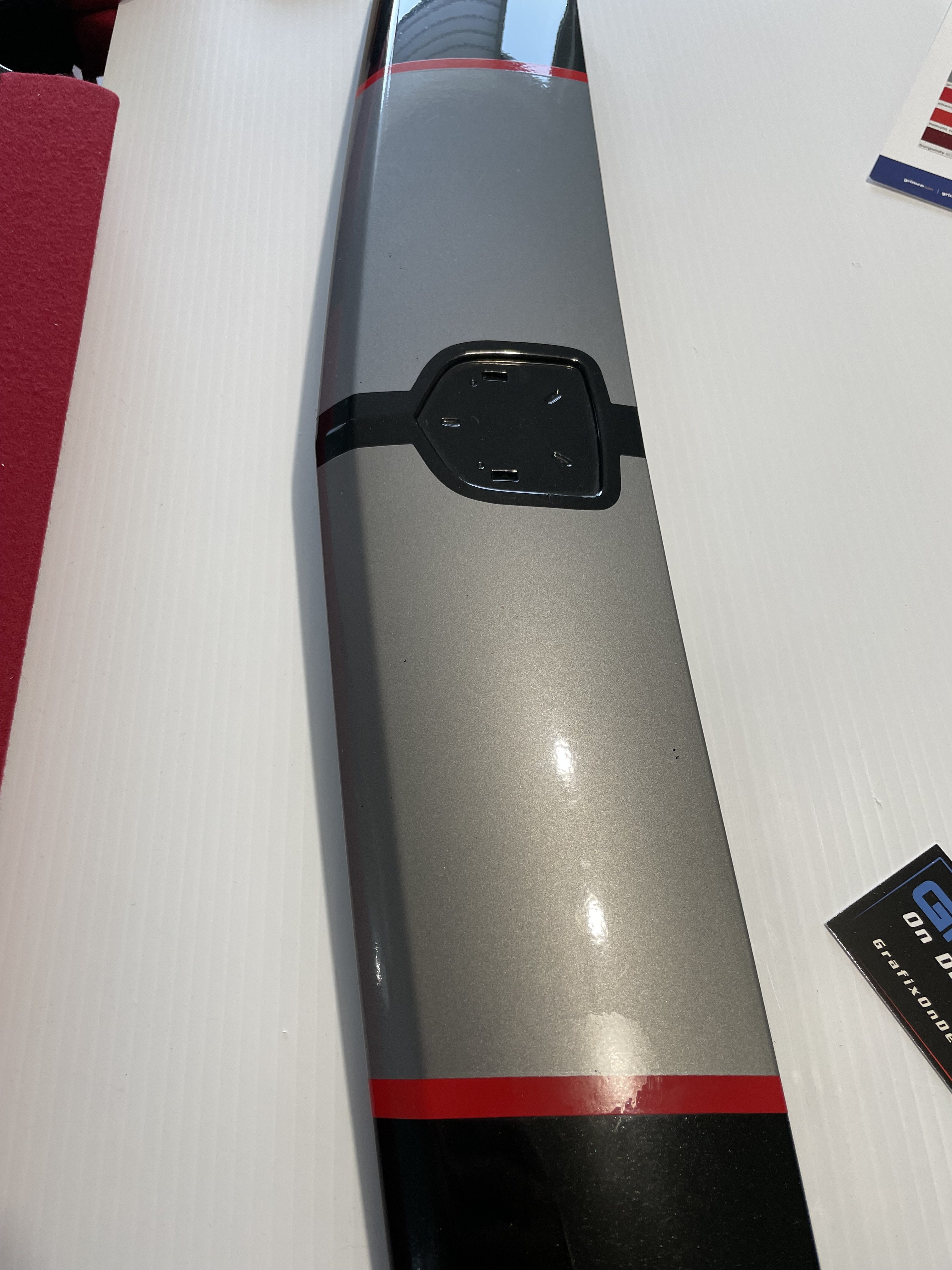

I’ve already pulled my mock up template and cut some test pieces. Tricky licky SOB lol.
Found matching (very very close) metallic silver and the red pin.
I’ll cut the silver then carefully butt up the pin before applying a laminate overtop, to join the two pieces…and kinda match the original.
The gaps are well within tolerance, but I have adjusted them on the file already lol
I’ll post how it goes. Install scheduled for Friday morning. For now check out the test.

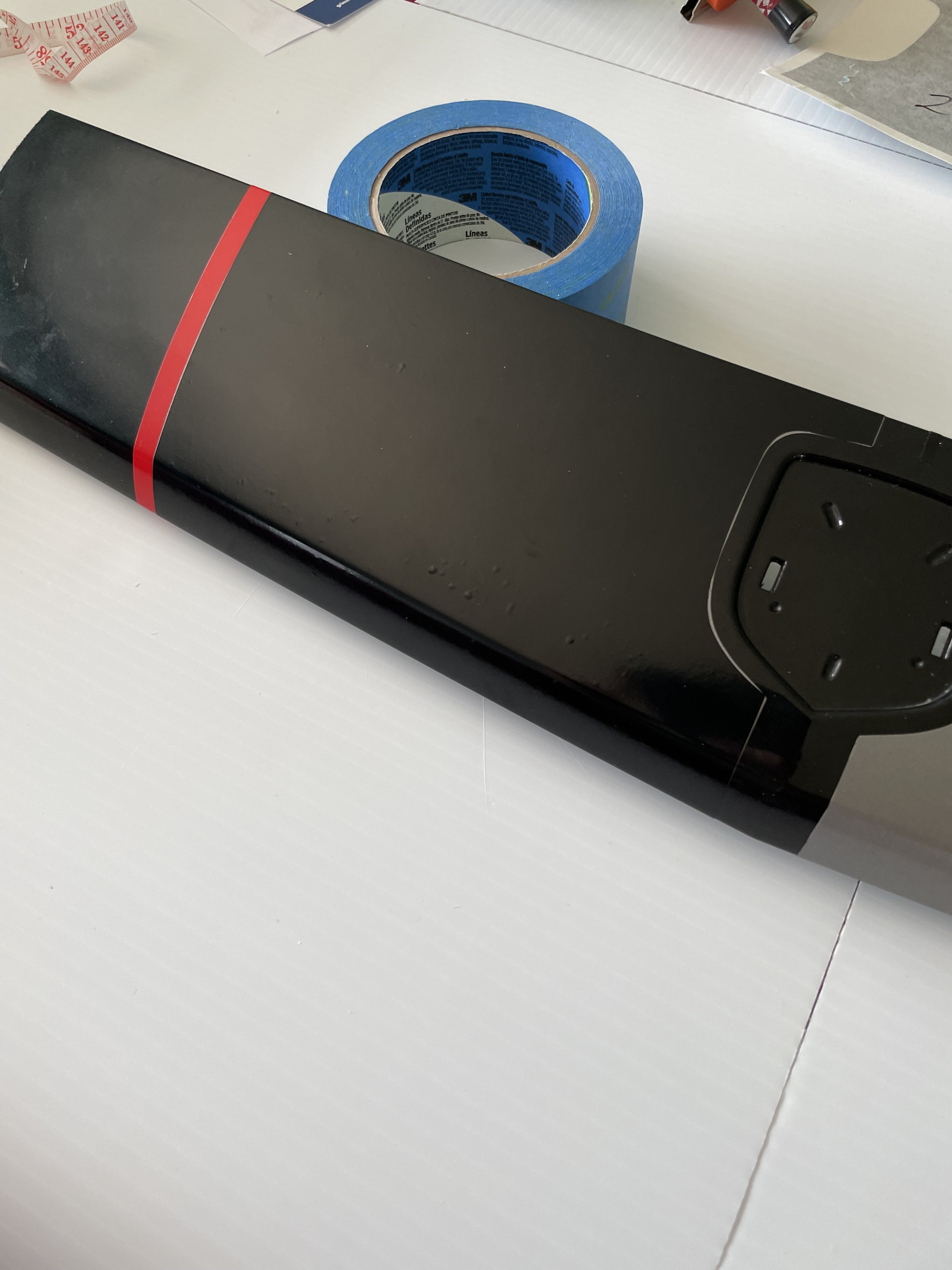

GrafixOnDemand
alright boys, how’s she looking? The trained eye will be able to see which side is the test piece :) pretty much good to go. Fine tune the laminate…and golden
I grew up in a body shop, used tools as teething toys, even had my own shop for a while. Since the day vinyl striping first hit the scene, it's always been hit or miss to match. Even OEM stripes didn't match once a car was a couple years old, always a touch of fading to the original. Quite often I'd have to replace an entire section or side. That's a really good color match.

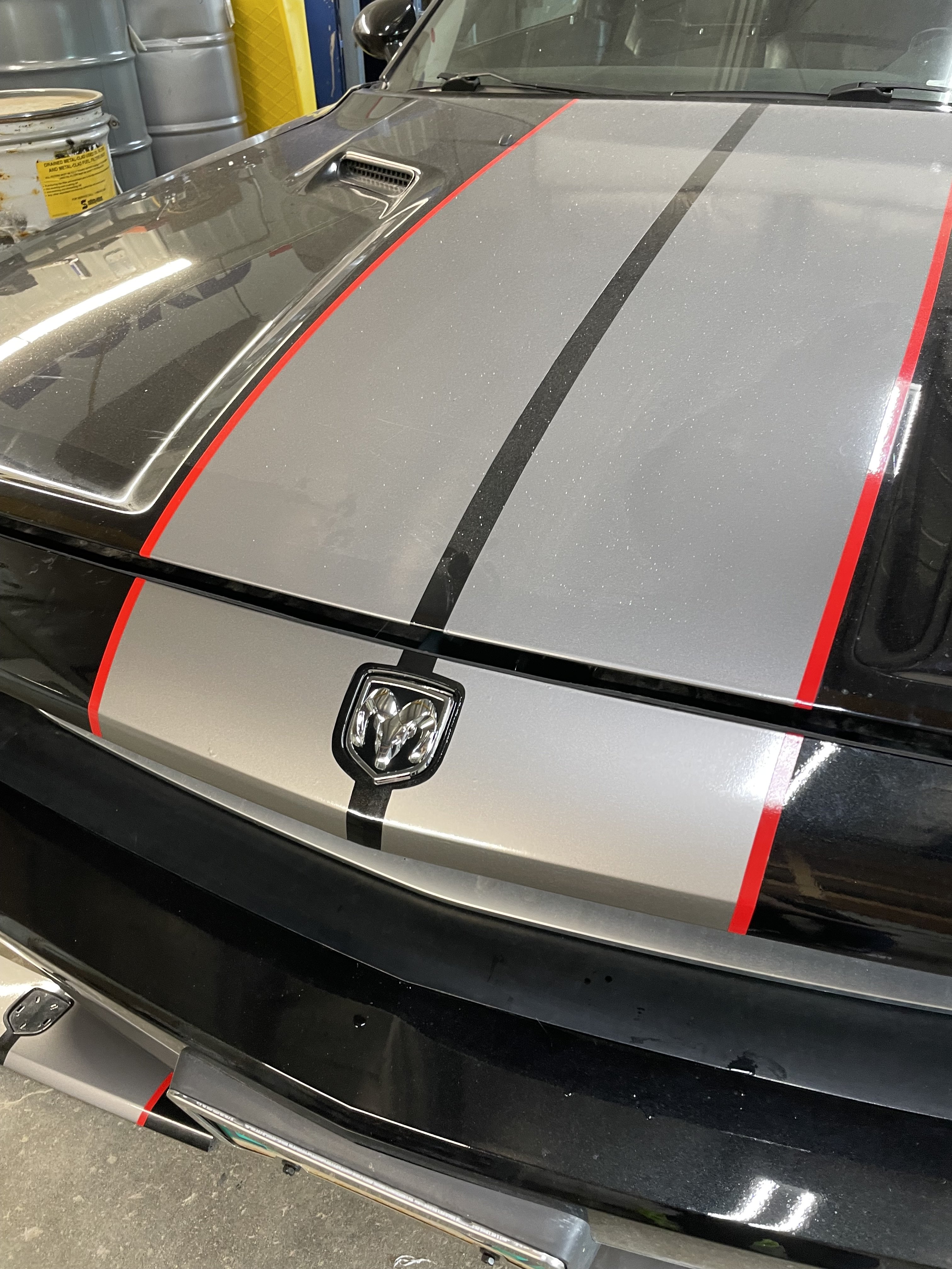

Here’s the finished product on the car. All in all it’s ok. I’m about 90% happy with it. One stubborn little bubble that I hope disappears within a day or so.
but…the most important is that the client loves it. Thanks for the insight guys
