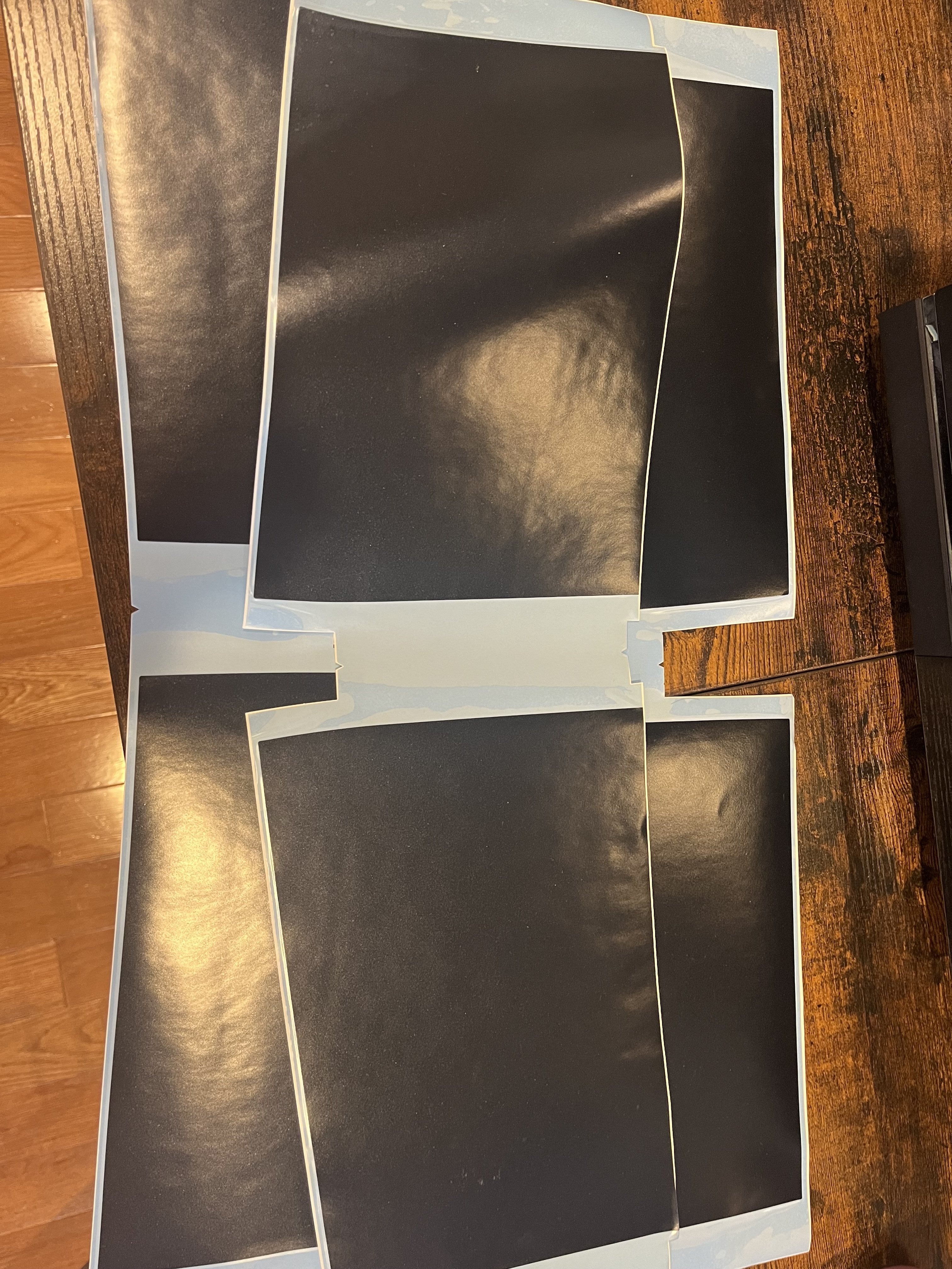

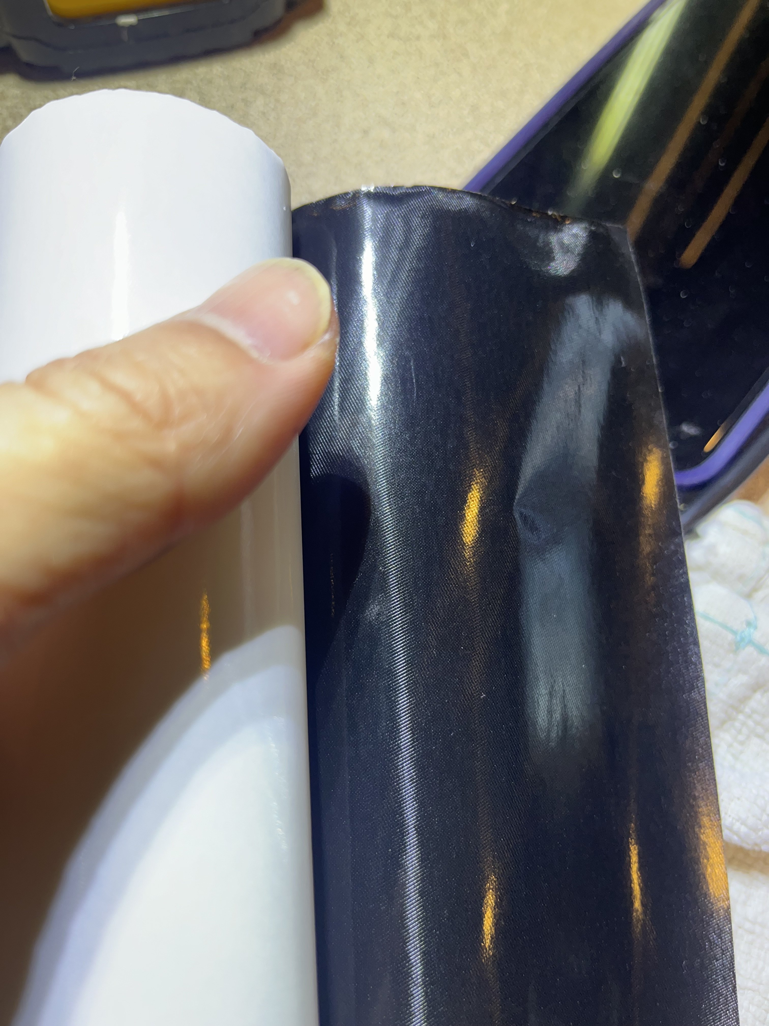

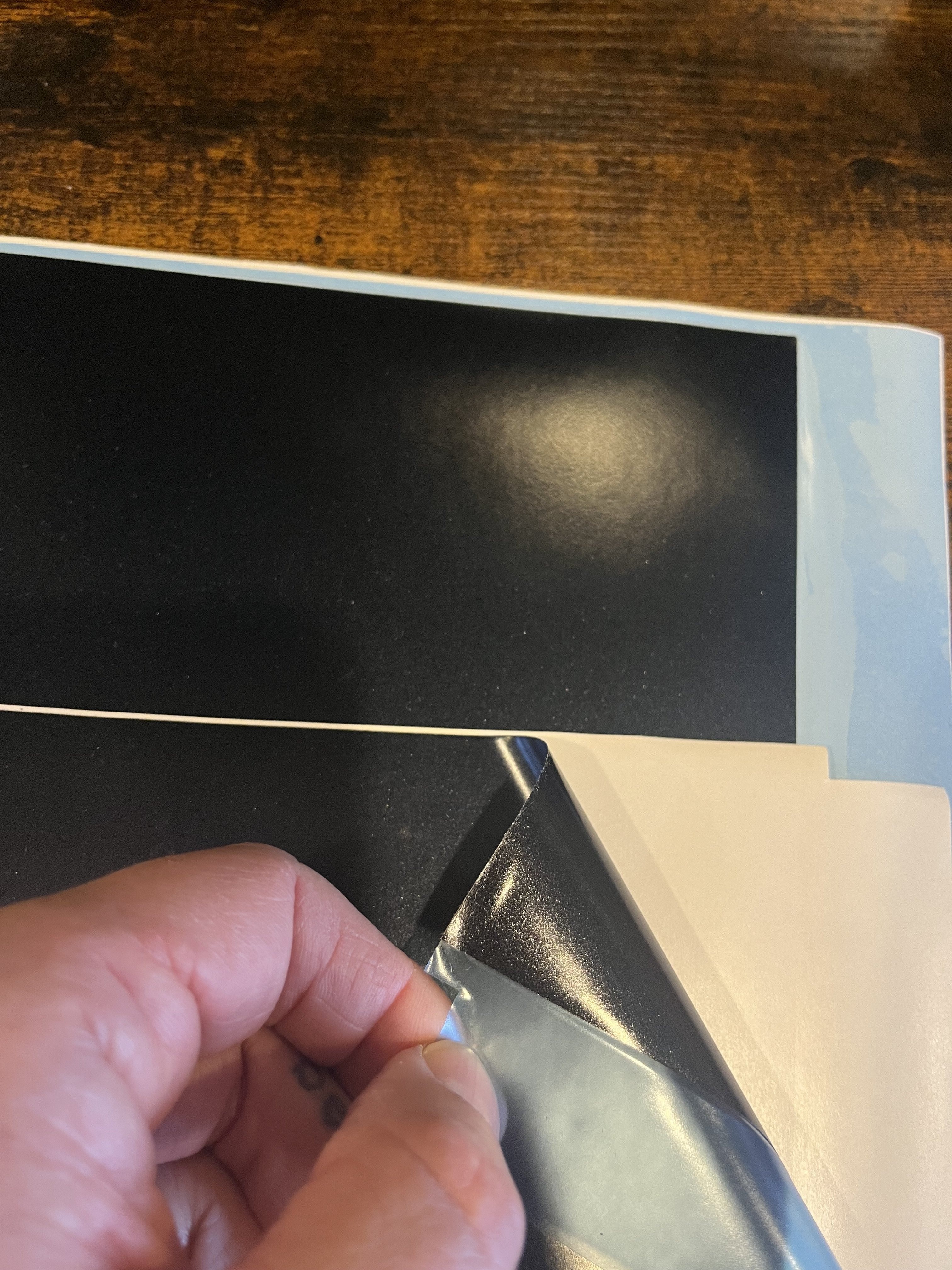

I have a 2022 Dodge Challenger that I bought the OEM stripe kit for directly from Dodge. They don't come with directions but have a template to line them up with is nice (you put the notch on the centerline of the car). Upon a search most people wet install these but some websites say they are 3M 1080 wrap material and must be dry installed. I just want to know the proper install (wet or dry). Here are the pictures below. Can you tell by the backing of the stripe if it's air egress (dry install) or just a regular wet install vinyl?

I was just asking the question if anyone on this forum can tell by looking at the backing paper itself(I read that the air egrees paper looks difference, it's hatched?). I'm a newb I'm just going by google.

If they are 3M 1080 the backing paper will be textured. You can see it and feel it. You can't install wet with textured vinyls. They won't end up adhering. The vinyl is also thicker than regular vinyl and stretchier. Durability is 7 years on vertical surfaces.
OEM graphics are regular cut vinyl. They are the same color on the adhesive side as the front (except for metallics) and the backing paper is smooth. The vinyl is thin and somewhat flexible. For graphics that wide you'll want to install wet. Durability is 10 years or more.
I really doubt the OEM graphics would be 1080 because it's not a permanent vinyl. It wouldn't last long enough for OEM durability.

Thanks. I'm 99% sure these are regular wet install vinyl, the description you gave for the regular vinyl is spot on to what I have from Dodge. For piece of mind though I ordered a very small roll of 3M 1080 from amazon and will compare it to what I have. These OEM stripes aren't cheap just want to make sure I do it correctly........

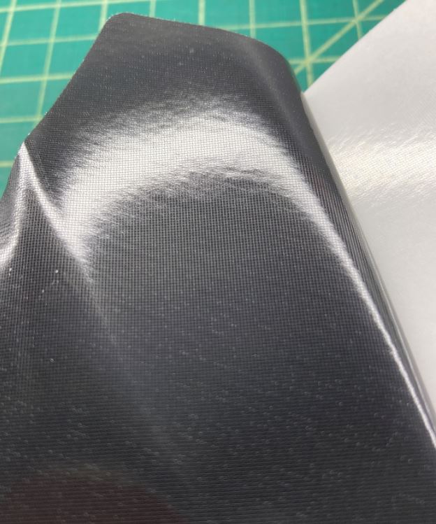

So to close this out you guys were right on. I ordered 3m 1080 and they sent me 2080 saying the 1080 was being discontinued. Anyway here is the 2080 with the visible air release like posted above. Learn something new every day. The OEM stripes I have don’t have any of these channels.
