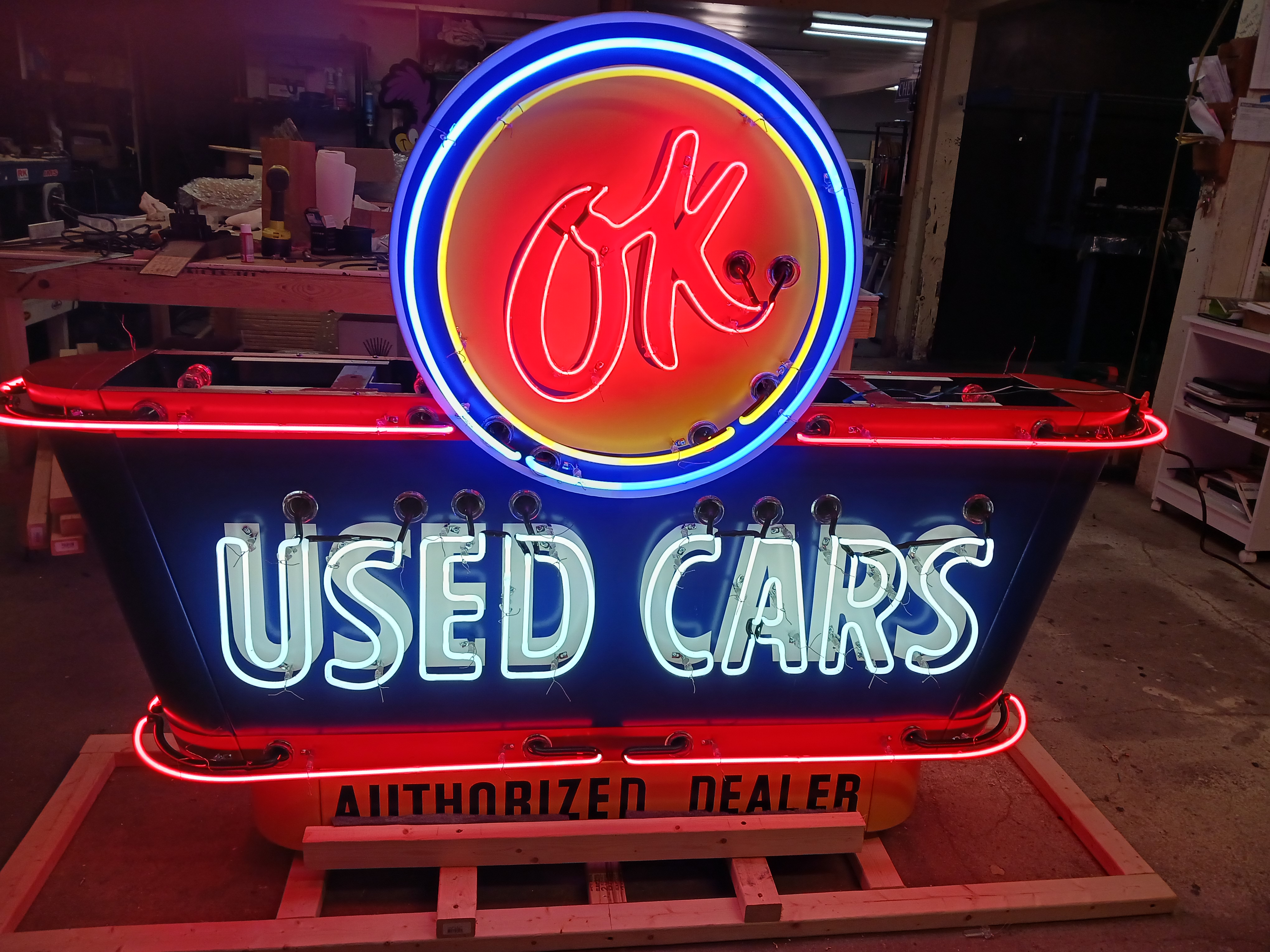

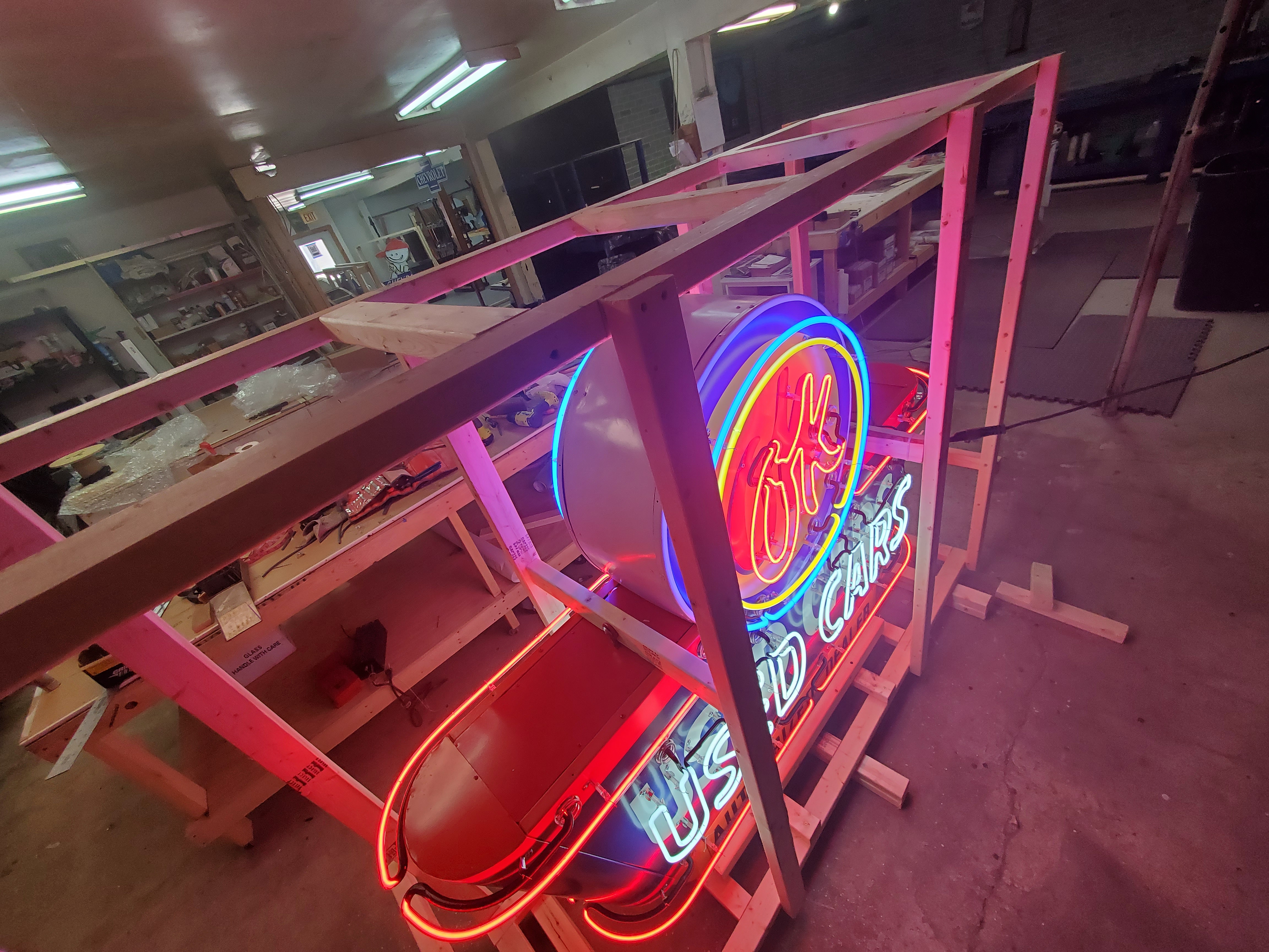

Now all we have left to do is mount the glass and build the crate. we start with the bottom of the crate and then move the sign. We will mount all out glass before building the rest of the crate.
What a difference!

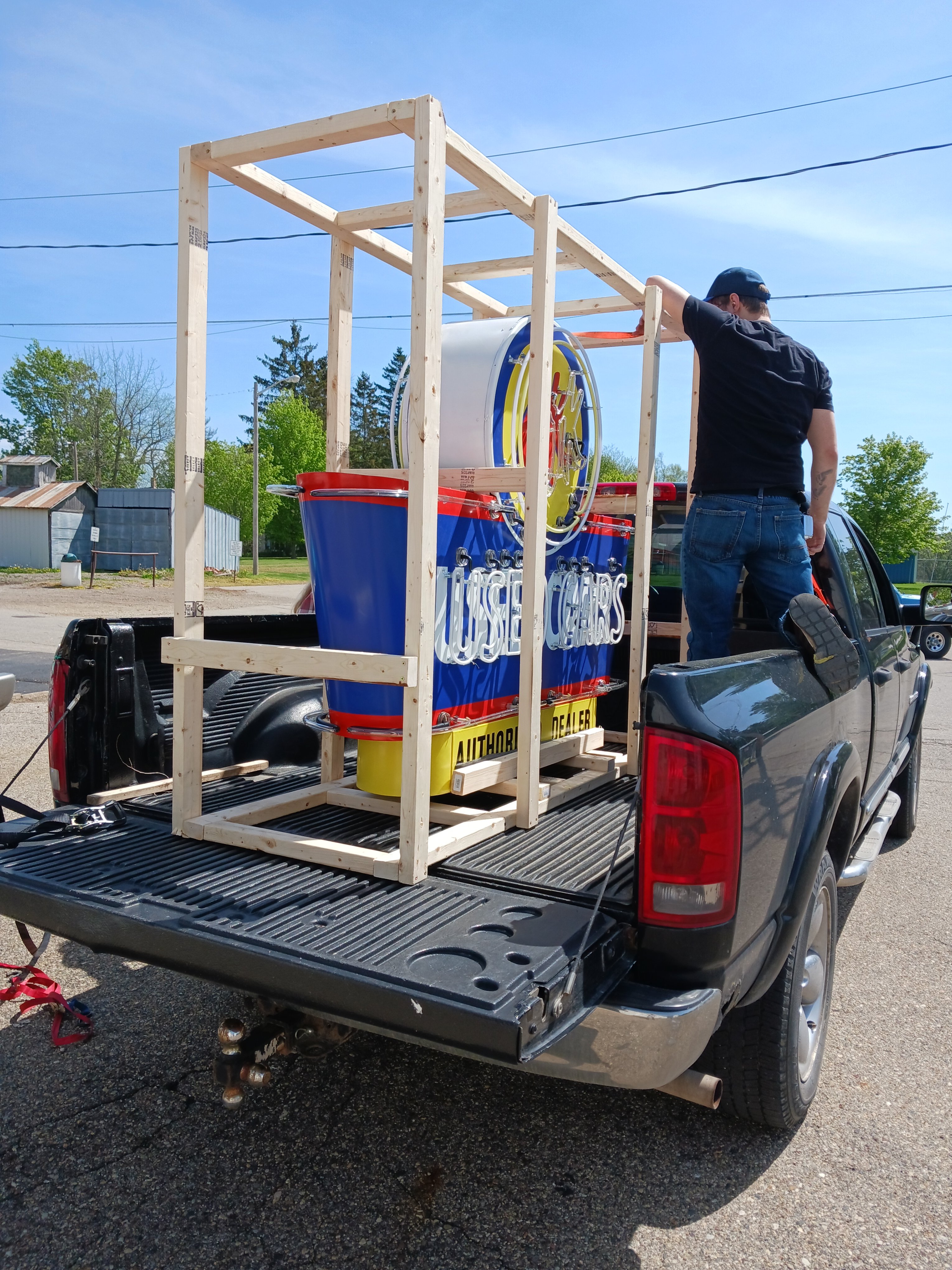

We do our final inspection and touch ups before finshing our crate with runners to screw the eyebolts into. This will ensure the sign isn't jostled before reaching its destination.

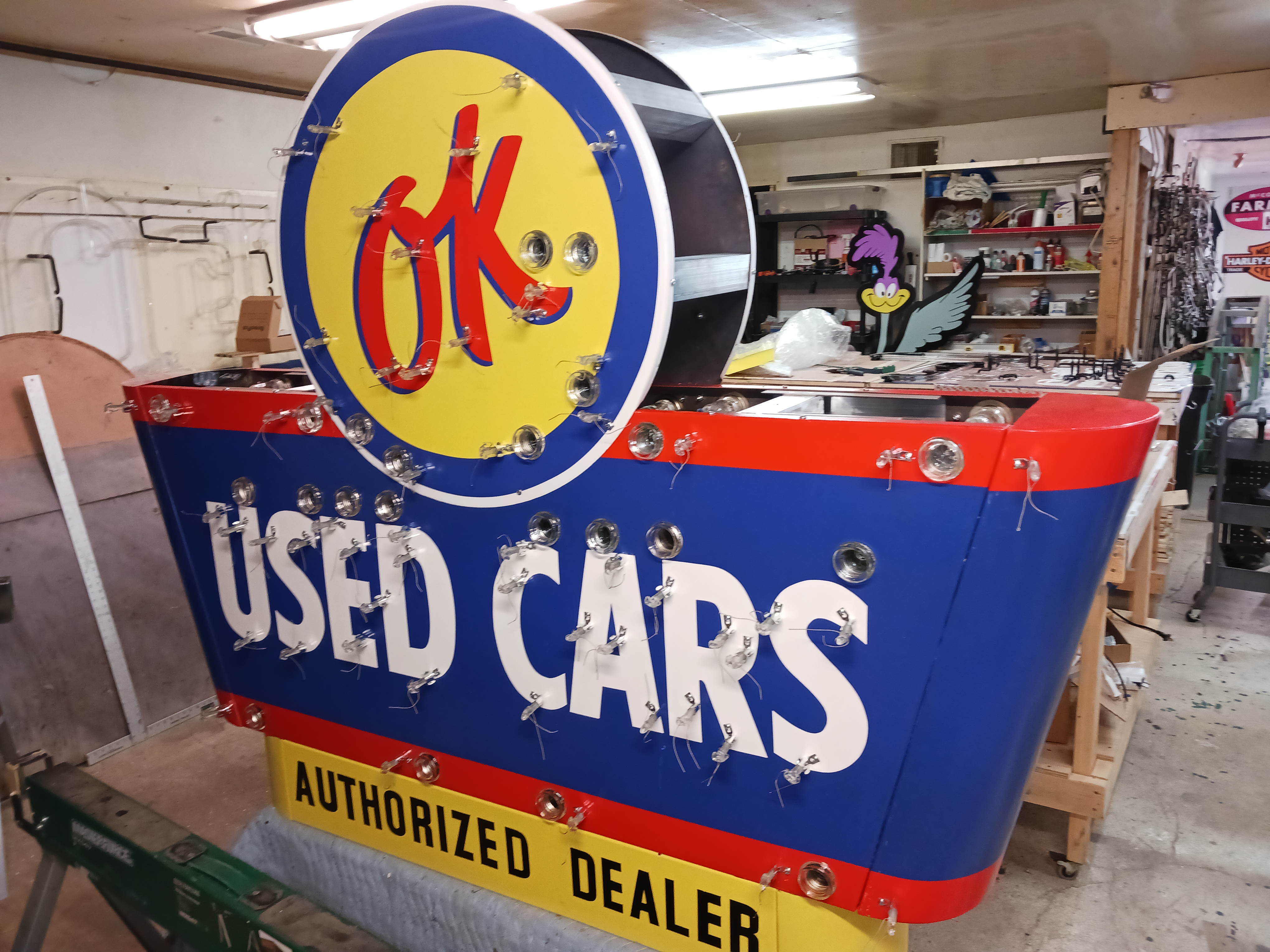

Luckily enough, I have a guy in Memphis and one in Texas, though I have to ship them patterns instead of being able to email scaled drawings. Do you have a plotter at least?
Also, I've never seen someone do a double back into a pk housing like this. I'm assuming it's to miss the painted features, like 'used cars', and to put the housings in the background regions. But for the life of me I can't figure out the two end units being broke in half like these. No, wait, it just occurred to me, you aren't going to flex the neon to get it into the pk's if you did the end semi circle in one piece.

yea i have a plotter its older but it gets the job done. Alt of times were having to hit the previous/original sign pk's, like in this case.
