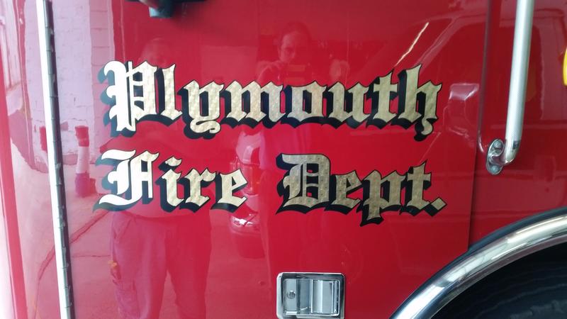

I thought I had this font figured out, but apparently the "font" I have is no good...
I had "English Towne" as the font I was going to use, but that font isn't any good for cutting.
Any idea on what font I should be using?

No. This is for a fire truck. Aint gonna fly.
What about it does not work for a fire truck? Is it the type match or construction? I just did a quick run on it in Illustrator and had no issues resolving excessive anchors after building a drop shadow for it.

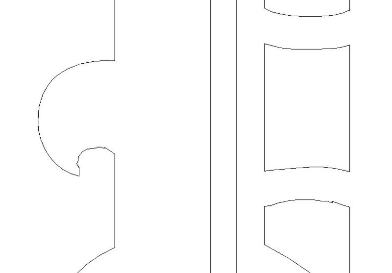

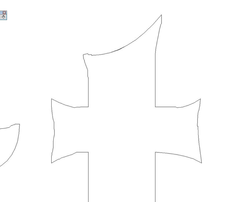

There are many little problems, zoom in and check it out in outline view.
Maybe there is a clean version out there?
