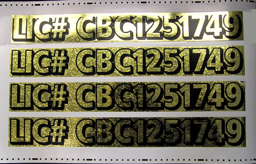

Just came across and reported a bug in Omega 2.0.2
It is possible to set Y-Axis repeats for Edge prints that exceed the available image height. The system will print the job and the top of the image will simply not be there.

Strange...This just happened to me today and I have Omega 1.56 and the image was not larger than the 11.75" print limit.
Dale Horn
There goes the profit on that job...
Sometimes if the x gap and Y gap make the image bigger and cut off the graphic's edge. This sizing thing seems to be a limitation in SignLab Flexi and Omega. In omega the taking the weed border off (unchecking it ) and going to layout >border in gsplot and setting it to zero helps.
This is where the WYSIWYG feature in the new SignLab7 should help a person avoid this. Every new software is going to have some weak spots.

I have done many repeats in 2.02 and havent run into that one yet at all, but I will keep an eye out for it.
The even bigger problem seems to be the shape between the 1&7 that wasn't set to clear LOL
DOH!:rolleyes: :biggrin:
Fred Weiss
Merchant Member
That's because there's a bleed on the black and Omega doesn't combine shapes when it does a bleed even if they're already combined. It was everything I could do to get Tony T to see the wisdom of automatically welding bleed shapes that overlap when I was beta testing version 2. Maybe in version 2.5.
Anyway the cut line is there so it is correct when weeded.
