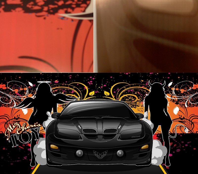

Can you upload a picture of the output? I have never run across a firmware update that caused issues like you are having. In the original post you said that you were getting an E016 TLB-L/I [02], updating the firmware can sometimes fix this message but the message indicates that there is a problem with your main board. I have a feeling that your main board has failed and should be replaced. Mutoh doesn't have version 1.14 on their ftp site anymore but I know 1.18 is a stable version and it is still listed you can give it a try.

It was tougher to take a picture than we would have thought... Attached is an image where the banding can be seen as well as the colors now being printed are so far off from the original art. We included a shot of the actual print so you could see how far off the colors are (using the same profile we've always used), after the firmware update.
Keep in mind before the lockup and error and then the firmware update our prints matched near perfectly to the colors in the original art without any banding whatsoever that we could see.
The section of orange is from the far left and the green (which was supposed to be black), area right below the left turn signal in the original print. All colors show some amount of banding, but it's really pronounced in the orange and black colors.

What does the nozzle check look like? Are you missing nozzles and does it look like your colors are mixed or do you have all four colors?
