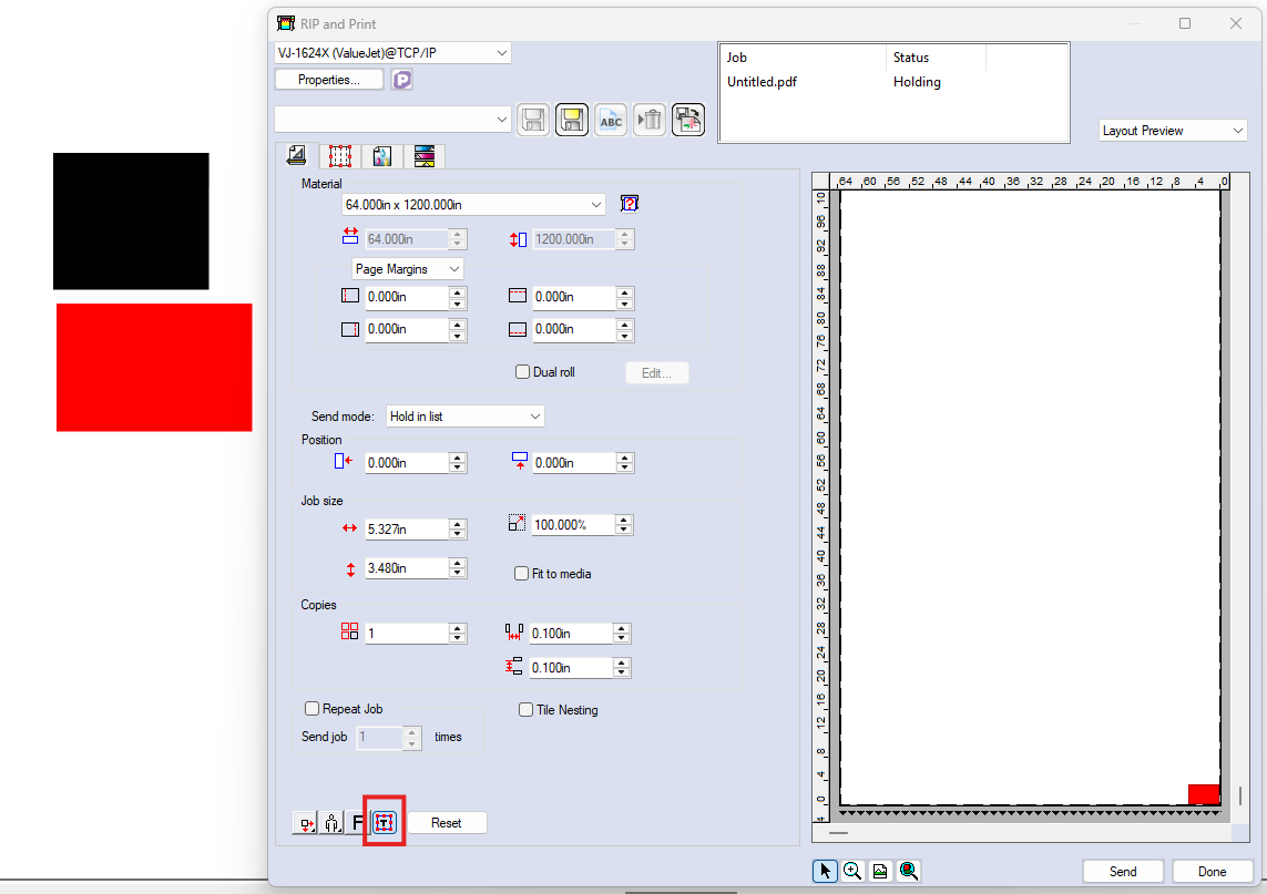

I updated to Flexi 24 and since then, I have the problem that when I have multiple designs on one page and select just one design, then press RIP and Print, it wants to print the entire page with all the designs. With Cut/Plot, it works fine, as it only processes the selected design. I can’t find any setting for this. Does anyone have a solution?

When we send to Versa Works and Raster Link the first dialogue box has a box to check for Selection Only. When we send to Onyx it does not and so we go File Export and drop it in the hot folder - during this process a dialogue box comes up and we choose selection only...

In the Rip and Print window, near the bottom left of the first tab, there is a selection only button. I put a square around it in the included photo.
