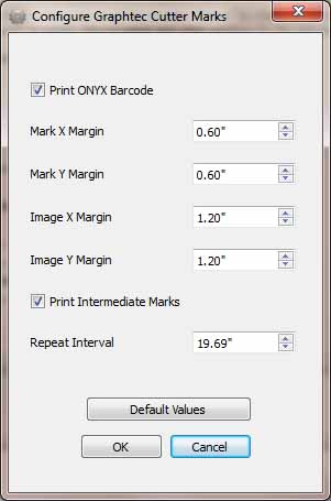

Oops, you are correct. I had thought that the Cut Configuration screen in Onyx 11 contained this type of functionality, but I was wrong on that.
The Graphtec Cutting Master 3 plug-in does contain that capability, but not Onyx.
