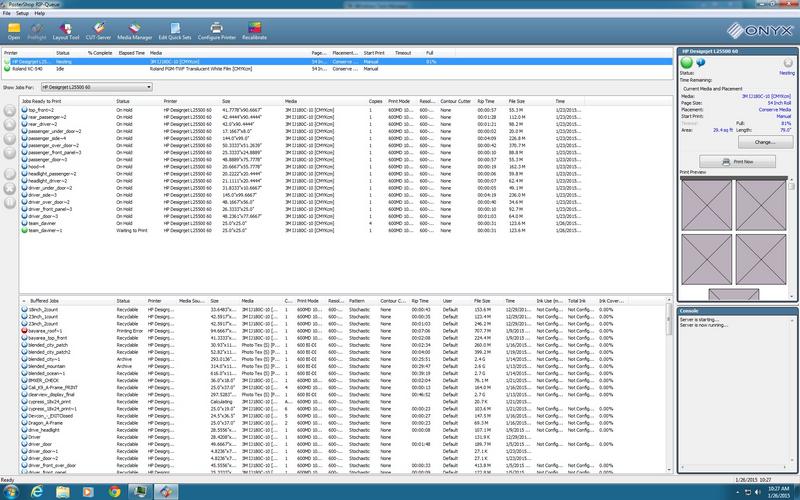

I'm having a problem with Onyx 10 and copies. I have one file, that I want to print 4 copies of, and when I set it to 4 copies it shows 4 copies in the que, but if i highlight the file it shows 20 copies in the view area on the right of the screen. I've tried restarting Onyx, restarting the machine, created a brand new file, saved as both eps and pdf, and nothing changes, still shows 20 copies. Is there some sort of base setting somewhere that its taking the 4 copies I want and multiplying that by 5? I've never seen anything like this before.
Aklaim
Even set at 1 copy, you can still see that it thinks there are 5 on the right hand side.
BK Vinyl
You have about 20 jobs ready to print. It doesn't think there are 5 things to print, it thinks there are more. Scroll down to see the rest...
Why do you have so many things ready to print if you don't want to print them?
Aklaim
Found it! Somehow the output was switched from color to separations, which was splitting it up into 5 files. Which is weird because we've never done any form of separations here before.
BK Vinyl
Yeah, now I see they are all on hold except the the bottom file, and that says 1 copy. Now I'm stumped. On the upside, you want 4 copies so you're only going to get 1 extra...
