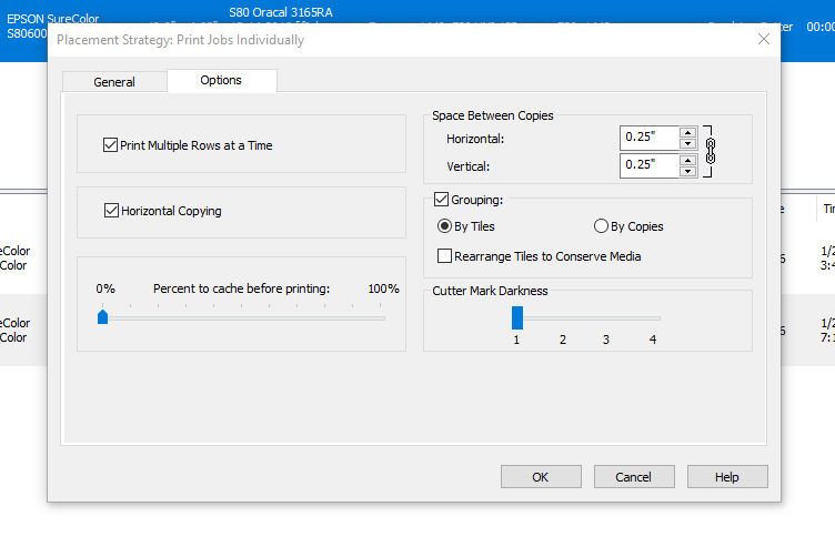

In Rip Queue
Double click file
Click options tab\
Check box for Print Multiple Rows at a time.
