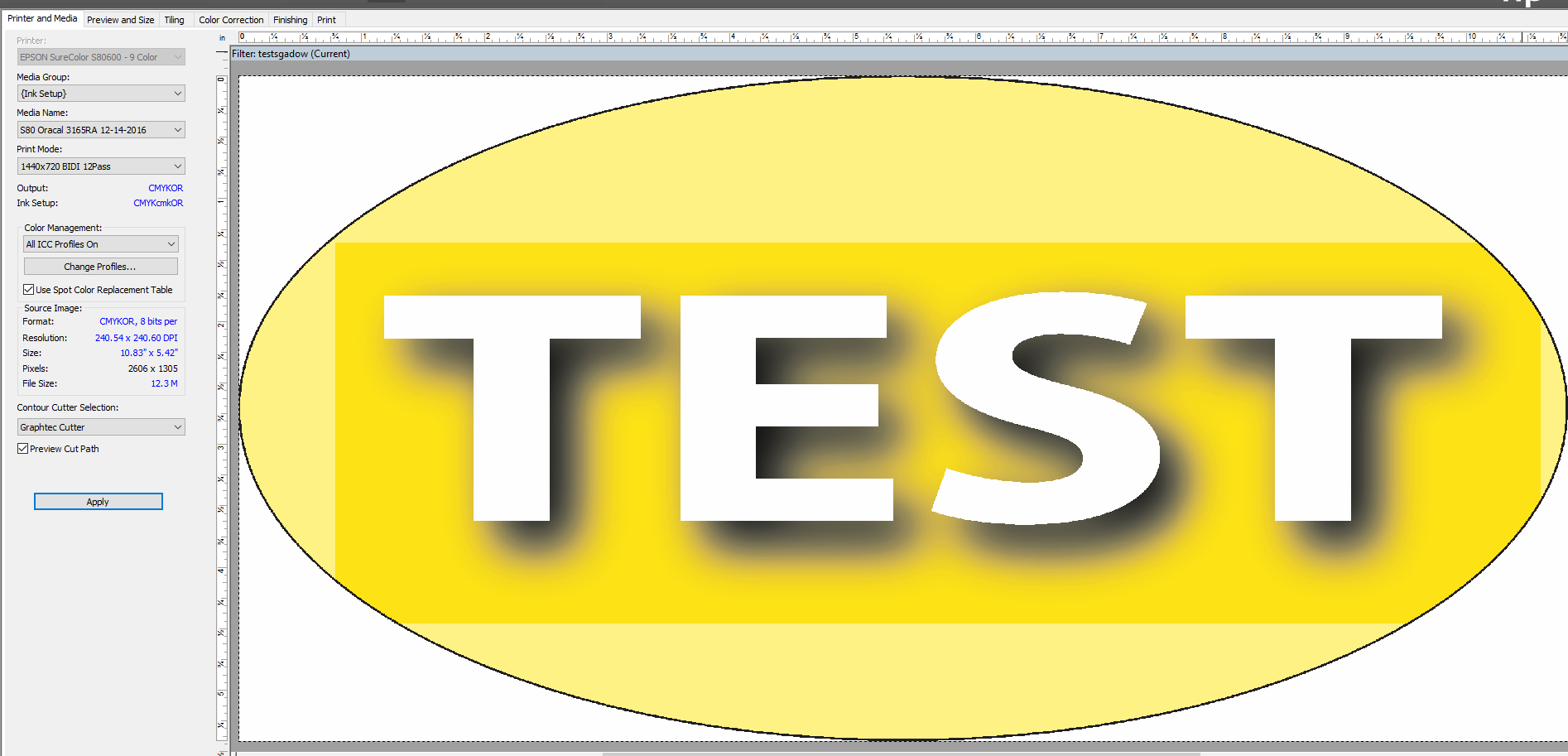

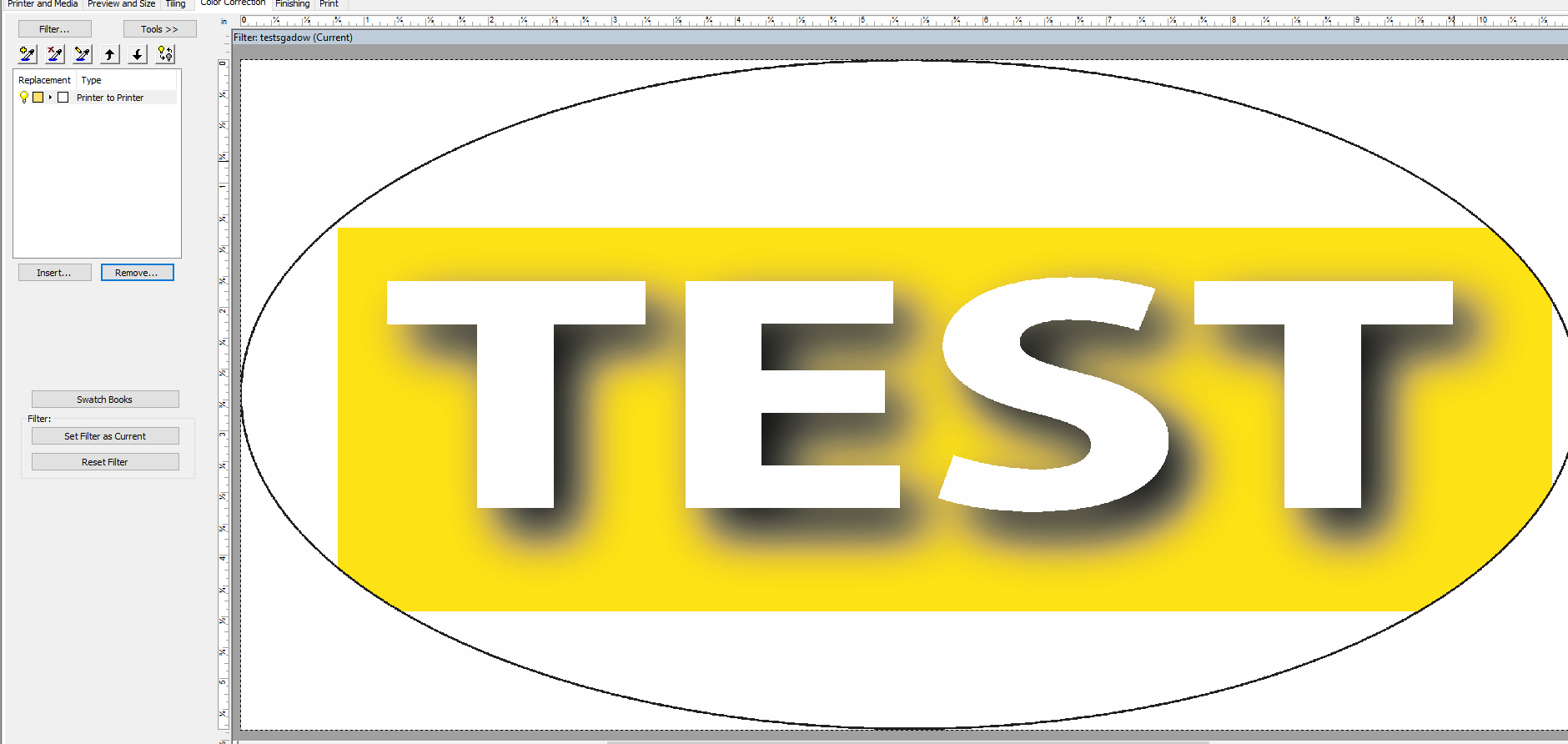

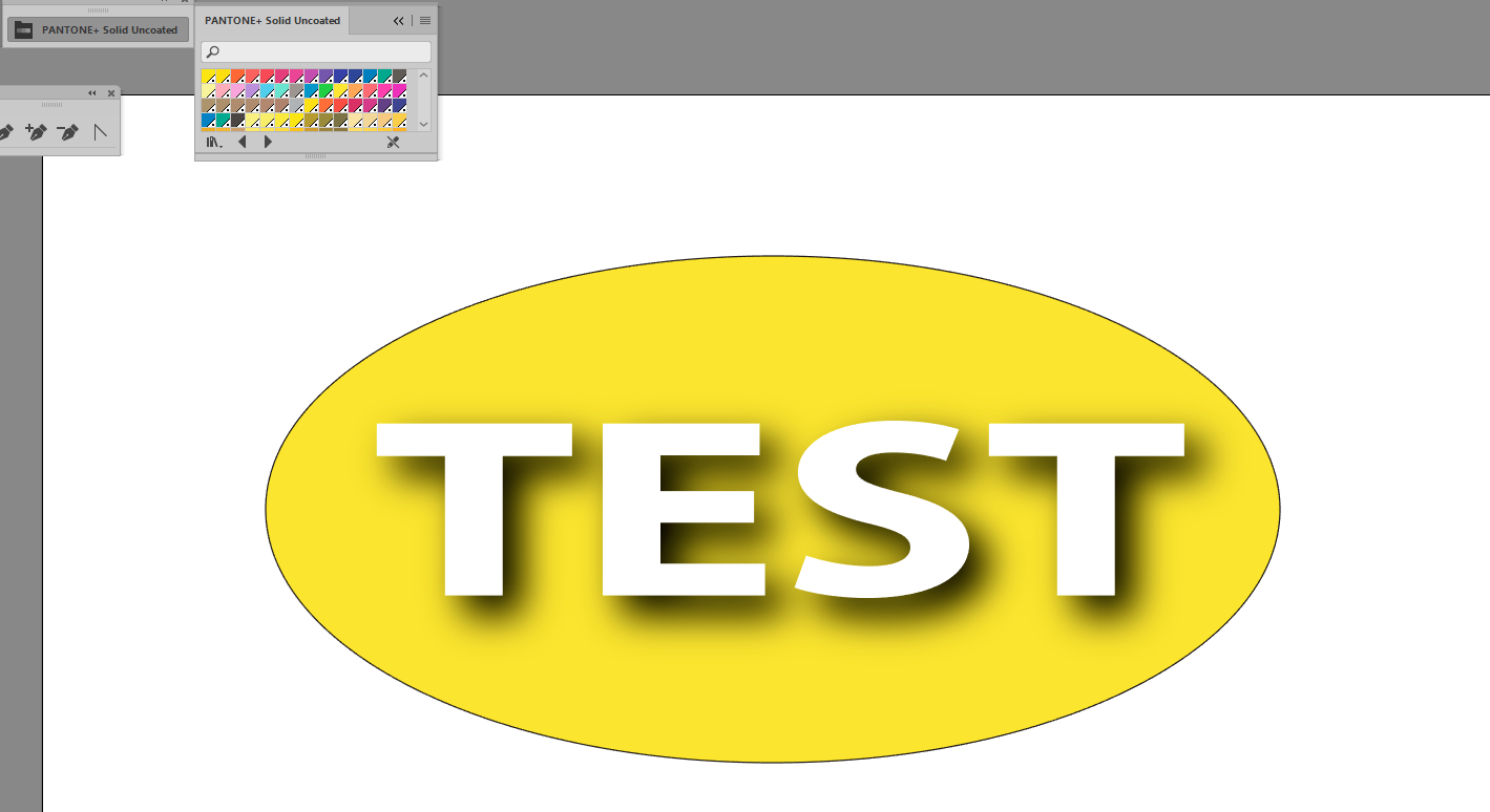

I have attached 3 images. One is the file created in illustrator. I used the effects, stylize, drop shadow. Saved file as an EPS then opened in Onyx job editor.
As you can see from the next image that it created a square in a different shade yellow around the text and the rest of the circle is another shade of yellow. When i co to do a color replacement you can see from the next image that it only selects a specific area.
If i take the same exact file in illustrator but remove the drop shadow i get non of these issues.

That's probably because you have a shadow in it. The RIP will see it as a different colour value because it has more black in it from the file. Onyx does not see the shadow as an actual shadow layer.. It will just see it as a CMYK value (not the same cmyk value from illustrator but the cmyk value from the output profile in onyx)

It is a spot color with a transparency issue. Same as if you made the orange a Pantone spot color and put the drop shadow over it.
When you do "spot color replacement" in the RIP it is choosing a particular color and kind of making it a spot color, then replacing it; so where it is affected by the transparency (drop shadow) it will not be replaced.

Same issue weather it is a spot color or just a simple cmyk or rgb mix. I mean i understand why it is doing it. The rip is flattening the file into an image or illustrator is flattening the image before it is saved. This then results in the area that has the shadow showing a different color of orange since it has a black over it. I am just looking for a way to hopefully modify this process to allow the rip to possibly see the shadow and the orange and completely different layers or colors all together to allow me to modify or replace the color weather it be a rgb/cmyk mix or a spot color.
I am not just trying it as a spot color replacement but also as a simple color replacement.
