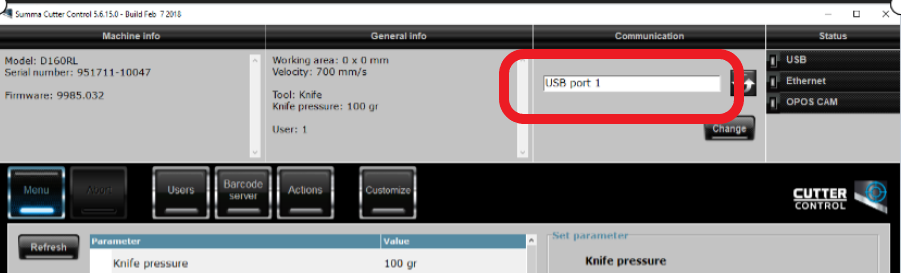

Have an issue with Onyx (12.2) CutServer not recognizing Summa Cutter so no jobs being sent to cutter.
Summa Cutter is on "Summa USB port 1", I have tried all Desktop USB ports with no luck.

Not sure if you had reloaded software leading up to the issue, but open the Summa Cutter Control software and check that USB port 1 is selected.
Let us know what you find. Good luck.

We can see Summa cutter settings ("Summa USB port 1") via Summa Cutter Control webpage

The summa cutter is visible in Summa Cutter Control webpage - so the desktop can see Summa cutter settings and we can change them, its just the Onyx cutserver does not send any jobs.
