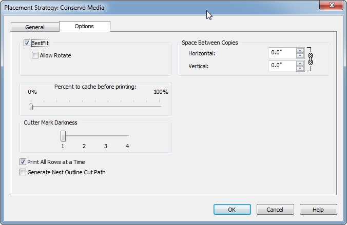

It bothers me that I have not been able to find an answer to what I'm assuming is a no-brainer question. We use Onxy PosterShop to operate our printers and for the life of me I haven't been able to figure out how to automatically increase the space between each print. Can anyone advise please?

This is Onyx 19 so I'm not sure if you have the Horizontal and Vertical Spacing options. At one point it wasn't an option. Just spacing that automatically did Horizontal and Vertical.

Thank you for the visual. I had looked at that, thought it might had been the setting for when you make copies that space. But that's what I get for being too literal
