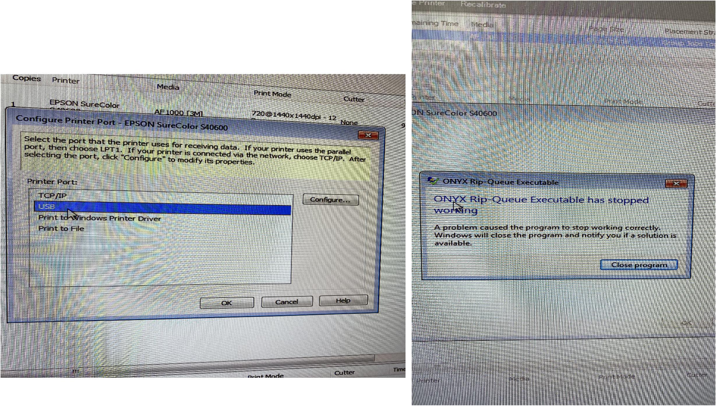

Help with onyx please, im having problems re-installing onyx,
i was able to install it the first time and it was running fine trough USB,
i was having issues with onyx communicating with my plotter, so i decided to try and run my printer trough ethernet, ansd see if it solved some issues, which i was also unsuccessful,
to make story short now im trying to re-install my printer using the USB connection but i'm getting this messages. please see attached..
i should've kept my vp-540 running!!
running windows 7 pro. and epson s40600
thanks

hazartilirot
If you've got a Windows Installer, boot with USB/DVD, format your C: drive and install a fresh OS. Then, install all drivers, upgrade Windows and only then install Onyx.
I would recommend that you use Ethernet port. USB is unreliable. Tell us what issues do you have with Ethernet?

Gotta say, if it's V19 I don't think it's even meant to run on Win7....
I'm running two computer with Onyx 19 on Windows 7 so I don't think it's that. Maybe try using something like REVO uninstaller on ONYX for a clean uninstall and then Reinstall.
hazartilirot
Whenever you re-install Onyx, after uninstalling the application go to its directories like program files and delete all files that have been left.
p.s. WIN + R, type DEVMGMT.MSC, open it and see if there is everything okay.

got it running again.. i emailed Onyx and they figured out the problem right away, too manny USB ports been used.
it just wont connect trough ethernet, i finally got it running trough USB, i will print some back orders i have pending and give it another try next week
thanks
signrios
fixed the problem, seems i had too many USB ports in use, will report back next week with another try on the Ethernet connection.
thanks everyone
