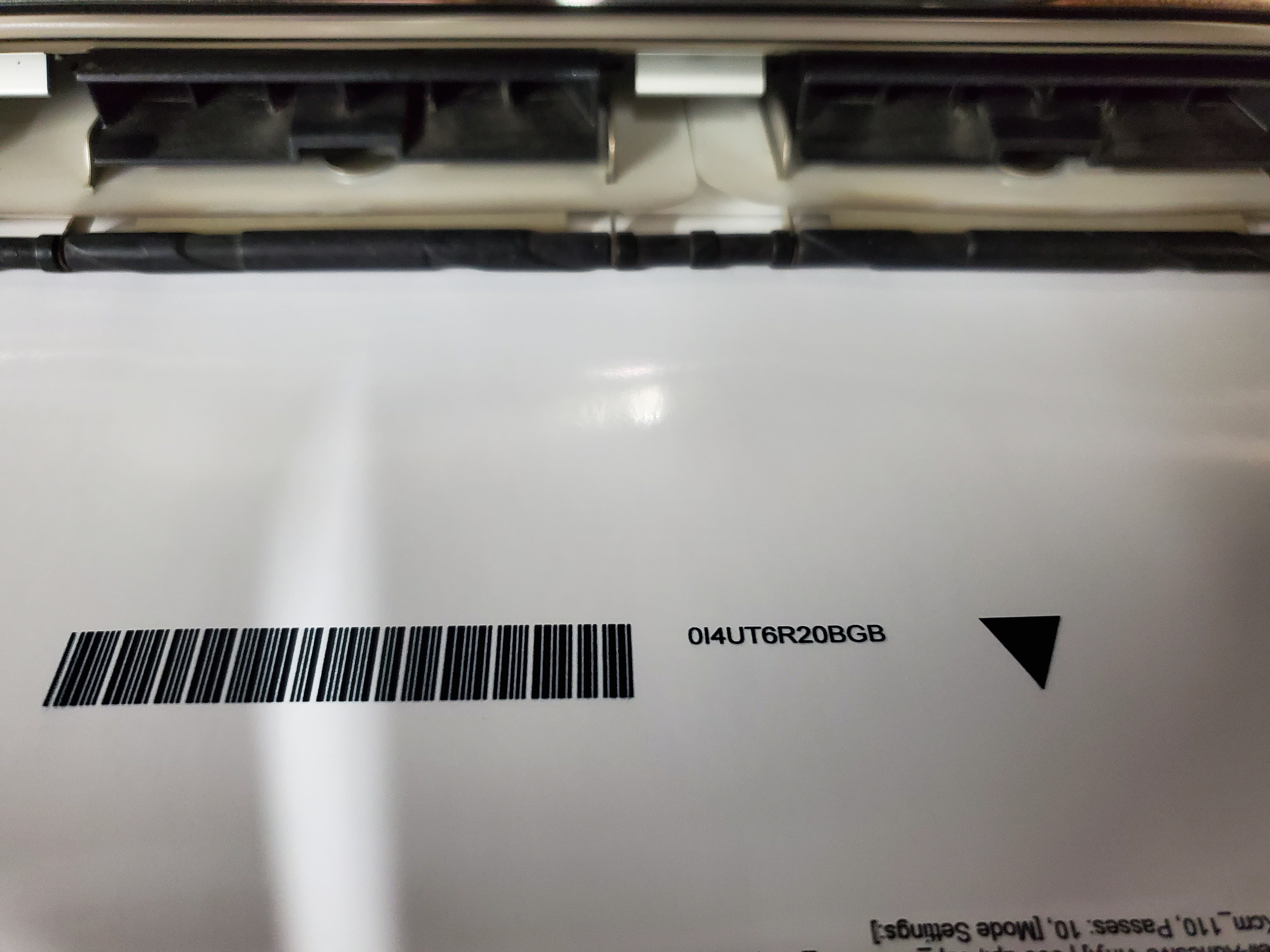

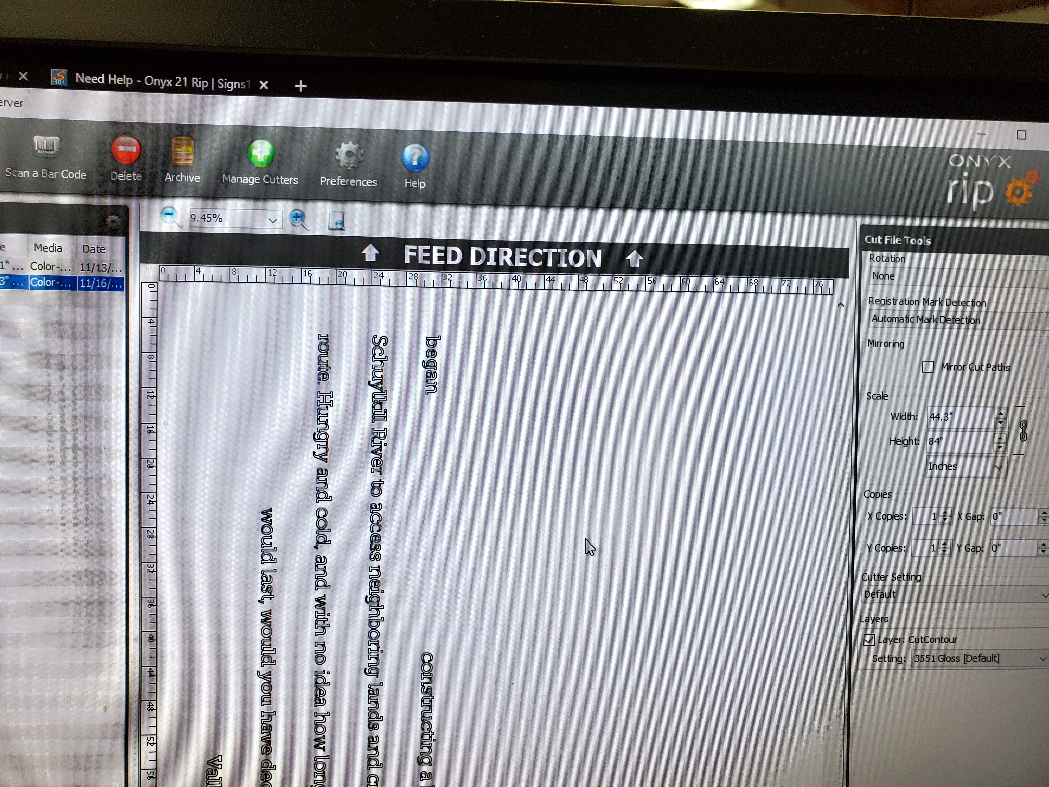

When you do a print on the HP L570 or whatever printer you have. The print starts the barcode, and the arrow pointing forward I am trying to reverse the barcodes .
So the arrow in front of the barcode is ^ I want to flip it so the end barcodes is up front be v

I have a Graphtec 8000 but, A Onyx Rip. When the print starts the arrow is and barcode is ^ I am trying to reverse it so the arrow at the end v is at the front of the print

Can't do it at the RIP end. But running the print through the plotter backwards is easy. That can be done either from cut server (easiest) or from the cutter front panel (very arcane and you have to remember to undo it for other jobs).
