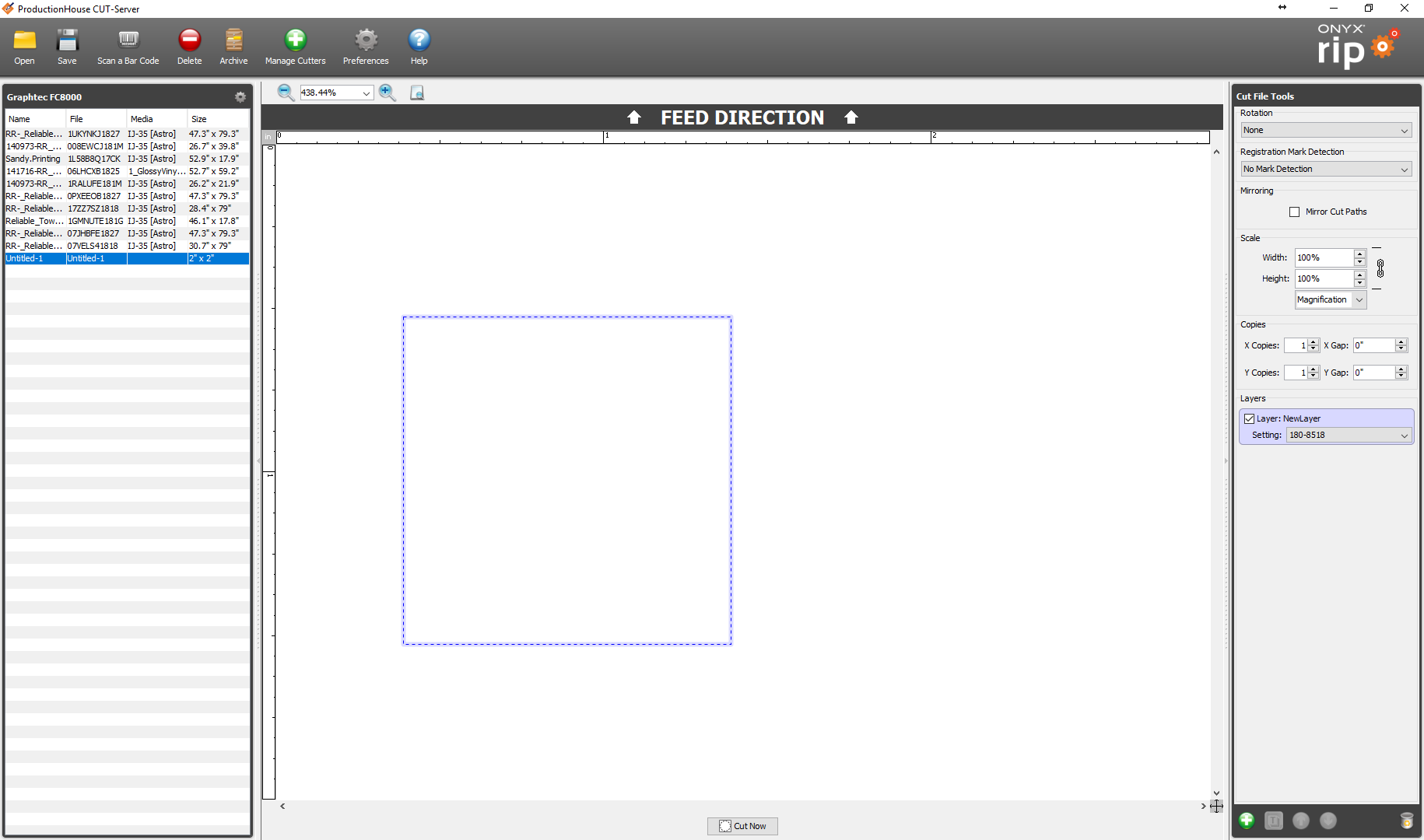

I just E-mailed you a file. It's just a 1" x 1" square, on a 2" artboard as .svg. Open up Onyx cut server, click open, and load that file - Then send it to cut. It should just cut without needing any marks or anything. See if it cuts as 1" x 1", or if its bigger. Then you should be able to eliminate the ripping.
I use a Graphtec, so I'm not much help on the cutter side. Onyx does look like it's setup right, which leads me to believe it's a cutter issue. But just to rule it out... load the file and see what it does.
Also...On our version of cutserver there is a ruler with how big the sheet/roll is. I'd double check that to make sure it's right. Theres an option to change magnification in the cut server also. IT may just be a graphtec setting, but I doubt it.
ikarasu
Right side there is scale - You can change it to magnification, make sure it's at 100% and not higher also.

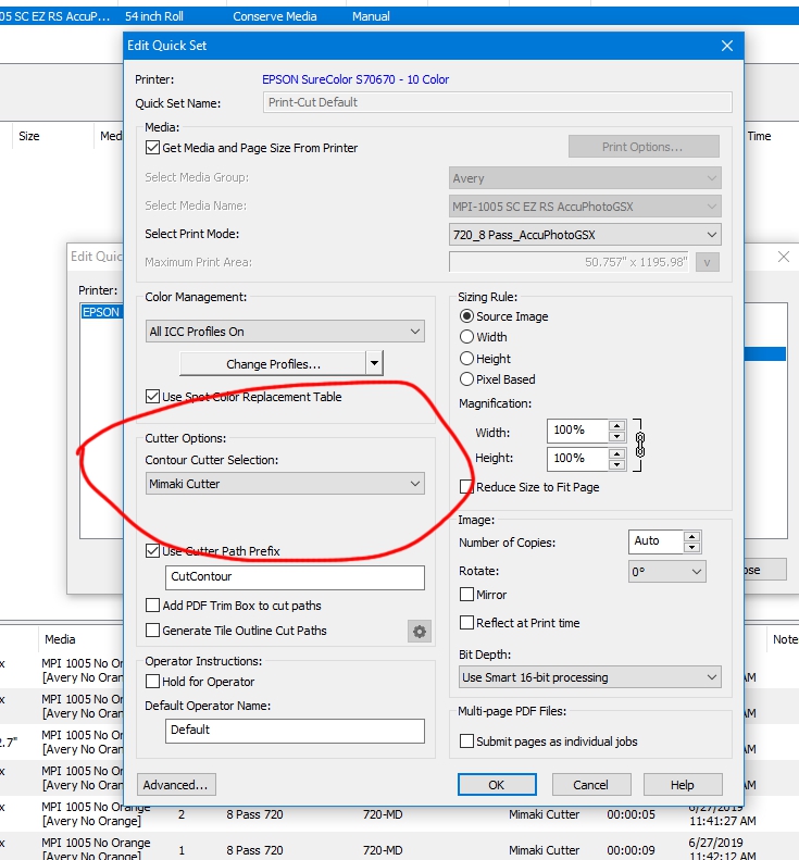

only place it could be would be in your quick set. if you double check it.
here is a copy of my quick set, see if it helps
How did you get the Graphtec Cutter to show up as an option in your quick sets? I have no cutter options to choose from when creating or editing a quick set????
unclebun
For the cutters to be there you have to have selected them when you installed the Onyx RIP software. Also you have to be running the software as an administrator to be able to make and edit quick sets.
