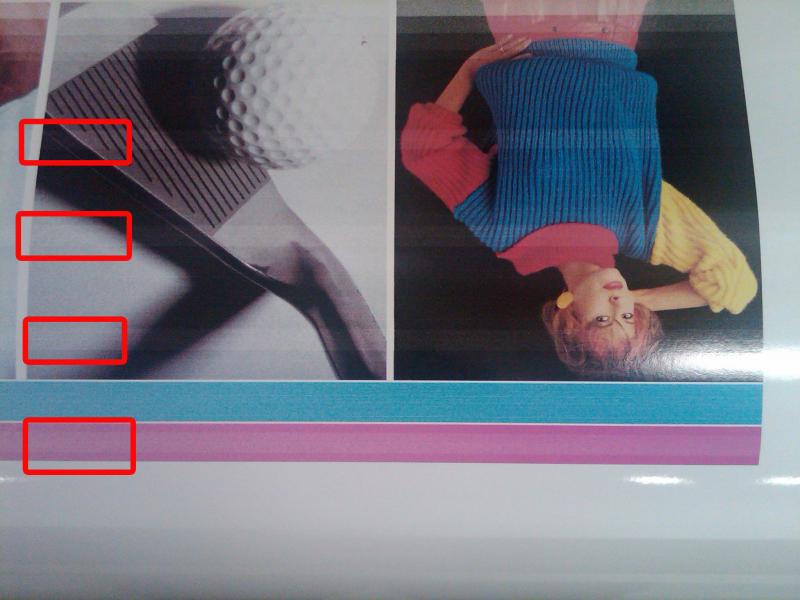

At first I assumed this was a printer issue, but have come to realize it's only occurring through Onyx. Any suggestions as to why this has become a problem all of a sudden? Any suggestions as to what I can do to eliminate the problem?

If this is on the JV3, I've had similar issues with both Onyx and Flexi, though the bands' severity varies depending on the diffusion pattern used, tempurature settings, and number of passes involved.
I used to print everything at 720-4pass, but found the bands most severe with that setting. Since knocking it down to 360x540-6pass, I've had no issues.
Unfortunately, I know nothing about Raster. Lay everything out in a single EPS maybe?

you've never tried to find out why this is happening?
I have, just without much of a result, unfortunately.
It seemed most prevalent in Blues and saturated Blacks. When I first got here, we were using a 360x540 setup at 6 passes, which I thought was archaic, considering the speed with which we turn around product. I moved us into the 4 pass setup with a better resolution for overall better saturation, but started getting that band issue after a while as well, and now we're back to 6 pass. We have two JV3s now, mind you, so we can justify printing juuuust a little slower.
Same as you though, the issue just popped up one day, in situations where it hadn't before. I've ruled out environmental issues, as well as a slew of other technical possibilities, and they're definitely not refresh marks. I hate leaving an issue unsolved, even if I've found a way to not be affected by it. For the time being though, that's how I'm going forward on this one.
Yes, we're seeing it mostly in the blues, but it is slightly noticeable in the other colors as well. This is one of a slew of issues the Jv3 has been giving us recently and I'm about ready to sell it and get something else.
I'm going with your 360 suggestion, and if the salesman is happy with the output then we've got a solution... for now.
