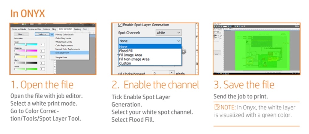

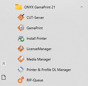

I've seen this tutorial online however I'm not sure where the job editor is. None of the programs I have from Onyx look like this. Here's what I have:

There's the GamaPrint Layout program but I don't see any options about layers or spot colors. I feel like I'm just missing something o_O

You open the RIP-queue and open the job there like any other job. Then you can right click that -> job editor.
There's many ways...

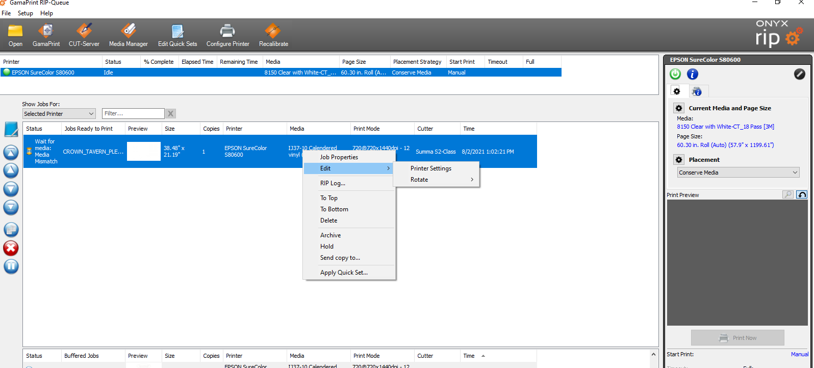

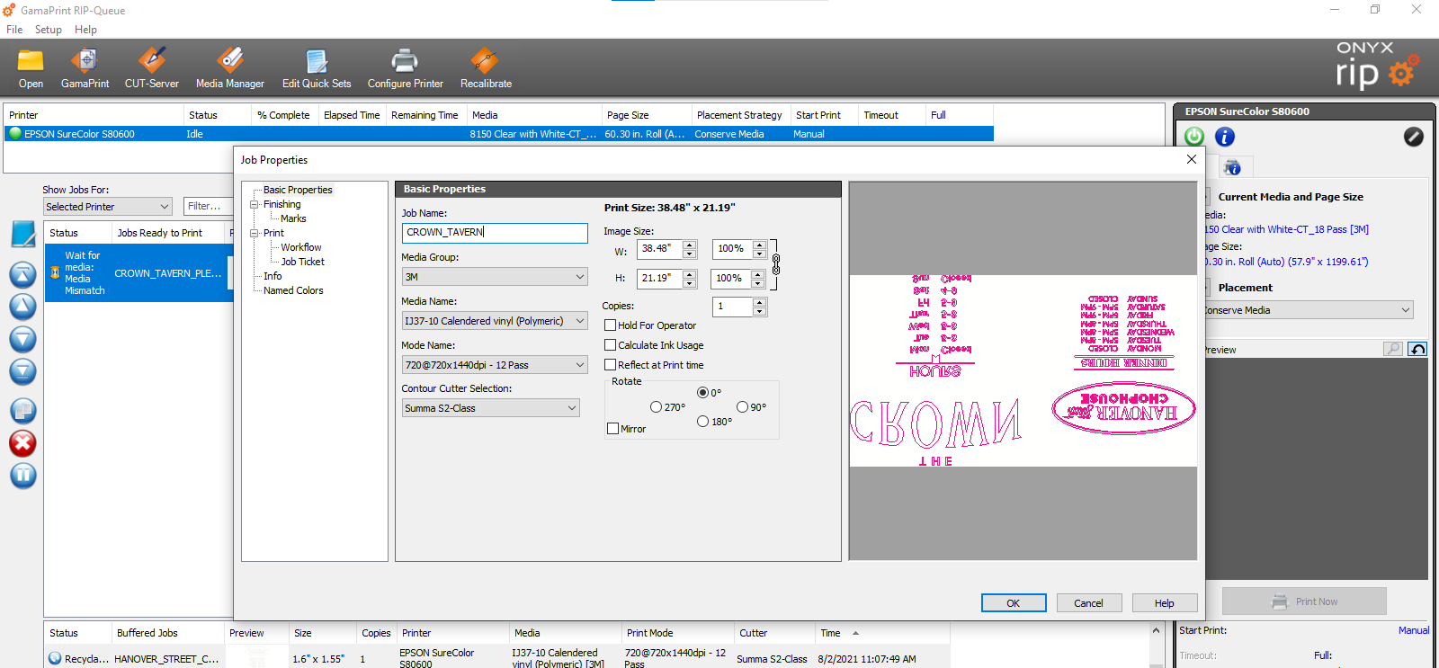

Here are the options I get when I right click a job. Ignore all the mixed up stuff in the background, I just took some screenshots as an example.

I'm wondering if the installer didn't select to install job editor or if gamaprint actually doesn't have it, I don't know. Someone else could confirm.
Yeeeah Im thinking your installer guy for whatever reason didn't want to install job editor... Which I just don't understand why he would do so...
You can relaunch the gamaprint installer and just click through it, select repair and you can select to install Job editor.
You won't lose anything and everything else will stay the same. It will just add the job editor for you.
