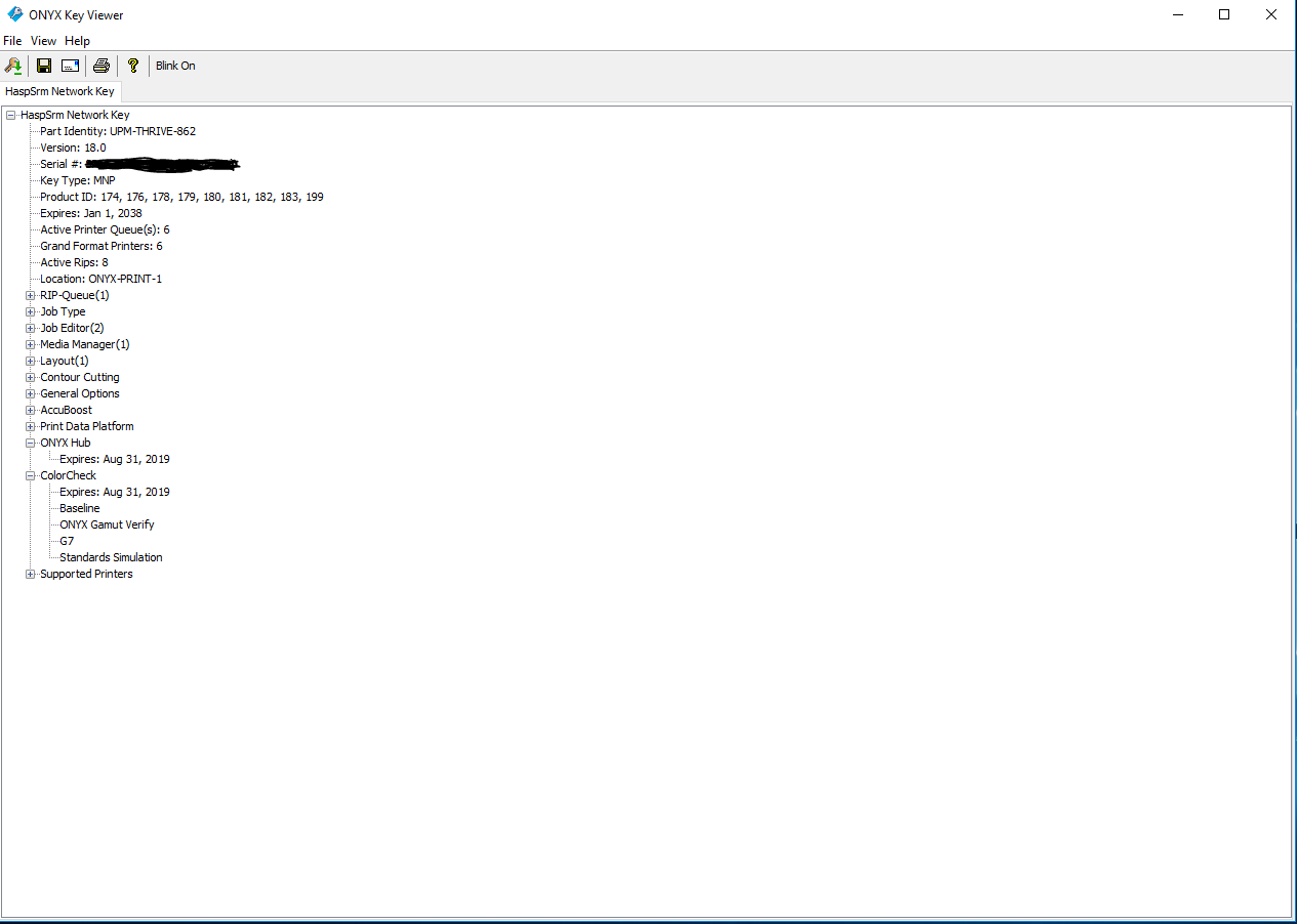

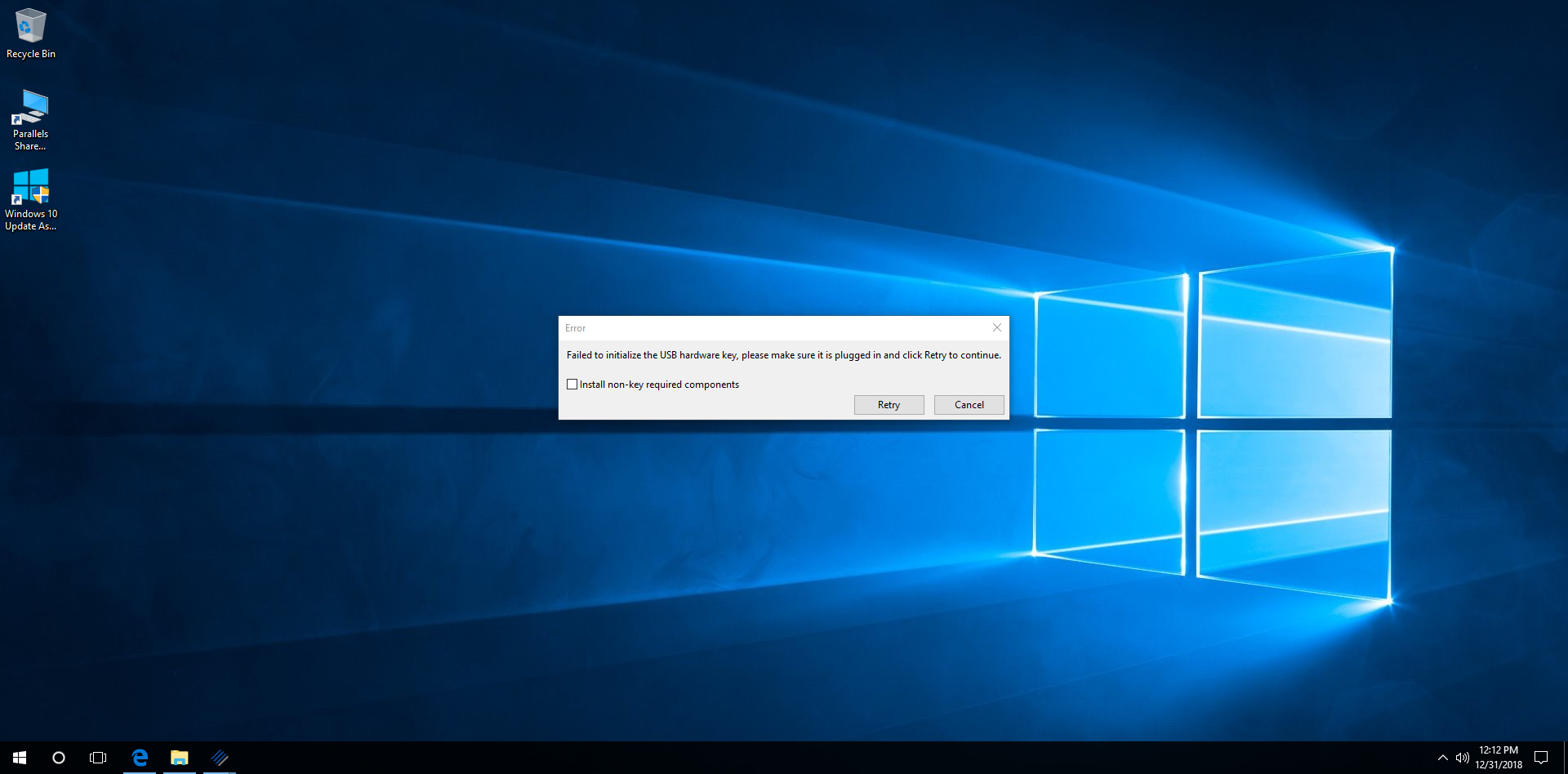

I have Onyx installed on a server in our server room and the USB license dongle is installed in that server. I'm trying to install onyx on a second work station in our print room, but during the install I get the message that the install software cannot find the dongle (see attached screenshot). I opted to install the "non key required components" which gave me access to the onyx key viewer application. Using that application I can see the license key (see the other attached screenshot), so how can I get the RIP software install to find that dongle?

Just wanted to provide an update for anyone who comes across this issue in the future. Turns out that Onyx's error messages are very vague and should be updated to be more specific. The problem was that I had downloaded V18.5 from the Onyx website but at the time my license was for V18 (I have a support gold contract so they updated my key today and the install went fine). So if you get an error that says you can't find the key, check to make sure the version you are installing matches your license on your key.
