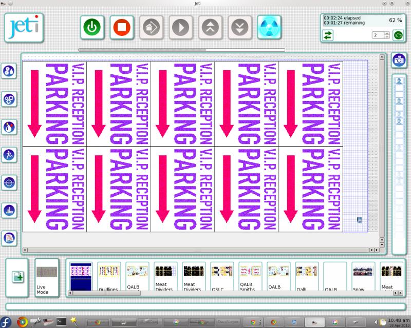

Do the CET machines not have a nesting program on the machine itself. I just send over one 18x24 to my AGFA 1224 HDC and then nest it at the printer. We also print on 18x24 blanks. I believe the CET machine is a true flatbed right? Can you not do it that way?
Letterbox Mike
No, you nest in Onyx and send it to the CET as one sheet. Same basic thing that your agfa does, just not at the machine, it's done on the RIP side. I'm trying to do exactly what your screenshot showed though, except it's putting white space between them when you add cut marks.
