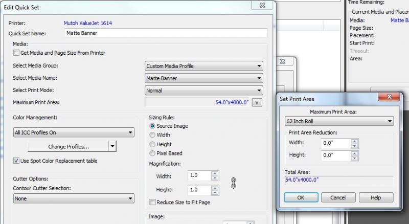

Check out the attached screenshot. Why the crap is onyx saying I can only print 54" on 62" media? Why the crap wont it let me change it? HOW do I change it? I'm very obviously missing something here.

Add a custom media/page size. File/Printer manager then highlight the printer and press configure. There will be a tab that says page sizes. The add button will be on the right side.

A little more info. If I take the print job that has been auto resized into Job Editor it will let me resize it and then it fixes the incorrect maximum width. But thats on a per job basis. Not ideal.
