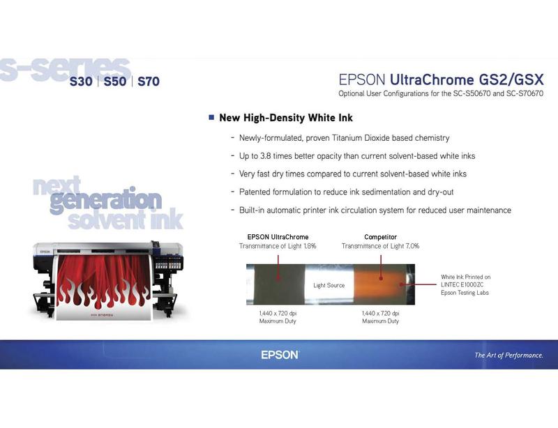

With the Epson SC S50670 series that uses the new GS2 inks, the white ink is supposed to be a high density white ink and have a light transmittance of %1.8... at least that's what the brochure shows (attached)...
This is where I'm thinking I should be able to print a block out layer that should work. If I'm totally interpreting this incorrectly please let me know as I keep trying different settings/ ways to do this. I have tried talking to Epson before and got nowhere trying to do this.
This is where I'm thinking I should be able to print a block out layer that should work. If I'm totally interpreting this incorrectly please let me know as I keep trying different settings/ ways to do this. I have tried talking to Epson before and got nowhere trying to do this. Try the Onyx tech support, they've been helpful with other issues.

Can't believe the brochure / flyer 100%. I haven't been able to get a super dense white either. I'm interested to see if you find a solution. Good luck.

So i think i may have figured it out, it just requires a ton of layers and 4 print files..
First: print in reverse then add 3 layers of white print (using the multilayer function)
Second: print flood white layer
Third: print a 0/0/0/80 layer
Fourth: print flood white layer
Fifth: print 3 layers of white then the image
You'll have to play around with the settings / dry times inbetween each layer and make sure you align each print file accordingly so that it prints exactly ontop of the previous.
