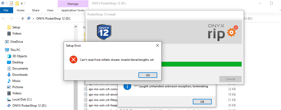

Due to bad luck, I formatted the computer and the onyx postershop 12.1 program for the printer was deleted. I have the flash drive and dongle for the program, but the installation shows errors. I searched all over the internet and did not find a copy. Please help me. I will lose my job because of this. My printer is HP Latex 365.

I'd see if you can copy the install files from the flash drive to a folder on your Desktop (e.g. OnyxInstall), and then run the installer from there and see if you get a different result. Also, right-click on the installer and Run as administrator. If you need more help, post here or PM me.
on the right track, but, make a directoyr in the root of c: (file explorer, this pc, c: make new folder > copy everything from flash drive into the folder
with windows 10 & 11 you sometimes don't have all the rights for a folder in a user profile.
