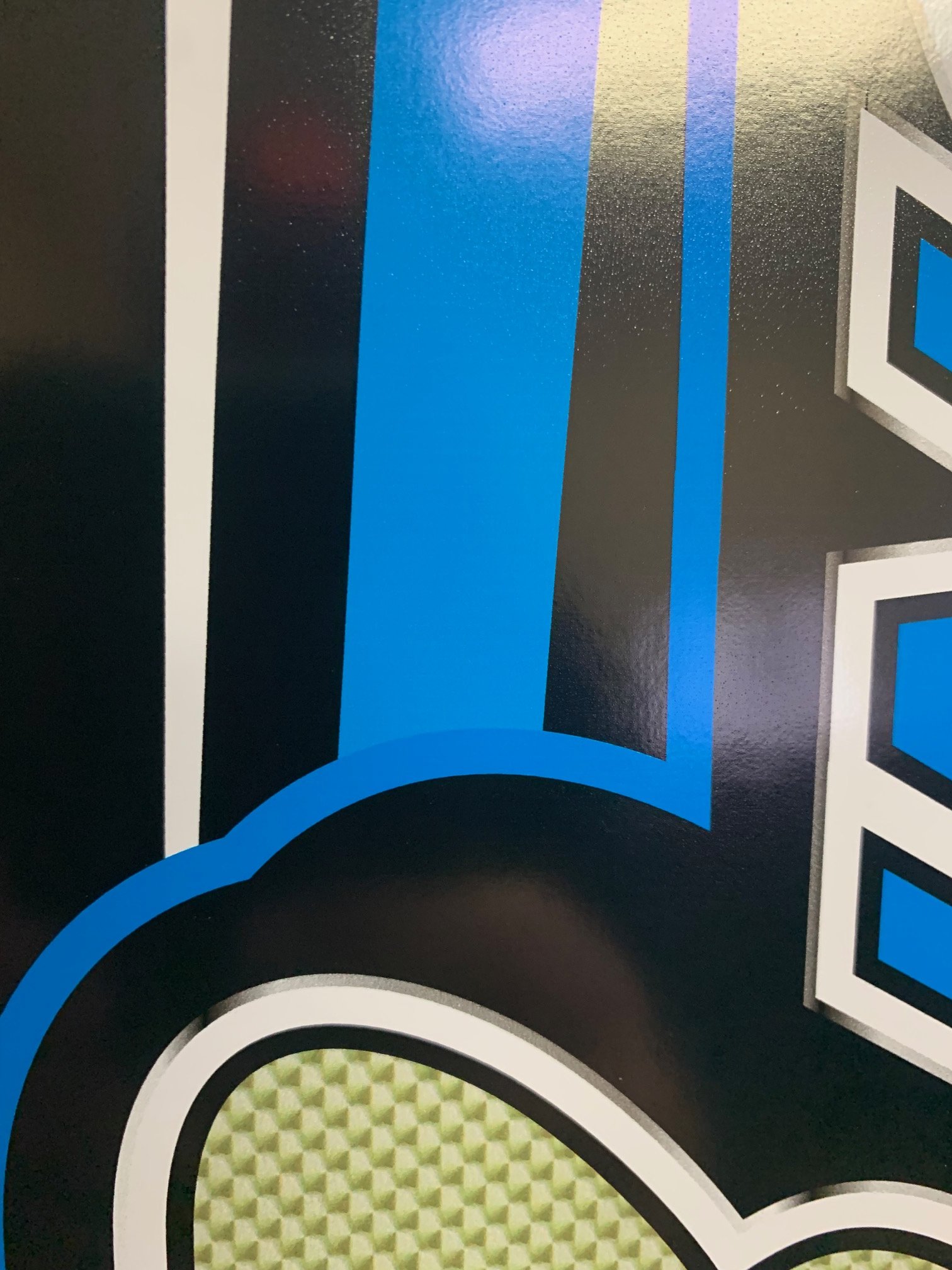

Hey can anybody help me figure out why its doing this cyan color difference? Both blues where exported thru coreldraw as 100% cyan...both are vectors not bitmaps in the image at all... they look identical in job editor and in rip-que...but when i print they are different...Its not a big difference, but it looks like one is about 10 percent darker. any ideas? image below... Thank You

Do you have any effects going on this file? Maybe that one part of the design got caught up in the effect and was rasterized along with it unintentionally?

only effect i got in the file is gradients and i got an engine turn in the file... but the actual cyan is a vector...both cyan shapes are vectors

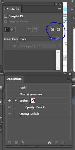

jfiscus
Rap Master
I've never seen this be an issue before now in my career, but it is an option I never even knew was there...
I saw that there was an appearance/attributes difference by selecting both paths at the same time.
In the attributes panel, one of the fills is set as "use non-zero winding fill rule" where the other is set at "use even odd fill rule".
I'm not sure why Onyx recognizes and fills them as slightly different colors though, but people in the links below are experiencing somewhat similar issues with the same feature.

jason91
But I’m working outta coreldraw not illustrator
