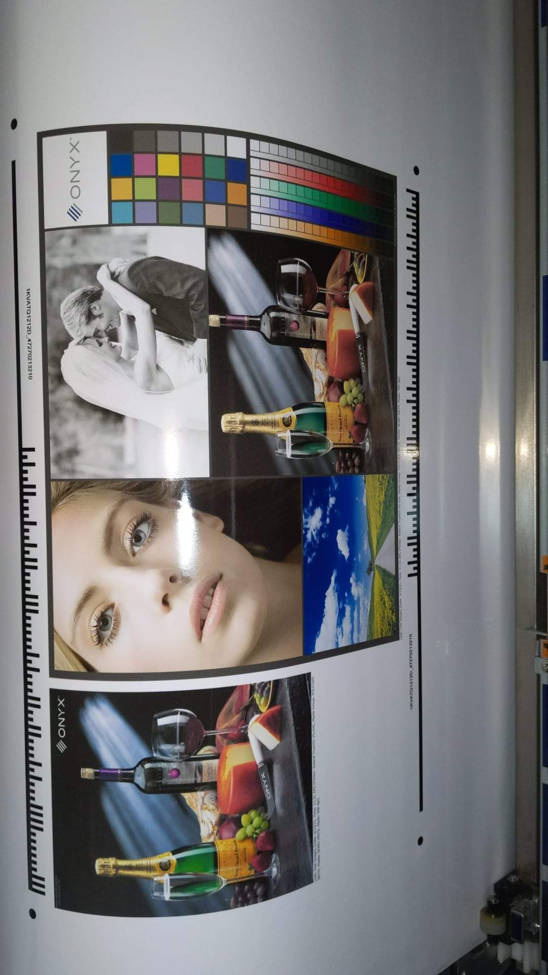

Struggling to create a profile for Roland Truevis using Onyx Thrive 18 RIP using X-rite i1 pro 2
Completed the whole steps and clicked build ICC profile but when I have added a print into the queue colours are coming out a bit washed out.
Before I have used Avery profiles and blacks e.g. are nice and solid although some others colours have been printing a bit darker especially around navy blue but its always been nice and crisp prints.
Quick photo of a test print attached.
Is there anything I am missing after clicking on build ICC profile at the last step ? Is there anything else where I have to apply these build ICC profiles perhaps ?

Just to be sure. You did the ink restrictions, linearisation, ink limits? Before the icc profile?
mariusz
Hi.
Yes, I have completed all the steps as in order in onyx and specially blacks look very low like faded ink looking as per the photo instead of what I would expect being rich black with even coverage.
