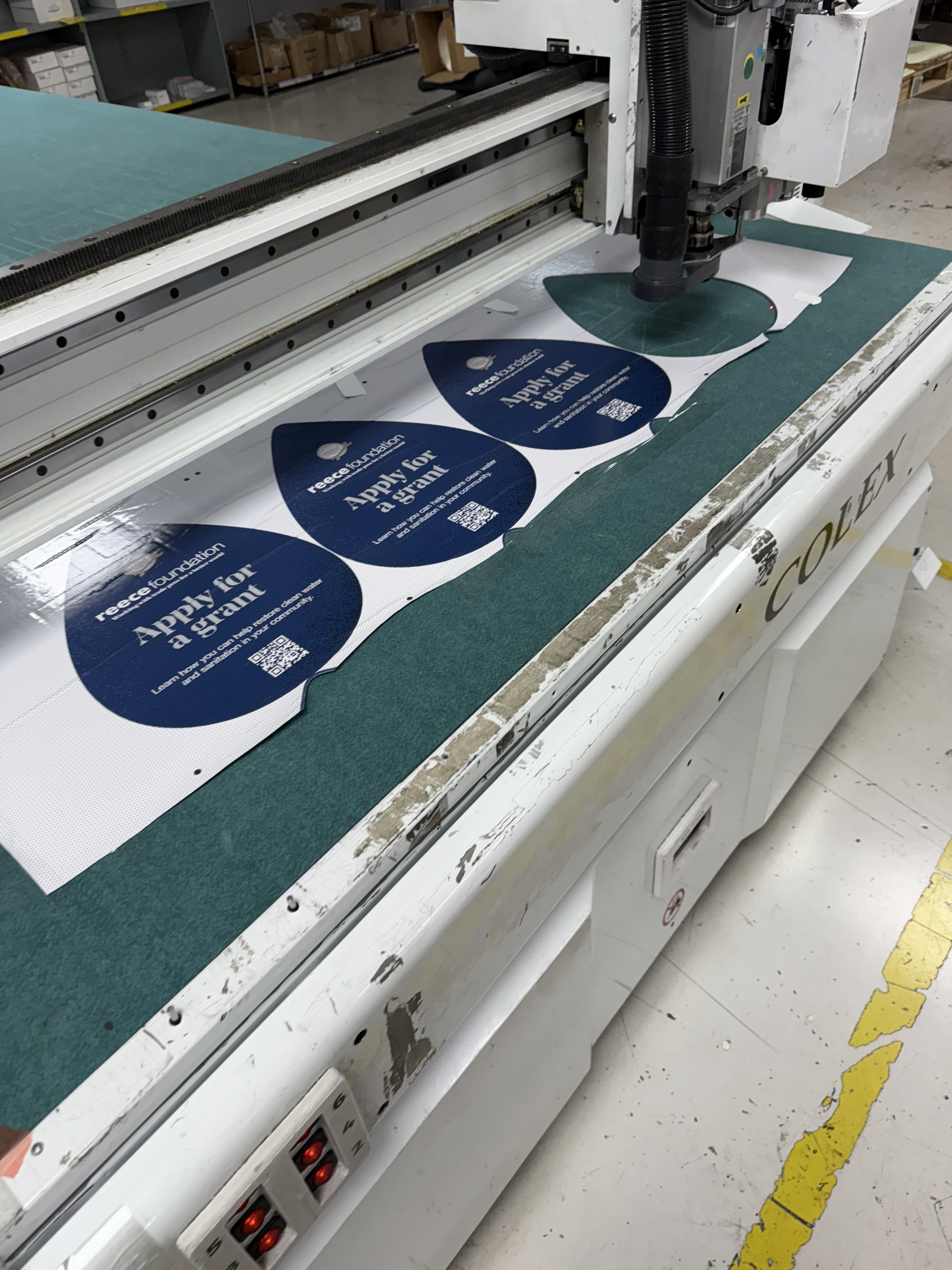

We are attempting to stream line our workflow and use Thrive to generate the cut file for our Colex. It does, but it adds a ton of extra marks we don't need. We only want to have 3-4 per board. Does anyone know if there is a way to change how many marks Thrive adds to the board? Is there a config file we can hack?

You can change the spacing for the reg. marks placing or you can set the Optiscout to read less marks.
