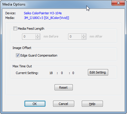

Try unclicking the edge guard compensation.
In media manager/specific profile/media options.
