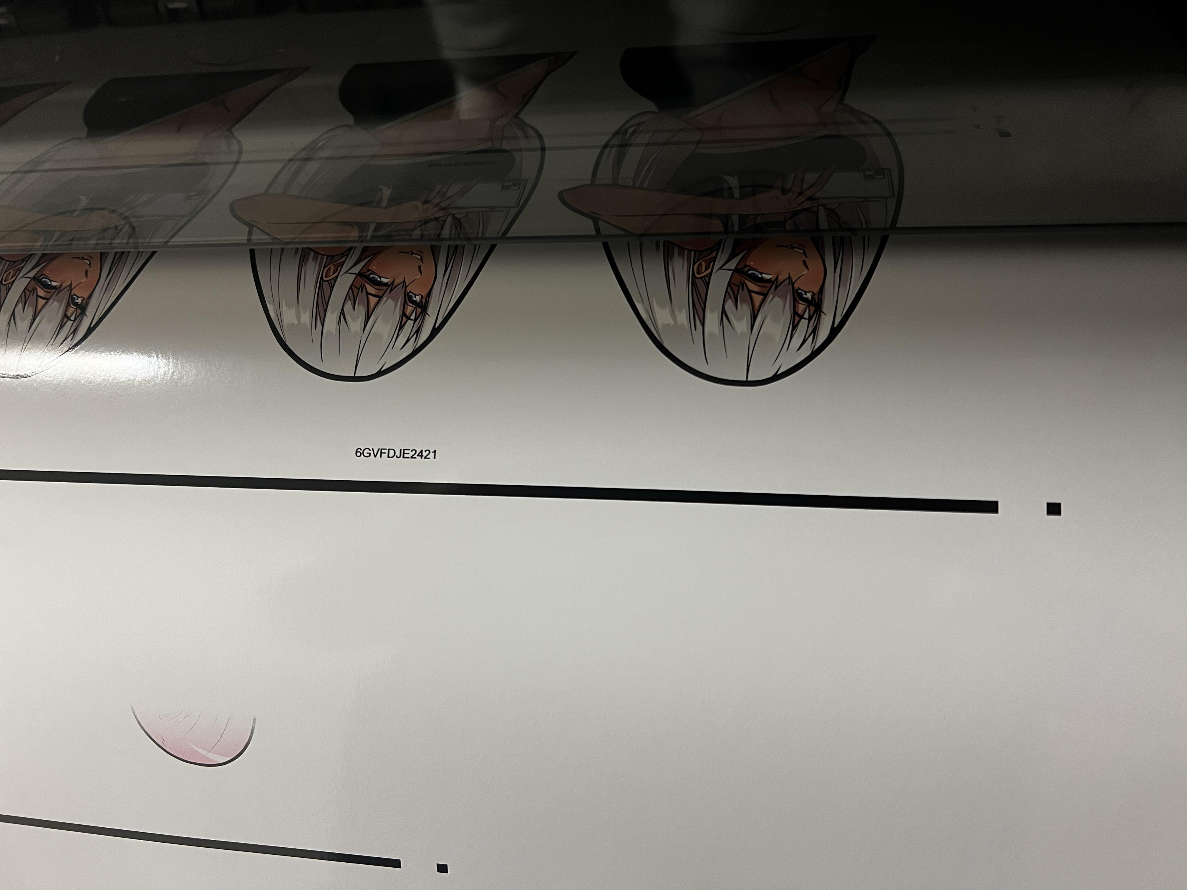

I followed the directions step by step, but for some reason, it is printing without the Barcode. I have never had this problem before, yet I have been working on ONYX 19 for the past 3 years, so upgrading and trying Thrive, there is a some new things that I am not aware of that I may be missing.
The Trial is 22.5.1, and my Summa software and firmware is up to date, I cant figure out why the barcode isn't printing.
I am also trying to get the OPOS XY2 workflow to operate and read the back bar, but I didn't see it do it. *This is me manually loading the cut file, without the barcode, It may change once I fix the barcode issue* If anyone has instructions to getting OPOX XY2 to operate as intended that would be awesome also!

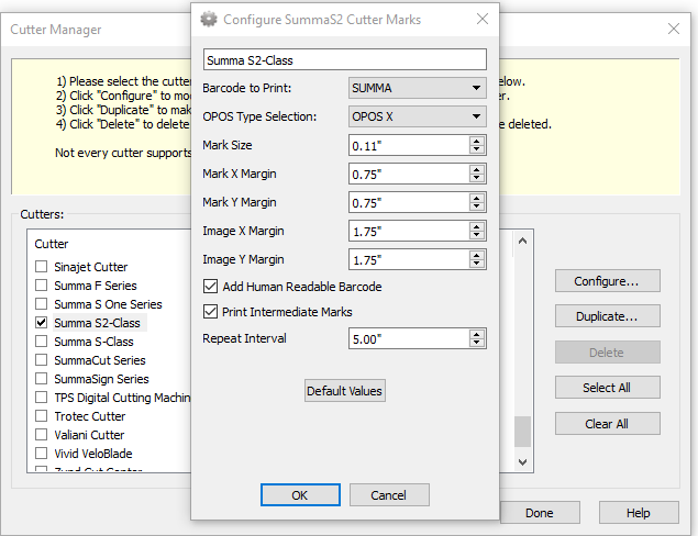

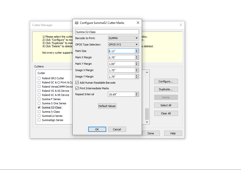

It looks like I was able to get a barcode to print via Summa, and OPOS X option, but I dont understand why it wont print through the OPOS option, the directions are specifically for "Summa S2TC OPOS CAM Cutters"

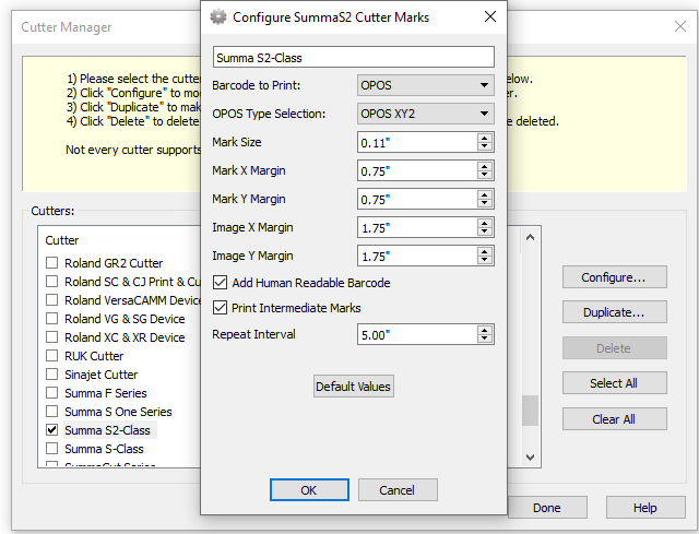

try the OPOS XY2 setting, you image shows OPOS X, I just checked mine and I use the OPOS XY2 and the barcode shows up. Let me know if you need more help
Graphic Extremes
Knows To Little

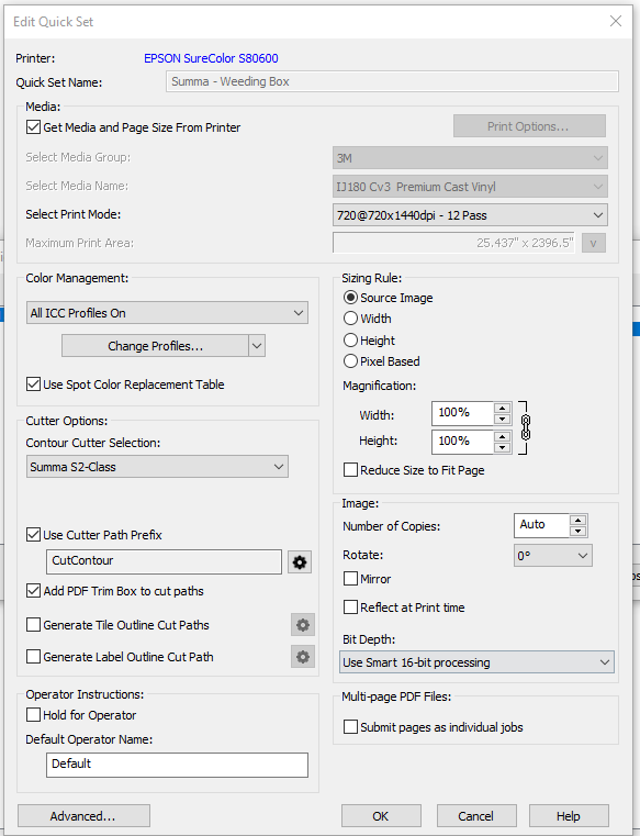

you also have to select your cutter in the job editor, hit apply and the print and then submit

Guys it's also different based on Onyx versions. Onyx likes to keep changing things and on the video they only showed two versions from over a year ago..
