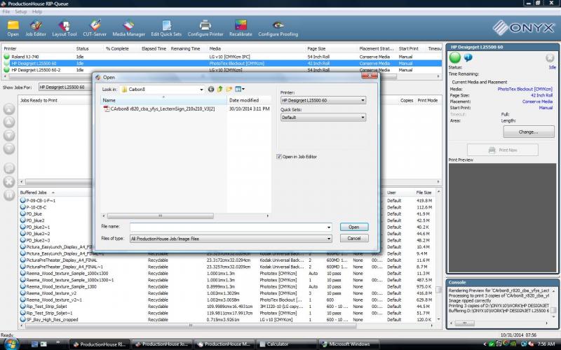

Bly
Do you have "Open in Job Editor" selected or not?
No, job open dialog is not checked "Open in Preflight".
However, it does just automatically rip on its own,
without me seeing the preflight screen. It just goes direct to RIP.

ok. Try opening a file with that checked and watch what happens.
DougWestwood
Agree. Open in job editor/ preflight should be checked on the open dialog
Thanks, yeah, I see it opens right up when opening, with check box checked.
