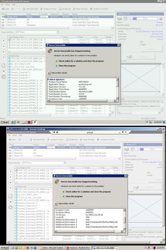

I have loaded Onyx Ver 7.3.2.16 on a Windows 7 platform (64-bit) PC.
We have 4 x mimaki printers
1) JV33 - 160 with a usb connection
2) JV5 – 160 with a usb connection
3) JV4 – 160 with a firewire connection
4) JV4 – 160 with a firewire connection
As we load the job either by EPS. or directly thru Coreldraw X5 via virtual printer, the Mimaki(JV33 & JV4) starts to print 15% of the job then Onyx crashes (server executable has stopped working) as per attached file
I have no ideas on why Onyx would crash. Any ideas?

I believe that x10 is the version supported for Windows 7... and I dont think they like 64 bit even then.
I did the same thing this week... installed 7.3.2 on my WIn7-64 machine. It bombs too. My key is no good for x10 so I have to upgrade or keep an happy XP machine. I am just going to build a backup XP machine just to keep on the shelf as a RIP backup. When we get enough folding jack then maybe we will upgrade to x10. Not anytime soon though!

Had the same issue with 7.3 running on 64 bit. It would be stable for a while, but then would start crashing, till you just couldn't get the rip to open up again. If I reinstalled I could use it again for a day or two, but the crashing would happen again.
Upgraded to x10, I have had it installed maybe two months now, no crashing whatsoever. Happy so far.

I had problems with production house 7.3 crashing, but that was when I started it up and or would not find printers, so now I have to right click on the mouse and run it in administrator mode and haven't had any problems sense. my you can do the same...
hope this might help
jens
we stopped working with onyx rip. to many server.exe errors. make shure you got the latest drivers of the mimaki. and the drivers of your firewire ports. connect only 1 firewire printer and see if you still got the error
