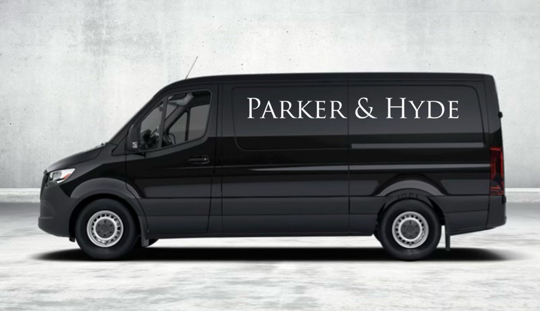

I’m new to the vehicle signage world. I have a client that wants his logo applied to his company van. He wants to trade the van in in about 18 months and wants to know if the vinyl will be removable without causing a lot of damage. I plan to use Oracal 751 in gloss white, black van in Texas. Looking for any experience you have had, should I use a different vinyl? Is black paint likely to fade in that timeframe (new van)?

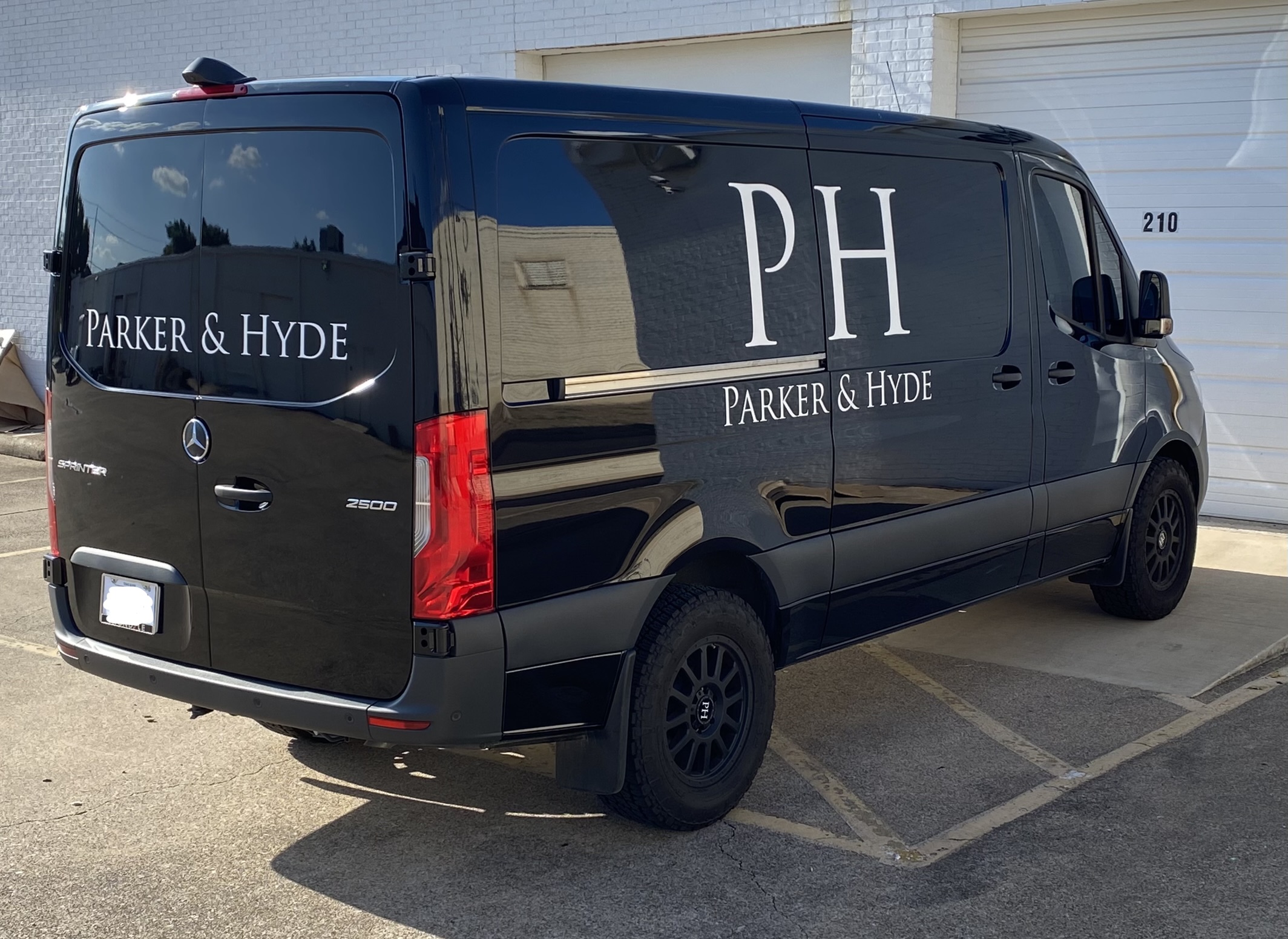

I went with the 751 as I had already purchased it for the job. But I will look into the 3M you mentioned. Client wanted a quote for removal and I said $70hr, $100 minimum and that a buff out by a detailer may be required that I wouldn’t be liable for, will see if I regret that . Install went well tho.
Nice job. Sharp van
