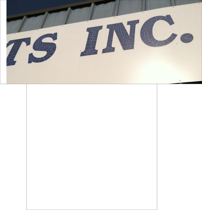

I used some Oracal "Brilliant Blue"#751 series on some signs a couple years ago and within 18 months the vinyl was cracking all over like mud in a dried up pond and the blue pigment was streaking down the sign. An OC rep told me that this particular color was only rated for 3 years, or maybe he said 2. That was not shown in the 'fine print' on my color chart but he then sent us a new one on which it was. One was a $2000+ job and the other was $300+ but all Oracal would do was to refund the cost of the vinyl. My question: if something only lasts 2 years, why put it with your "hp" line?
My other question;
Has anyone had trouble with Oracal 981 metallic chipping off around the edges of letters, after only being installed about 4 months?
Could that be from pressure washing?
Thanks

Here is a direct quote from an Oracal rep's email dated 2015-06-03 17:41 : "...751 color brilliant blue has a 3 year durability rating vs. the 7 years of other 751 colors." So, you can see, they lowered the rating there.
The old swatch book had sad nothing about a discrepancy with Brilliant Blue but the newer one this guy sent said three(3) years. Evidently, instead of pulling the stuff from the 751 line, they just kept decreasing the rating in the fine print "exceptions" section. But who looks at that? No, you call your supplier and order a roll of color xxxxx from the swatch book and think nothing of it because the ''exception'' isn't beside the swatch numbers and you're ordering "high performance" cast vinyl for your customer so their sign will last a reasonable length of time.. But like I said there was no exception for this color in my old OC book anyway.
